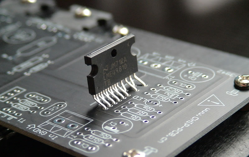

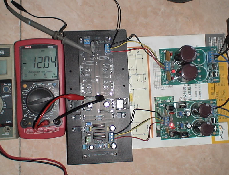

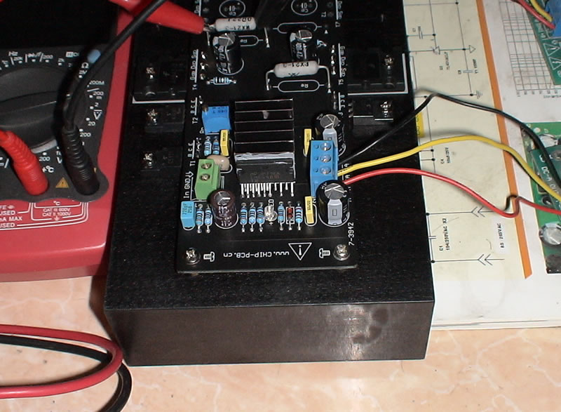

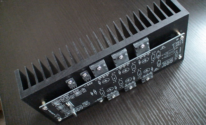

LME49810 Test
No.3
Passed the test and the actual hearing, the overall performance has improved over the LM4702. This benefit from the Slew Rate and mono design.
Testing the use of 2SC5200/2SA1930 (Fairchild Ver.), Hearing on the flu fluent, dynamic.
The overall impression that the LME49810 is a good chip.

Hello Monkey29,
My LME49810 samples will be delayed, so I can't do my tests.
What is sounding difference betwen LME49810 and LM4702?
Thanks.

Re.
The LME49810 and My M-4702-F module, all have a good sense of hearing. Sound of performance , LME49810 slightly better, more details.
I think the voices of the description is more difficult. After listening to more, there will be further awareness.
Triodas said:Hello Monkey29,
Thanks.
