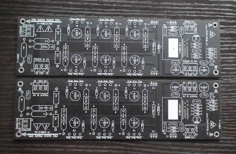

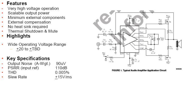

This is the schematic of my design under development. The output BJT is OnSemi ThermalTrak, NJL3281D and NJL1302D. The feedback network and protection circuit is a copy of that of the Leach Amp.
I will use prototyping board to try the design before going to fab the PCB.
Will the protection work? The datasheet doesn't say the LME49810 is current limited. Do you know if it is?

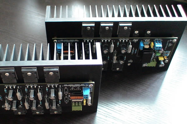

Hi monkey29,
what a chance. I wrote you today an email to your office, in the hope that they will understand english because the homepage i found was all in chinese ... and now i find you here ... Please contact. I am interested in a pair of LME49810 Amps. Are they finshed allready with heatsink or do i need to solder ?
Wich Power Supply does this set need ?
Thanks in advance for your efforts
Michael

megajocke said:Will the protection work? The datasheet doesn't say the LME49810 is current limited. Do you know if it is?
The protection is for the output stage.
Hi,panson_hk said:.........The feedback network and protection circuit is a copy of that of the Leach Amp........
the Leach protection has omitted a resistor to rail.
The Leach protection locus has a constant current characteristic when Vce>~Vrail, i.e.single slope. This allows overload of the output transistors into reactive loads.
Go look at the Leach clone thread for the location of the extra resistor for true two slope protection.
Better still ask Mikeks for a copy of his paper on protection schemes and how to calculate the component values. He also shows a better method of allowing transient signals through without triggering the protection.
You are missing the point. If the output stage protection activates it works by shunting away drive current from the VAS in the case of the Leach or the chip in this amplifier. The VAS in the Leach is current limited so it won't blow up when the output stage protection activates and shorts its output to ground. So I ask again, is the chip current limited?
megajocke said:You are missing the point. If the output stage protection activates it works by shunting away drive current from the VAS in the case of the Leach or the chip in this amplifier. The VAS in the Leach is current limited so it won't blow up when the output stage protection activates and shorts its output to ground.
Yes, LME49810 spec is 50mA output current capability, which is much more than typical VAS's.
Thanks for pointing this potential problem. My current idea is put the chip in mute mode and move D4/D3 after R6/R7 (base of Q1/Q2).
Does anyone know if it is current limited or not? It kind of sucks if it isn't, really. If it is current limited at 50mA, it wouldn't matter much that this current is higher than what a typical VAS can source/sink. The internal diagram does not show any current limiting, but it is a simplified diagram and these often omit stuff like current limiting. So it might still have it.
megajocke said:Does anyone know if it is current limited or not? It kind of sucks if it isn't, really. If it is current limited at 50mA, it wouldn't matter much that this current is higher than what a typical VAS can source/sink. The internal diagram does not show any current limiting, but it is a simplified diagram and these often omit stuff like current limiting. So it might still have it.
No it is not current limited. At least according to the design engineer I called to ask.
