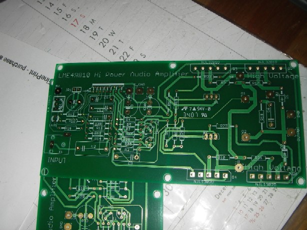

The PCB of my schematic posted earlier in this thread (protection ckt removed). Onsemi's ThermalTrak power BJT is used for the output transistor pairs.
