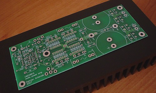

veteran said:My boards for this amplifier are finally ready 😉

I have to say that LM4702 from now is dead for me - LME49810 is amazing chip!
No oscillations and noises on my PCB even without additional capacitors on input and feedback. Clear sound. Hi output power and available bias voltage.
I'm driving standard MOSFET pair now but with 2SK1530/2SJ200 should be even better 😀

veteran said:I have to say that LM4702 from now is dead for me - LME49810 is amazing chip!

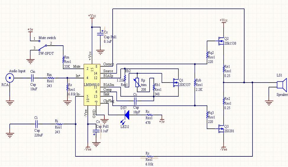

Dear Veteran, T1 should be instaled on the big heatsink where power transistors are placed. You know T1 intention? I'm sure yes.

Lazy Cat, MOSFET transistors if you ensure them wright conditions (bias voltage and some big heatsink) don't need the bias transistor on the same heatsink - for example Mr. Pass amplifier 😉

Hi,veteran said:.......MOSFET transistors if you ensure them wright conditions (bias voltage and some big heatsink) don't need the bias transistor on the same heatsink - for example Mr. Pass amplifier 😉
Lateral FETs can be used without temperature compensation on the gate bias voltage. Vertical FETs should always use temperature compensation. k1530/j200 are a version of a vertical FET and should have Tcomp.
