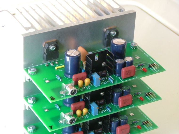

I recently built an 8 Channel Amp. Each module puts out about 65 Watts at 8 Ohms using a +/- 45 PS. The ops uses Lateral MOSFETS. These new chip amps are super quiet! High PSRR. Absolutely no HUM, HISS or motorboating. These are some great chips. There's not a whole lot of kits out there now, so I prototyped my own with some success I think.
I plan to use this multi amp to drive the LinkwitzLab Open Baffle Speakers which require all the same amp specifications.
Notice the attached file showing the bias pot. Only 30 ma of current through the MOSFETS with the heatsink/no fan.
Would like 100 ma.

You are correct on the Renasis FETS. No formal testing on the completed system yet. My inventory of test equipment is an O-scope and an HP Signal Gen. I cannot see any so called crossover distortion on the scope-but really need a distortion analyzer.
Sounds great and very pleased. I'm using back-to-back 22uF tantium caps as input filtering, which provides a very low end Responce. I had to adjust my DC protection sensitivity a little. Each module uses three RF Mica caps in the circuit topolgy. I basically followed National's design guide with a little change in gain.
Good repor with "ExpressPCB" who developed the Boards for me. I have pictures of the insides of the chassis if you are interested. Eight modules required a huge Power supply an interesting resistor bias and fuse arangement. I also built the AmpsLab LM60 before I built these. I think my modules sound better because of the higher slew rate and no background noise.
Thanks for the feedback
Mark

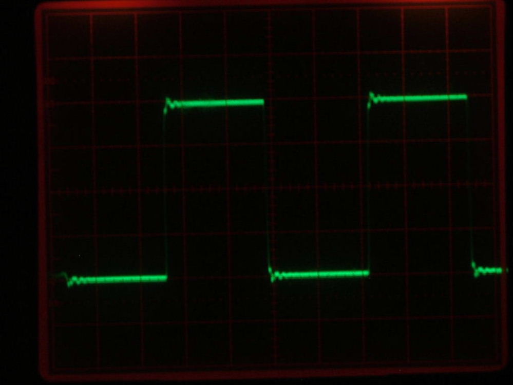

Thought I'd show you guys a picture of a sqaure wave at 20 KHz 20 Volts Peak to Peak of one of the amp modules. (LME 49810 directly driving a pair of 1058/162. (My old Tektronix taken with a Fuji FinePIX ... not the best).
Guess I'm a little exicted about the results. 😀
Mark
