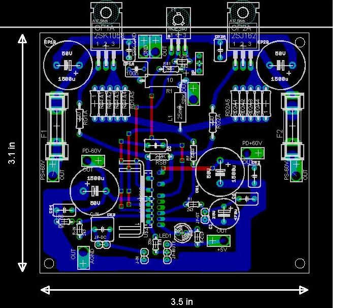

2 jumpers above one copper track.
Make it one jumper and two tracks.
Jumpers should be outside the component boundary.
U need to read about the value of the capacitor in other thread
Closer the capacitor to the outputs, the better it is.
The output FETs need to be fitted to a big heatsink. Think how u will fix it and correct as needed.

My version of the amp board
Hi folks!
Here is my first version of the amp board. It is assumed to be placed to the motherboard where is all the powering (high & opamp), signal connectors, power connector, output connector. And may be, mute and clip led connection.
In the front there is 4th order filters to be used for active filtering, if required.
Output Fets are open, fill free to chose proper ones. "big" el-caps are low esr-type.
There are still wrong cases in the feedback, input and output snubber. i am searching compos to update PWB.
Jpg's coming later for guys not owing free Eagle.
