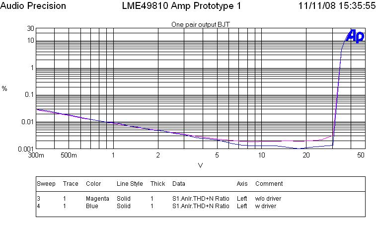

I did some load test to LME49810 and posted the results in this thread.
Below is the THD for my amp with and without driver. One pair of NJL3281/1302D were used. Their typ current gain is 75. You can see the THD is about doubled for no driver.

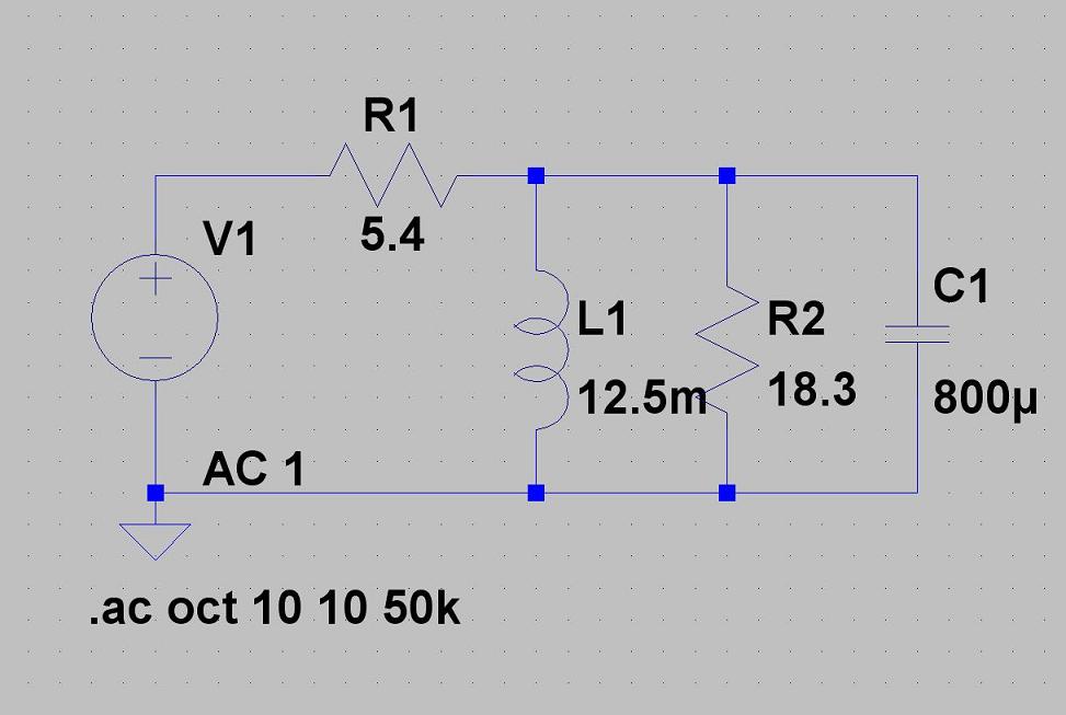

If one is asking an amplifier to drive a real speaker then the peak transient current can be very much higher than what a resistive load will draw.
The suggestion for worst case impedance/reactance (but not including electrostatics) is Ipk<=Vpk / RLoad / 0.35.
for 100W into 8ohm this gives a worst case peak current of ~14Apk.
change the load to 4ohm (200W into 4r0) and this transient peak can rise to 28Apk.
The chip needs a driver and an output device and the output devices will probably need to be doubled for that 14Apk to avoid the gain droop inherent in all BJTs.
For the 4ohm loading the outputs will need to be at least tripled.

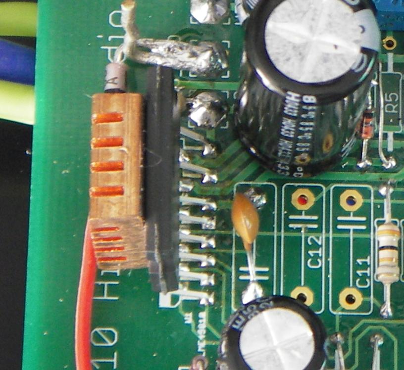

Hi, have anyone any suggestions for heatsink to be used with the LME498xx series? The Aavid suggested by National seems to be very hard to get.
Re: Heatsink for LME49810/49830
I did not make any math. But my experience ...
I just use a RAM heat sink for my LME49810 amp with +/- 55 V. In 28C room temp, open frame, the chip+heat sink just gets warm during test.
Segran said:Hi, have anyone any suggestions for heatsink to be used with the LME498xx series? The Aavid suggested by National seems to be very hard to get.
AndrewT said:If one is asking an amplifier to drive a real speaker then the peak transient current can be very much higher than what a resistive load will draw.
Hi Andrew,
Is 0.35 a rule of thrumb? Do you know any load simulator (RLC network) for speaker used widely in the field? I found one from Ben Duncan's book.
yes, it's a near worst case estimate that is quoted by a very few authors on this Forum.
Most seem to agree that peak transient current into a crossover is worse than the Re value would indicate.
Many use a factor of 2 increase, a few use 2.5 times.
The 3 times appears to only happen on fast starting or fast stopping signal when the various reactances and VC back emf source or sink current.
Because this worst case can only happen as a transient it does little to stress the SOAR of the output stages due the tiny heating effect and the tolerance of SS to very fast signals.
Where it becomes crucial is when gain droop in the output devices causes the base current to rise and that in turn sources extra current from the drivers and then these too enter the gain droop region and source extra current from the VAS and, if fitted, the pre-driver.
It's precisely this peak current ability that chipamps cannot match and worse so as the load impedance drops.
The 49810 needs a high gain, wide low droop current range driver before the output device.
ESP and a few others publish speaker equivalent circuits. Try joining a pair through a real crossover and then simulate using sinewaves and compare to slow rising square waves. D. Self did a chapter on Output Stages where this simulation and worse is discussed in detail.
