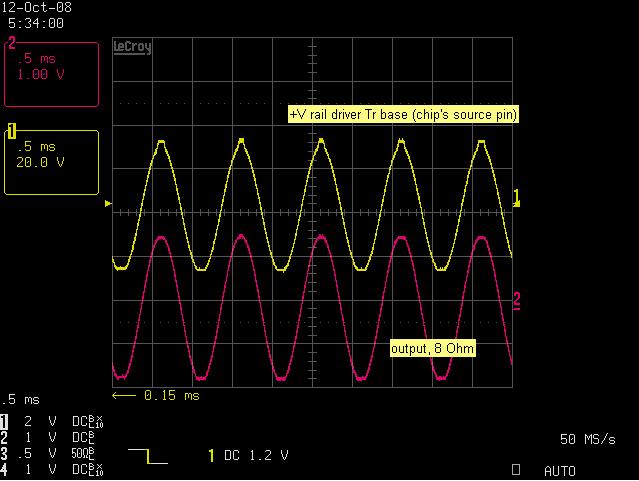

I am guessing the driver+output stage overload the chip. The source pin of the chip and output are measured and shown below. You can see the chip clips as well. I will change the driver to increase its current gain. Any advice?
Hi Panson,
explain the readings on the scope traces.
It looks to me that the input is 3Vpp (=~1Vac) and that the output is 60Vpp (=~21Vac).
Please confirm the scope settings and readings and also measure the input and output voltages with voltmeter set to Volts AC.
What is the gain setting of the amplifier?

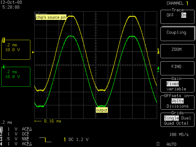

Hi Andrew,
You have good eyes!
CH2 1V/scale was connected to a monitor output of AP. The level did not reflect the true value. I focued on the wave shape.
Let me show you a new scope capture where both channels connect to the circuit directly. It appears to me that the clip originates from the chip. It might be overloaded.

+29dB=28.2times
But your input to output looks more like 20times.
Reduce the input slightly and measure your input output voltages and scope readings.
Hi lineup,
You make a right point here. I check the circuit again and confirm that the clip does not due to insufficient current from the chip.
BD139/140 and 3281/1302 (Re=0.33R) are configured in EF. Dropout of this output configuration is about 5 V at clipping. The employed supply drops to +/- 32V during clipping. Yeah, we need to include margin!

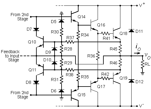

http://users.ece.gatech.edu/~mleach/lowtim/
I do not know how big value resistors NJL3281D/1302D should have to keep stable.
Leach uses 10 Ohm for R41, R42 in his The Leach Amp.
You should keep base resistors. Do not think 10 or 22 Ohm will make any difference.
Important is the distance from those resistors to the Transistor base pin should be short.
Professor Leach also uses R36=220 Ohm between the Driver Emitters. BD139 BD140 for you.
This is usual in output stages.

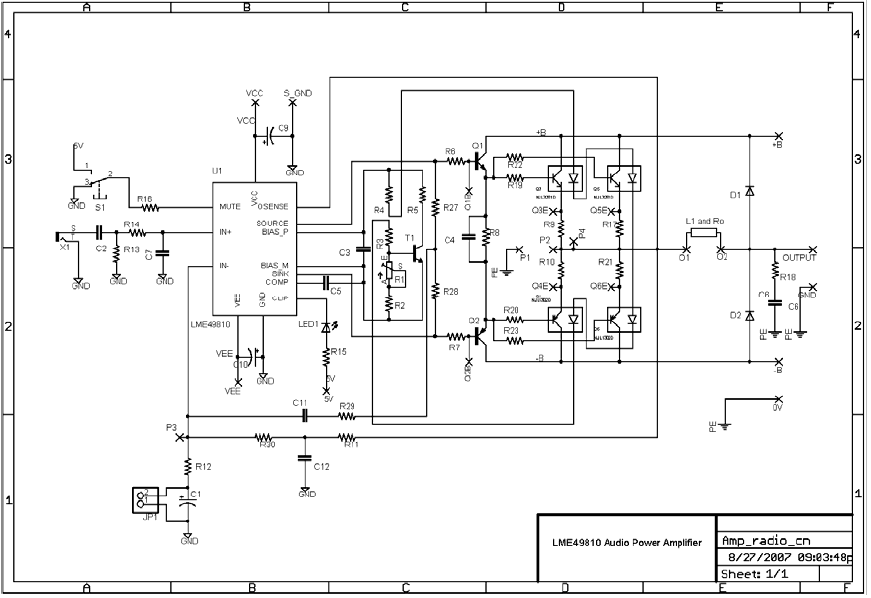

Hi..
What about this one?
I have readily available some LME49811 free samples and SAP15s.. Then this looks a good idea to make..
The BIAS input is for DC servo and TP1, TP2, TP3 are for the protection circuit which is also available in my drawer (the original new Crescendo amplifiers protection card)..
Its simple and will sounds good I think..
Do you have any comments or advices?

lineup said:The circuit is this one. But parts values are missing:
I am using the values shown below for the above tests.
Sure..
This is the circuit;
Its not my design. Originally the Elektor's famous Crescendo Millennium amplifiers Protection & DC servo card..
I am using SAP as output device and they have exactly the same SOA curve as 2SK1530-2SJ201 which is the Crescendo's output devices. And the same emitter resistors that 0R22.. So I say why dont I use that circuit while available in my drawer..
