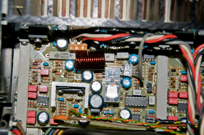

This is from TAIWAN Diyer, hard-wired style....
I don't think you need to do anything to R14, it's probably OK.
Pretty strange that the output power decreased though. I'd add drivers, performace won't be very good without.
I'd attach them to the heatsink and bend the output transistor base lead out of its hole and connect the driver stage with wires.
Look att coffin's amp, the whole amp is built that way! 😎

I guess I could fit drivers if I really wanted to, but it would be air-to-air wiring, much like coffin's amp. But I'm satisfied for the time being at least. The tranny in the Marantz isn't going to cope with more power anyway.
Just to show you that the project actually exist and that I really was short of space when designing the PCB's - here's a snap shot of both channels fitted in the Marantz receiver.
Thanks again megajocke for you interest and help, I'll be contacting you about the drivers for the next project - this time I wont take short cuts, I want the best performance possible.
Sorry, I made a fool of myself -again.. The scope was set to "Uncalibrated". When re-doing the measurement I got 70 Vp-p across a 7R resistive load and 80 V p-p across my 8 ohm speakers (sine wave 1kHz). That's 10 A p-p, 800 W p-p! Not bad for TIP35/36 without drivers...
The measurement was made just at the virge of distortion setting in (yruned out to be the negative oart of the sine wave, indicating that the PNP has lower gain than the NPN - true, they measured 104 v.s 128 in gain.
And yes, the sound is noticeably improved after the changes megajocke suggested. Your where spot on - I'm impressed!
