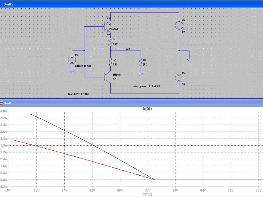

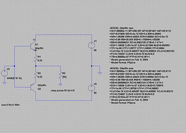

Why don't you run some simulations to see whether your design is safe or not? LTspice is a very good simulator!
I would, if I could. Can't find models for those transistors, and I'm not familiar with Spice modelling.
I have tried but gave up.
Segran said:I would, if I could. Can't find models for those transistors, and ...
For SOA, you don't need to have the modules. Just like the example I quote you just need to see the curve (Ic vs Vce) of your circuit. I used small signal transistors to get the data. The simulation circuit won't blow up.
Sorry, I ment 2SA1943/2SC5200! Toshiba don't seem to give any Spice support. I will give it another go thanks to the help you are giving me. Have never used Spice before and I find the UI a bit far from what I am used to......
Segran said:Sorry, I ment 2SA1943/2SC5200! Toshiba don't seem to give any Spice support. I will give it another go thanks to the help you are giving me. Have never used Spice before and I find the UI a bit far from what I am used to......
You can find these device models on the Fairchild website.
Thanks, I have got those models as well now, will try them tomorrow. I can't get the step function for RL to work, but here is the result for TIP35C/TIP36C 4hm load. I'm not worried that they will fry anytime soon after seeing this..
Thanks, I have got those models as well now, will try them tomorrow. I can't get the step function for RL to work, but here is the result for TIP35C/TIP36C 4hm load. I'm not worried that they will fry anytime soon after seeing the plot. Can't share, I don't know what resolution/pixels to use.

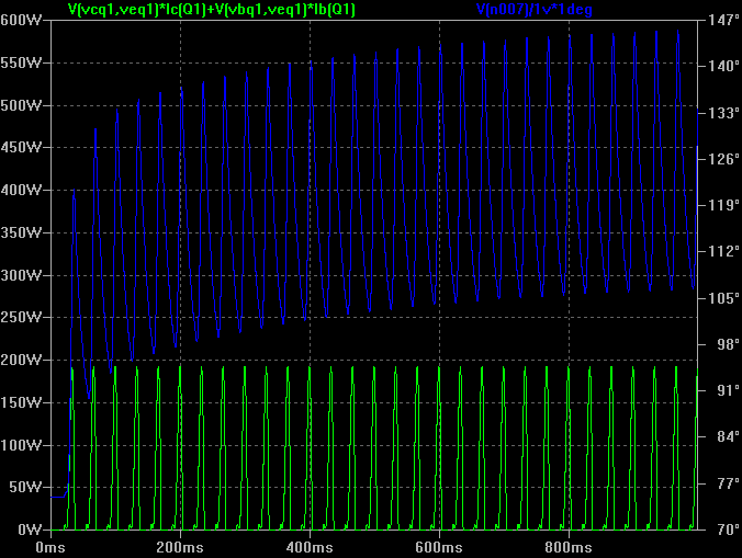

The attached image shows a simulation for +-50V ideal non-sagging supplies and a 6 + 8j ohms load (about 60 degrees phase angle) just before clipping which is worst case for reactive loads >= 45 degrees. 45 degrees will give a little lower peak powers and temperatures. Frequency is 30Hz, chosen low for worst stress on transistors.
The simulation is done with the FJL4x15 thermal model, .4 K/W case-heatsink, 75 degree C heatsink, thermal capacity of package was chosen as 1K/J (it should be higher in reality but this only matters for >100ms times).
It can be seen that thermally this is not a problem, second breakdown shouldn't be a big problem either at this low voltage supply - it can take 350W for 100ms at this voltage single pulse or 600W single pulse for 10ms. The pulses are 10ms but not square but half-sine-ish, making the calculated 200W pulses equal to somewhat lower square-pulses. If it can take 350W for 100ms single pulse without second breakdown it should be able to take 120W or so for 10ms repetitive without any problems at all as long as temperature is kept within reason.
Average dissipation is 40W transistor.
