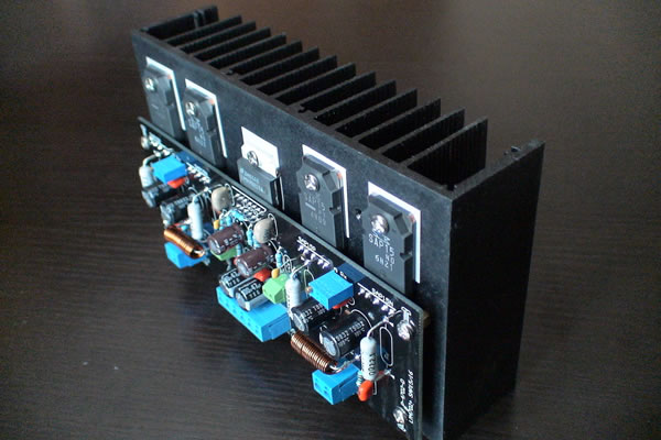

It will work just fine. Take Jack's suggestion on the cap across the Source/Sink pins. You might want to try different values like a small pF range cap and then maybe a larger value (uF). Different combinations and values will allow you to get good results.
For sure go for a potentiometer for the bias resistor, 500 - 1K ohms will be plenty. These devices only need about 1V across them to get around 100mA of bias current. You might also want the gate resistors to be 500ohm pots you can adjust.
Have some small silve mica caps for the compensation capacitor (C3, C4). You won't be able to get great slew rates driving the FETs directly so you may want to reduce these capacitors to as low as 10pF.
The whole design is pretty sensitive to layout so be careful about routing power and GNDs. I would plan some places for supply decoupling capacitors on each output device.

MOSFET can use simplified circuit
When using MOSFET output level, the "G" of the MOSFET not need for gate current,
so can the use of OP amplifier output with MOSFET drivers directly.
But input capacitance , MOSFET than Bipolar transistors much, and so should be provided by the OP amplifier capacitance transient charge and discharge currents. Therefore, OP amplifier directly with MOSFET drivers, worried about its stability and high frequency characteristics.

Dxvideo said:PS: On output you see 10E resistors. However theyre coils not resistors. [/B]
Are you sure that it isn't both. Often the output use a 10ohm resistor with a coil wraped around it.

Dear friends,
I am not experienced on transistor or MOS designs. So I copied that circuit from a friend.
First; I dont know what C3/C4 are for? Theyre a kind of stabilisator and to prevent high frequency oscillations? If they are, then if I use larger values that causes reducing the frequency response. Is it?
And L1 on outputs. Yes theyre not only coil. Theyre coil around on a 10R resistor.

To optimize slew rate with stability some compensation of the feedback loop is necessary when using MOSFETs.
