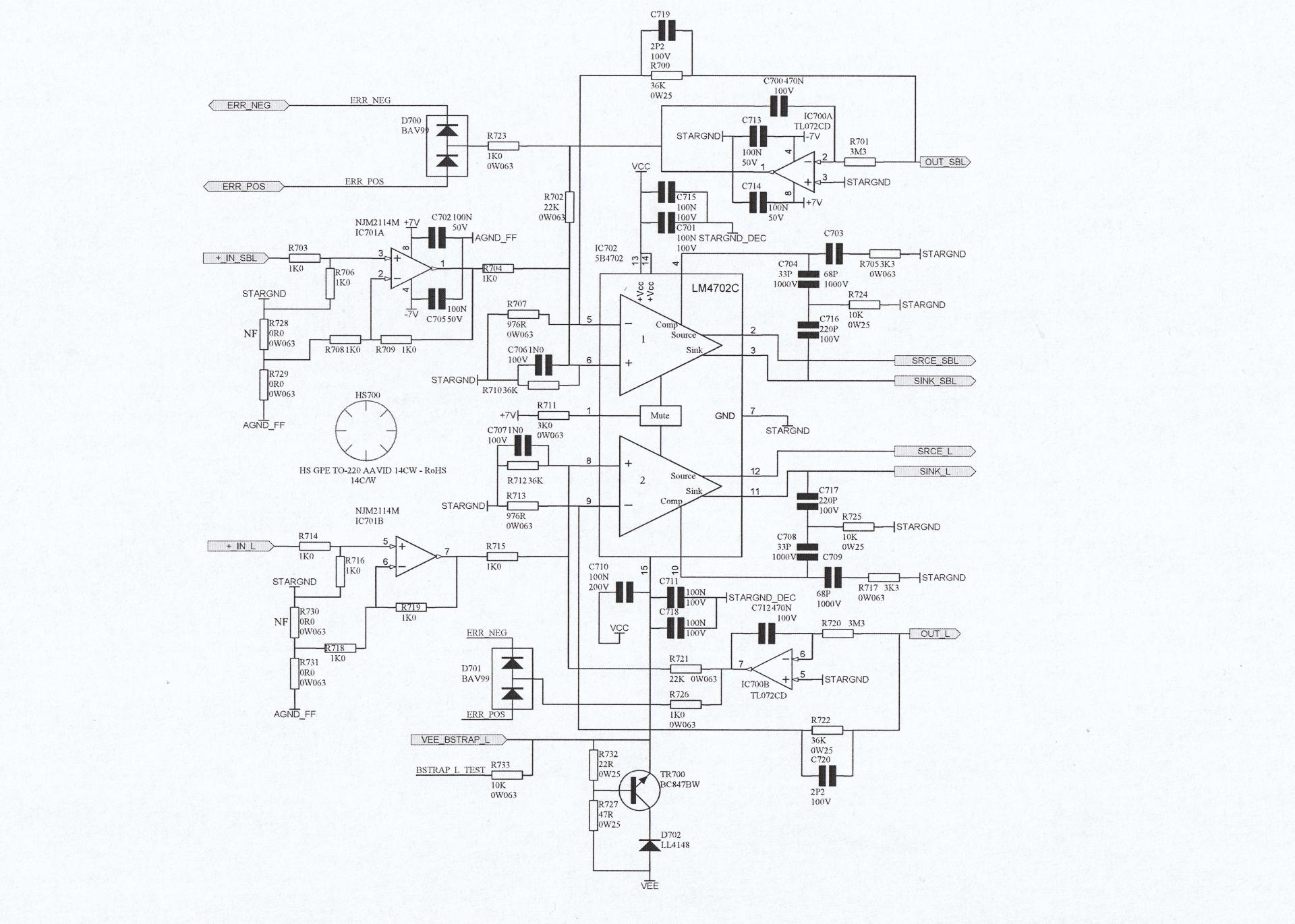

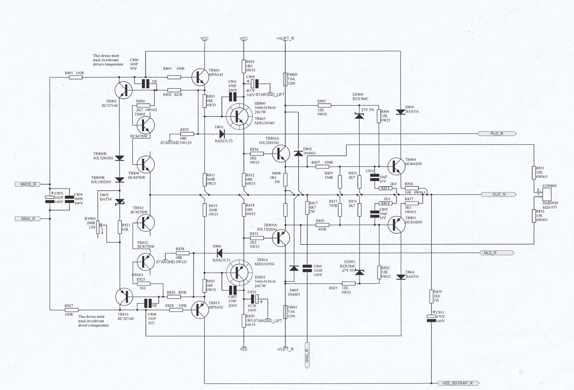

Here is Arcam's way - maybe the best way 🙂

i have done, now my primare has lm4702 with original power emiter follower and it sounds great with my Dali Grand, i am very happy with it.
sound i precise, dynamic with wide and deep soundstage.
lm4702 is a high end chip in my opinion.

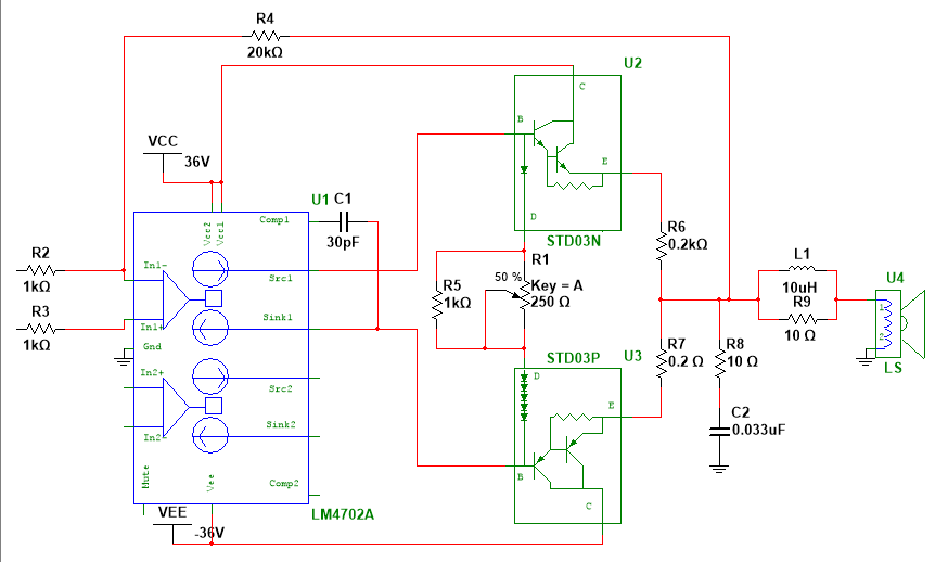

I want to make LM4702BTA chip amp with STD03N-STD03P.

LM4702 model is no longer on TI's website, its's a pity that the product is discontinued but the world is going Class-D. The SPICE model which TI had on their website didn't help with compensation.
In any event, it's very easy to implement an STD03N/P design with the chip. Instead of a VBE multiplier, use a 250R potentiometer between the Cathode of the N-device diode and the Anode of the P-Device's diodes.
Compensation capacitor of 30pF from the comp pin to the "Sink" output of the 4702.
The difference between the STD03N "O" and "Y" models is that the "BF" the "Y" devices have current gain of 8,000 to 20,000... the "O" devices 5,000 to 12,000.

Thank you for circuit .Please let me ask for these questions:
There is no need to use input cap ? And exactly what is the function of the inductor on output way ?
I always recommend two filters on the inputs to our audio equipment.
A High Pass filter to attenuate ultra low frequencies and block DC offsets.
A Low Pass filter to attenuate RF interference.
The output needs and output Zobel, R8 + C2
The output also benefits from attaching the Output inductor with it's damping resistor, L1||R9. This allows one to attach unknown cable and unknown speaker, without risk of destroying the amplifier due to reactive load induced oscillation.
I recommend a small alteration to the output inductor.
Make L1= 0.7uH to 2uH & R9= 10r||10r= 5r
Add an extra R+C across the amplifier's speaker output terminals. R=10r||10r = 5r, C= 100nF.
This gives a Pi version of the Thiele output network where two Zobels are fitted onto the output inductor.

I just showed the output stage -- you can follow the data sheet example, or do something a bit fancier, such as using opamp buffer and inverter, plus servo.
