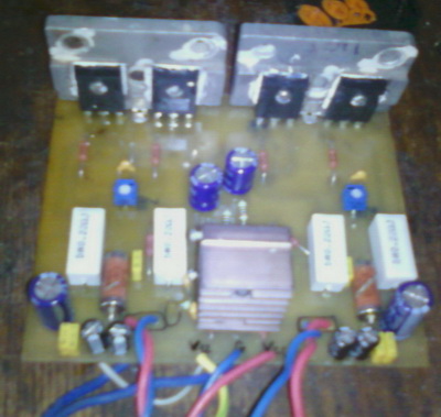

Is there a known-good PCB design for the LM4702 I can use?
If you like lateral MOSFET's you can use mine -- here's one fitted into my Pioneer SX-838:

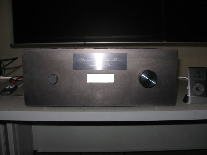

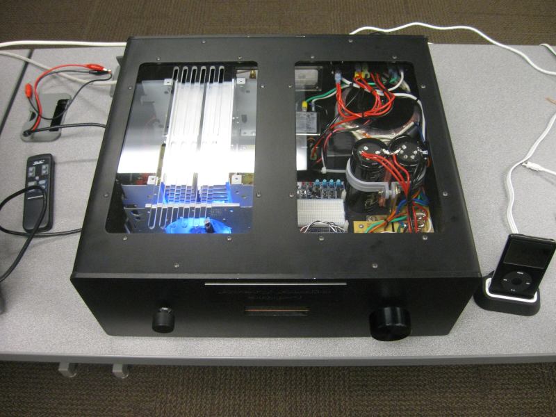

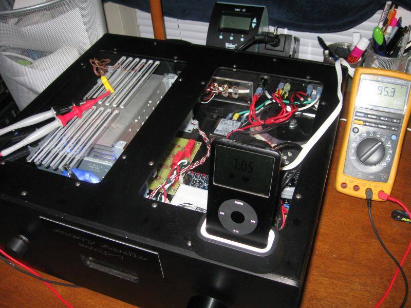

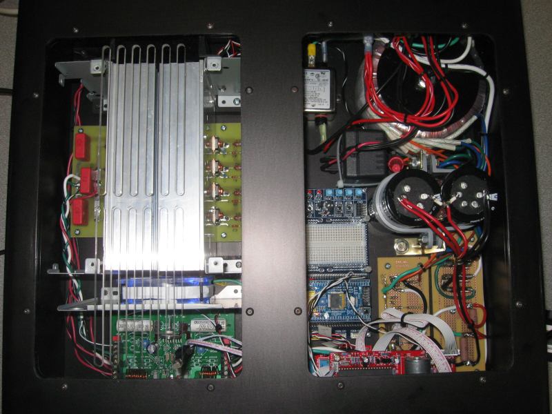

I have my LM4702 amp up and running after several hurdles. I would really like to thank jackinnj for all his wonderful help. This is using the AN4442 transformer and 58/60 lateral mosfet configuration. It has 4 analog single ended inputs, ipod dock, remote, front panel lcd that displays input and volume via AtMega128. The sound is amazing. I have it running two Polk Audio RTIA3 bookshelf speakers and couldn't be happier with the sound quality.
