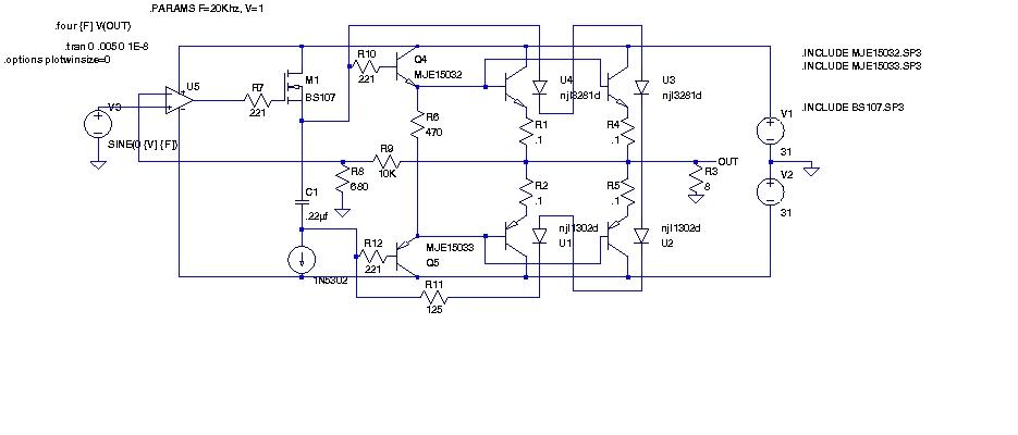

You just have to use the LM4702 as an opamp (tie the source and sink together) then drive your output stage with something like a BS107(small signal MOSFET) in common drain which will present a very easy load for the 4702. You can then use a VBE multiplier, or diodes + pot, or whatever other means of obtaining your bias voltage/current you like. This approach allows you to almost limitless output device possibilities.
I have been running a couple circuits now with this approach with very good success.
This link describes the output stage I am currently using:
http://www.diyaudio.com/forums/showthread.php?postid=1105232#post1105232
I just made a PCB with no input stage and drove the circuit with an LM4702. I now have two channels running, and they sound great.
I have found that using the LM4702 in this way seems (to me anyway) to get more out of it. I was not very impressed with either the data sheet application nor the later app note circuit, but that may just be me.
Here is what I will try next which I think will be better than using Darlingtons like SAP16...
Cheers!
Russ

use the 4702 to drive discrete darlingtons arranged in dual EF.
You can tack on as many output devices as the driver EFs will allow.

Complementary Darlington a la Leach, perhaps:
Dr. Leach places diodes for the VBE multiplier on the heatsink -- I may be able to adapt my driver boards to do this.
The typical output current of the LM4702 should be around 5.5 mA. It's in the data sheet.AndrewT said:Hi Dfdye,
what 5mA limit?
My concern is that the Leach output stage will draw more current than the chip is capable of putting out. I haven't done the math, so I don't know, but I would check before I put the time and effort into building an output stage that wouldn't have a chance of working. I just don't know!
I would love it if it will work, but the idea that Russ came up with for using mosfets as the first current gain stage of the "darlington" (not that his stage resembled anything close to a Darlington configuration) sounds like a great idea. Hfe seems to be around the right range, but I haven't thought about it in a while.
Hi Df,
let's do the sums you cannot be bothered to do.
Assume the amp will deliver 100W into 8ohms. that's equivalent to 40Vpk.
Let's also assume the speaker Re=6r0, the peak current will be 6.67Apk.
The current gain of the EF output pair will need to exceed 1212 (6667/5.5)
Now choose devices that meet this requirement.
Driver hFE >50 Output hFE> 30 overall gain >1500.
With modern high gain devices 8000 is achievable.
Add a pre-driver and 100,000 from low gain devices is on, over a million from higher gain devices.

I can say I have been very happy with it. Keep in mind I am not using it at all conventionally. The circuit shown here:
http://www.diyaudio.com/forums/attachment.php?s=&postid=1118401&stamp=1169995045
is only half the amp. It is being driven fully symmetrically via one of my TXD modules. The output is bridged. I must confess I cannot (at least not accurately yet) measure the distortion, but I can report it sounds great, and it can drive a serious load (3-4 ohm) without fear. The on-device biasing diodes work wonderfully.
I am finding using the 4702 as an ordinary op amp(tie sink/src) seems to be getting me the results I like the best so far.
I have tried SAP15/16, TIP, (yes discrete too) etc in conventional way, and I liked it fine, but I like this better.
I also have a newer pseudo-quasi-complementary (there is some debate on what to call it) FET output stage which is showing a lot of promise. Still my favorite is the one you mention. BTW that BS107 works fine, but so will many other transistors.
Cheers!
Russ
