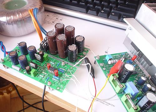

I'm running my output transistors 110mA per channel (they have low threshold voltage so this is possible). VBE transistor is a useful thing when using small heatsink.
Like you can see my boards is quite universal and there is no need to use all the components (no output coil in my present amp).
This amplifier needs preamp 😀 Now it sings 😀
