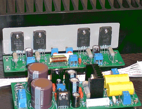

This version also may suffer similar heat problems as the commercial one because the power transistors for both the channels are close on the heat sink. What is the power output these boards are targetted for?
Routhun.
Mine can deliver about 2 x 100W (THD - 0.001%). I will use two of this boards to make symmetrical amplifier (+ OPA1632). Spaces between transistors are big enough and LM4702 won't be mounted on the same heat sink.
Re: Re: Heat problems
I have been running a similar amp for months now, but my power modules are separate from the driver, and can be just about anything. My prototype uses SAP16s. I actually have a whole thread about it.
http://www.diyaudio.com/forums/showthread.php?postid=949032#post949032
It is working quite well, but I think I am onto something I like even better. 🙂
I have not posted to the thread in a while, a lot of the PCBs/schematics have actually changed, but the concept is the same, and works quite well.
I have also designed (but not implemented yet) over current protection and a soft start thanks in no small part to my friend Mauro Penasa.
Cheers!
Russ

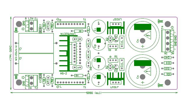

New Version for 4702C
:smash:

Re: Re: New design for LM4702CTA
veteran said:
Lovely, now you can use few different output stages with one, LM4702-base board 😉
You and I have both done the math for that one! My bet is that the power from the LM4702 wouldn't be up to scratch for driving more than one board. I think you would have to put an intermediate current gain stage before the output boards to drive more than one. Of course I don't have the numbers for that particular system, but my back-of-the-envelope math says "not quite."
