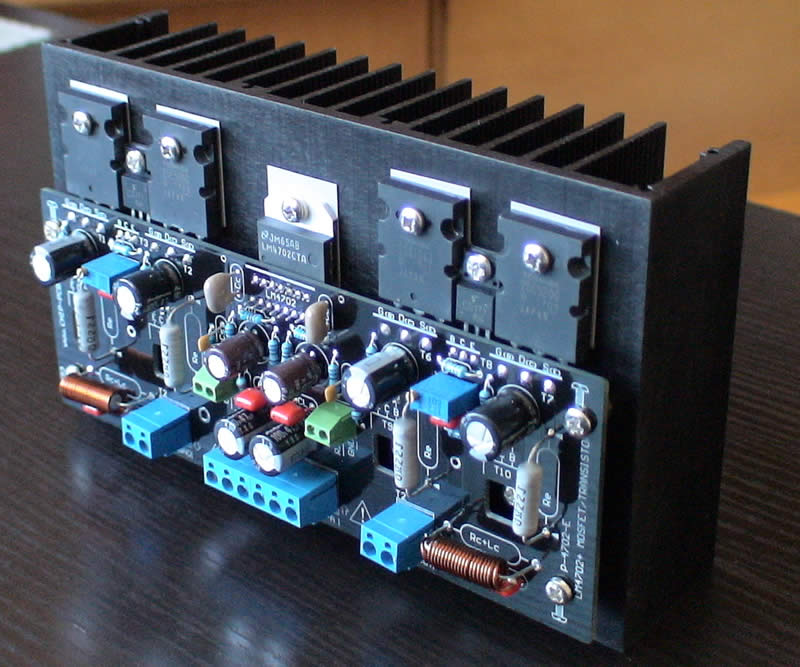

Looks very nice, Monkey. Any other specs. available, like supply voltage, THD+N, etc, etc? The driver ICs, I only see one driver per channel, are these for biasing or for higher driver current? Just curious. Thanks for the nice pic.

it's a 2pair output stage with complementary drivers for the upper and lower halves.

Photo shows LM4702+2SA1943/2SC5200, drivers: 2SA1930/2SC5171 are mounted to the HS through the square holes in the PCB
Have a look at monkey29’s web site for more photos.
Great OEM work.
Great OEM work.
I see now, didn't see those holes before. The web site also had some more pics, as mentinoed, that made it more clear. Thanks.
