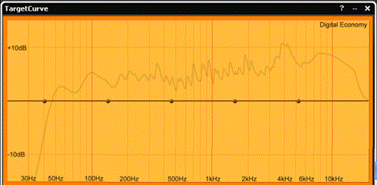

ok, I did further modeling of this. This time including Orion ASP equalization and the actual Speaker impedance curve over frequency range for each speaker. I compared scenarios of each speaker being powered by a single Amplifier, a Bridge Amp and a Parallel amp.
And the best combination to power these speaker was found to be following:
Each woofer will gets powered by a Bridge amp running at 24V rail producing about 37W average (74W max) and requiring 2.9A max current (per amp). The Woofer offers <8ohms impedance above 50 Hz, however since ASP equalization is -ve db, therefore current requirement and heat dissipation stays in control. At the same time woofer impedance increases significantly below 50Hz, that's where Bridge amp is able to provide a higher voltage swing. Since speaker excursion is Voltage limited, therefore bridge offers higher output in sub 50hz space till restricted by max excursion, above 50Hz it does not hit the current / thermal limit so output is same as what parallel amp (at 40V rail) offers. Overall Bridge amp runs 6deg C higher than Parallel amp, but still within limits.
Each mid-range will get powered by a single amp running at 35V rail producing about 23.8W average (54W max) and requiring 2.9A max current.
Two tweeters (on one side of speaker) will run in parallel, powered by a single amp running at 21V rail producing about 21W average (27W max) and requiring 3.3A max current. Two tweeters in parallel offer 2.5 ohms resistance, however since the ASP equalization is very -ve therefore current and thermal requirements are within limits.
All amps at all intended frequencies are within their heat dissipation limits and when set for 26db gain, with 1V input calculate to produce about 90db freespace SPL (+/- 5db) in woofer, mid range and Tweeter approx.
Finally for the first time I have started seeing a somewhat flat speaker output across entire audible range 🙂

Why I have taken 1V peak as input to ASP, because at that level with recommended 26 db gain, the woofer channel becomes voltage limited to produce flat response below 45 Hz (even with a bridge amp).

Hi Paskal,
I have already incorporated only the frequencies that the tweeter amp is going to see based on the crossover from ASP ie. 1.4khz to 20khz.
And that is the reason where while 90-20hz will get 154W max (97W avg), the 1.4khz-20khz only gets 28 W max (21W avg). So if you see the tweeter amp is already running much lower compared to the woofer.
Also if you see, Orion has a much lower cutoff for tweeter than most other designs.
I tried measuring levels in various music and broadly on an average I can say that same levels are needed from 40hz to 15khz. That said some musical passages do have higher energy in 30hz range, or 15+khz range.
