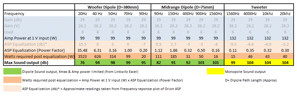

confirm that calculations (till Watts required post equalization) are correct.[/B]
The assumption that the load has 8 Ohm at all frequencies is not correct. No speaker poses a resistive load.
Both woofers for the Orion are 4 Ohm types, whether you take the Peerless or the Seas. So you should use two parallel chipamps for each woofer and a single ended chipamp for the midrange and tweeter to make use of the same supply voltage. As a side effect you already get double the power for the woofers.

The recommended 26DB = 50Watts, so I am going with 29db=100 Watts.
Did you consider to start with 50 W and decide after the first listening test, whether more power is needed at all?

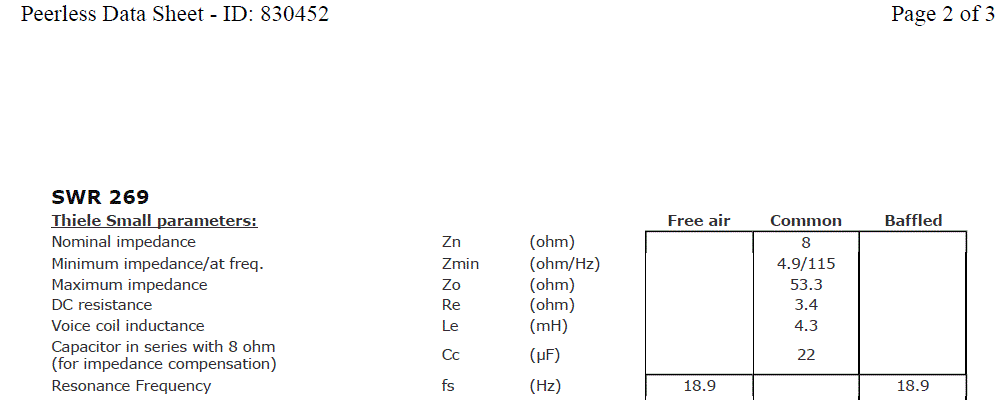

One basic question: The amp is designed for the nominal impedance or the DC resistance? Below is from the peerless woofer datasheet...
The amp when playing audio will see approximately (see "The assumption..." in #103) the "nominal impedance" of the speaker, and that's what it's designed for.
Any DC offset will create a current based on the offset voltage and the DC resistance.

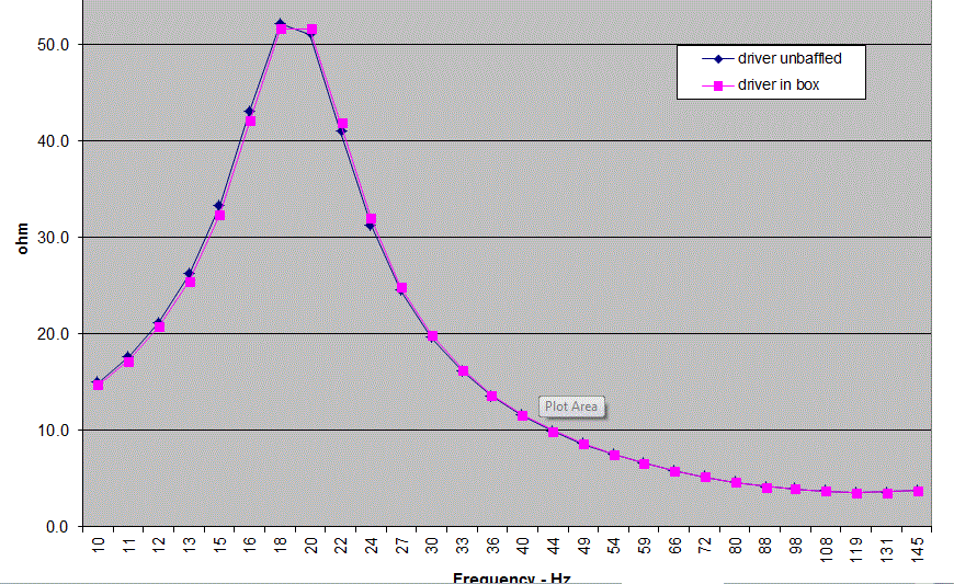

Here is the impedance curve for the woofer. It varies from 3.9 ohms (at 98hz) to 51.3 ohms (at 20hz).
So what impedance should be considered while selecting the amplifier? The impedance is below 8ohm between 50hz to 100hz.

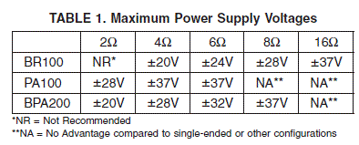

2 LM3886 in bridge mode or 2 LM3886 in parallel mode?
As per National AN1192, two LM3886 in parallel have no additional benefit (over a single LM3886) above 6 ohm load.

I don't know, where you got your datasheet from. Rev 1_0 from 12-Apr-10 from the Tymphany homepage states that the XLS10-P830452 is a 4 Ohm woofer.
The amp must be designed for the nominal impedance, when it comes to heatsinking, and for the lowest impedance, when it comes to current capability.
So assuming you use 28 V rails on your 4 Ohm woofer, you can expect that a single chipamp can deliver sufficient current just so, and heatsinking will be on the borderline, too. Based on the knowledge that chipamps tend to produce thermal distortion and reduce the output current limit threshold ever further, the hotter they get, you should absolutely use two LM3886 in parallel for the woofer section.
I think Tymphany has revised the woofer in 2010. As the specifications I have (as shared by JB74, which also match specifications in Linkwitz calculations) are different in all aspects from the new specifications on Tymphany' website.
May be this was the reason SL, dropped Tymphany and switched to Seas woofer in latest version.
That said, looks like the 8 ohm nominal impedance on the earlier data sheet seems to be a typo.

The data is from the specification sheet so I presume it is correct.
.......... looks like the 8 ohm nominal impedance on the earlier data sheet seems to be a typo.
you must learn to interpret what you read and become effective at separating the "wheat from the chaff"
The internet is not a reliable resource. Always look for some form of independent corroboration.

How about BPA200 (bridge parallel amp) with 2 LM3886 in parallel on each leg of bridge, to drive the two woofers in parallel?
As per AN1192, it is rated at 335W continuous at 4 ohm (28V) and 450W burst clipping power. It is also 2ohm stable (at 20V).
