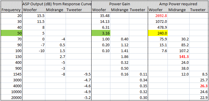

Now Linkwitz recommends same power amp for all channels with same gain for simplicity. However since I am going DIY route, therefore it makes sense to determine how much power each Woofer / midrange / tweeter requires and make the amps accordingly, while still keeping the gains same across. (No point beefing up Tweeter amp).
To find this I looked at the ASP response graph (Active Signal Processor). This graph shows the equalized frequency response curve that will go into the each amplification channel of woofer/ Midrange/Tweeter of the active amp.
I saw a huge boost for the woofer for dipole equilization, So I looked at the chart and approximately determined the ASP equilization at different frequency points. Given that gain on all amps is same, this gives the relative power required (using Power Gain as multiplication factor) for each amp channel when a 0db input to the ASP is provided.
Since the Woofer output of ASP feeds 2 woofers, each having two LM3886 bridged (120W RMS), so one woofer ASP channel output = 240W. Now if I map the woofer amp channel to produce this 240W at 50hz*, then using the power gain values, I can extrapolate, how much watts will be required for midrange and tweeter amp channels based on ASP equalization output.
Amp Power required for Mid / tweeter = 240/3.16 x Power Gain (at respective frequency)
So we see that in above scenario, maximum power required by mid-range is 141W at around 150hz, and 26.3W by tweeter at 4khz.
Based on this I am planning to use
2 LM3886 in bridge mode at 28V rail to give 120W output for each woofer (total 240W for both woofers)
2 LM3886 in bridge mode at 28V rail to give 120W output for the midrange (this is slights lower than max required)
2 LM3886 individually at 28V rail to give 13.2W +13.2W for the two tweeter (It might be possible to use just one LM3886 amp here to power both the tweeters).
IS my approach correct? Does this makes sense?
Are my numbers correct?

The calculations looks OK. Anyway you may not be using all the speakers at full power, so for normal listening levels, you can fine tune the gains individually while running the speakers with amplifier.
This won't work for the Orions...to get the intended response from the speakers each amplifier channel regardless of its output capability in watts must be matched in gain to all of the other channels. Otherwise the differing gain settings will alter the balance between the drivers that is set by the response of the ASP.
ST7677 I think you may be drilling too far down in trying to find the exact power demand balance between the Orion channels. Due to the demands of the dipole compensation the ASP response curves will tell you that the woofers need far more power than the mid and tweeter channels. Also the fact that many Orion users have experienced woofer "bottoming" in operation without issues in the mids and tweets reinforces the appetite these woofers have. Your plan to use a bridged pair for each individual woofer, a single amp for each midrange and a single amp for each paralleled pair of tweeters will nicely meet the power needs of each channel. Then carefully gain match all channels (to +/- 0.1dB) and you will get fine results.

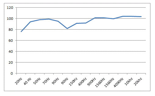

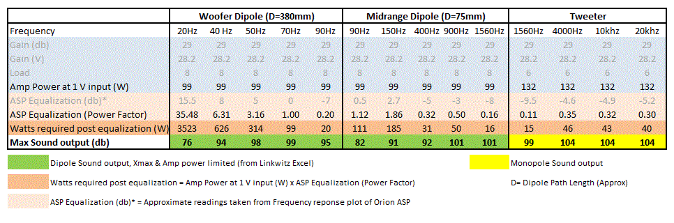

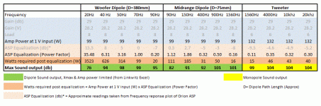

Here are the revised calculations. Some one who knows this please check for one column and confirm that calculations (till Watts required post equalization) are correct.
And this is what the theoretical sound plot looks like...

Analysis paralysis?
ST7677,
You're re-engineering the wheel here and have lost focus on your project. All of this engineering and prep work has already been done by Mr. Linkwitz.
Worrying about voltage gain implications when "Y"ing a low output impedance ASP output into multi-k-ohm loads is waaaaaay down on the worry-about list.

Yes Davey, I was getting a similar feeling. Kevin also echoed the same.
Its much more complex than I thought for a non engineer like me to figure without derailing the project.
I guess I will go ahead with 29db gain on all amps without exploring any further on this
