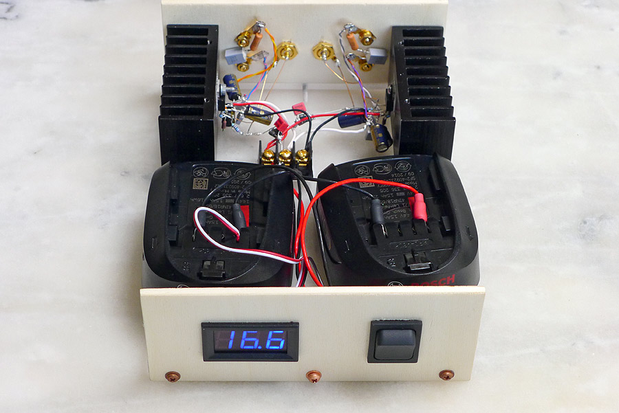

Hi guys,
Thank's..
In fact it's like a 6 db HP near 1 hz..
Maybe rail splitter is a good way, it's fix equal voltage, I'll watch it..
Another comment about potentiometer, I try 10 K, but it seems 27 K was better, what is the right value for LM1875 in my case ?
Phil.
I received new Li Ion bat, better sounding than NiCd, much clear..

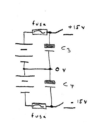

Look at schematic below, what happen if I add C3 et C4 (1500 uF or more) ?
Phil.
Phil.
About fuse, I have ordered, waiting I try to live without
So this caps act like DC blocker..

similar in that provides a low impedance in relation to the speaker. lower Xc the better bass sounds. small 4" 8 ohm speakers not much bass so around 1,500 uF is fine. maybe 220 mm 4 ohm bass woofer use 4,700 uF.

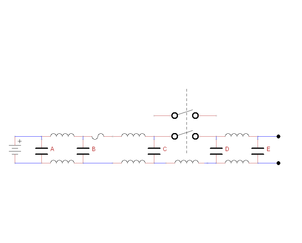

Adding capacitance close to the chip pins will have more impact than when you place them close to the batteries.
Every component and wire have parasitics. It is these parasitics that add to the circuit. Sometimes they help but mostly they create problems like instability and unwanted filters.
In the schematic you can see that capacitor A will react differently than capacitor E even if they are of the same value. The same applies for the whole layout. Add the inductance to the zobel or feedback networks and see the real circuit.

remember the formula for C uses freq Hz and Xc ohms.
so 1/2 lower impedance require double C, and bigger drivers use lower frequencies Fc (-3dB) means more C than a higher cutoff.
energy comes to play too lower freq have more Volt *seconds, e.g. bigger caps hold the charge voltage longer, given the smallish battery can sag under load with real wires / fuses etc.
no the chip amplifiers output damping factor and voltage feedback controls the driver back emf and Le.

Complete schematic post one was upgraded..
About cost, it's near 100 euros with the two bat (about 35 euros for one).
If I remember correctly the LM3875 (low power, 18 volts), sounding is very close.
The first time I listened to an amp powered by batteries, I was surprised by the great soundage and clarity, as if crosstalk was gone.
Phil.
