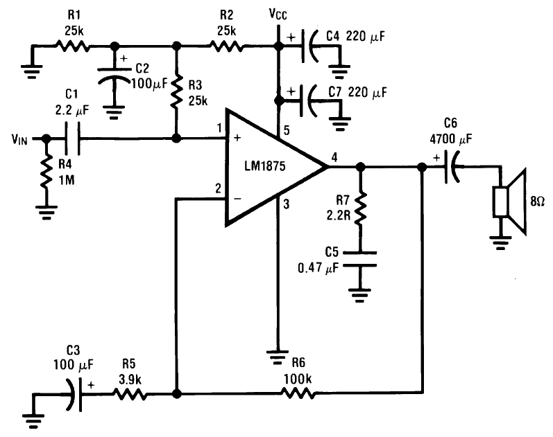

Hi all,
Thank's Daniel for single rail schematic..
I think we can use TDA2050 instead 1875, with same values ?
Only problem I saw : 4700 uF ! What quality, can be used bipolar ?
I'm always happy with my build, batterie life is near 12 hours, amp stop when voltage is 6,5 volt, and just before I don't ear any distorsions like with LM3886.
It will stop abruptly..

Yes, it is cross compatible to most 5 pin amplifiers.Hi all, Thank's Daniel for single rail schematic. I think we can use TDA2050 instead 1875, with same values? Only problem I saw : 4700 uF ! What quality, can be used bipolar?
Output cap for single rail amp is an ordinary polar cap (as it is marked on the schematic). The voltage capacity of that cap is same as for any on the power circuit (or if you had to guess, it is 63v when if the voltage isn't known).

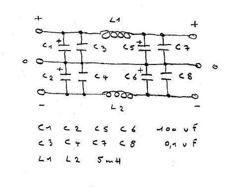

Thank's Daniel, I had not done enough attention to your post 103.
I must will order some new caps, and make 2200//2200 uF..
I would build as my schematic for filter and see what's happen.
