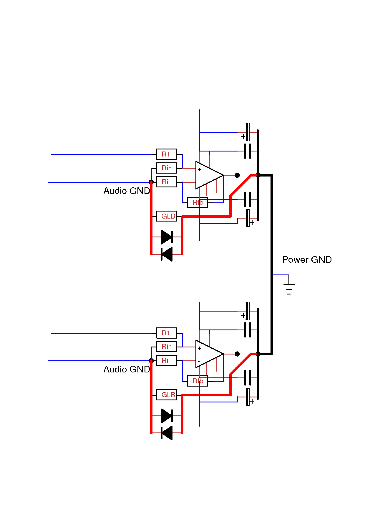

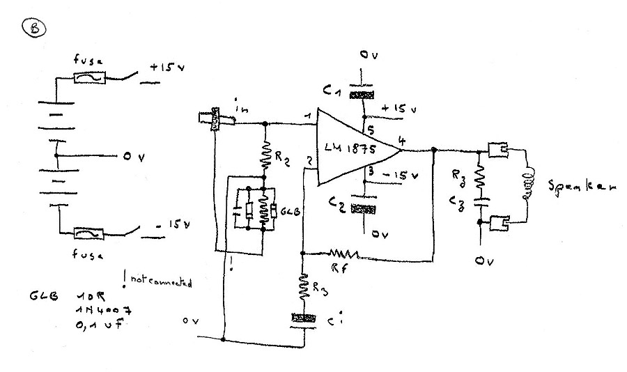

You could place the GLB between the Audio Grounds and Power Ground, one per channel. In this configuration the resistor is also part of the feedback loop and the diodes are there to protect the resistor. If the resistor fails the output will go to full negative rail voltage.
The My_Ref amps have a similar layout but without the diodes. The resistors do fail and activate the speaker protection.

You must reduce that LOOP AREA in the input circuit.

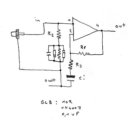

Okay, so use the resistor, the diodes, AND add the 100n. 🙂

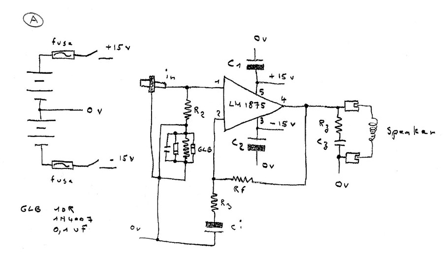

Ok, but how to make wiring ?
See below a proposal.
No.
The feedback R3+C: connects to R2 and also to input return/cold.
This Loop Input Hot to R2 to +IN to bottom of R2 to bottom of C: to input cold MUST be ultra low LOOP AREA.
If you can get Rf & -IN and top of R3 also with very low Loop area then that too reduces interference effects.
Although we don't have the details, this is almost certainly what Tom had to do to get the exemplary performance from his composite amplifier.
The bottom of the Disconnecting Network (DN) connects to the Main Audio ground.
It is the voltage reference connection between the Output and the Input and passes almost zero signal current. You will probably not be able to measure the Vdrop across the DN.

Try to understand the circuit. Place the GLB between the audio ground (input and feedback) and the power ground (PSU , Zobel and speaker).
Trace the different current paths, like input, output, feedback, power supply and any ground loops.
The feedback current flows between the audio ground and the power ground.

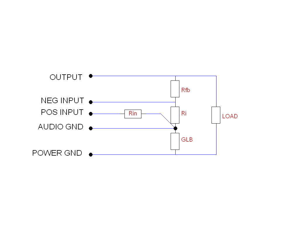

The feedback loop is output->Rfb->Ri->Rglb->power ground and is parallel to the output load.

Thank's a lot, simple and easy for soldering !
I keep the 0,1 uF in GLB like Daniel said.

Part of the "fun" of P2P is that you can learn.
Try to understand what each part does and how the layout can also change the circuit.
Redrawing the schematic can sometimes give you a different perspective.
Here you can see the feedback current route and how it relates to the output voltage. You can also see the ground loop path.

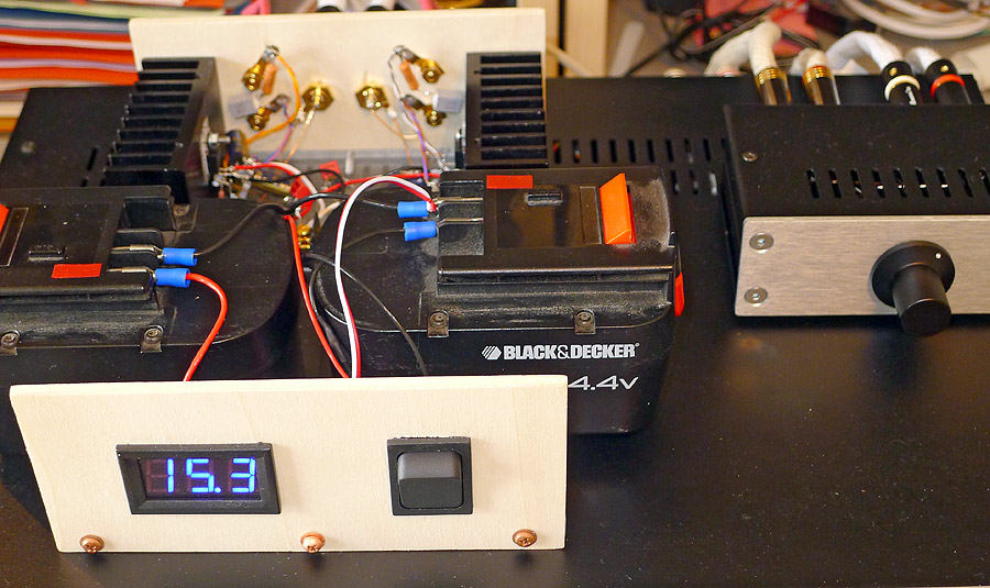

Dc offset is near 0 after 2 seconds, without load..
I will test later with speakers and music.
Yes Mark, P2P is not easy to build and for wiring, but I learn more about ground loop, 0 volt, breaker and so.. Very instructive.
Not realy a nice amp, but I consider it like a prototype 🙂

You can, I'm sure you want same 😀I'm jealous.. It's beautiful! 😉
And it's works well, it looks a bit like LM3875 "low power"..
At 6 Ohm load, DC offset is 2 mV, heatsinks stay very cold, 25° for 22° in room.
Just a small defect, a little "ploc" when I switch off.. But not dramatical..

Input noise. Possibly need the IN+ base stopper in series with the input coupler, like this:
cap > base stopper (that's a resistor), input load, amp
Your amplifier is trying to correct the difference between the dividers located at in+ and in-, which it can certainly do except during power on/off conditions. (WHAM!!!)
alternative ordering is:
cap> input load> base stopper> amp
You might have to try both possibilities to get the power thumps stopped.
