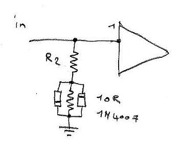

First time I want to have a "separate" between 0 volt and input ground !
Maybe attached schematic was better..
Phil.
That's a low current area. Just use a 100n cap instead of the 1N4007 clipper.Thank's Mark (and Daniel), speaker return was moved (centerpoint of the 220u)..
