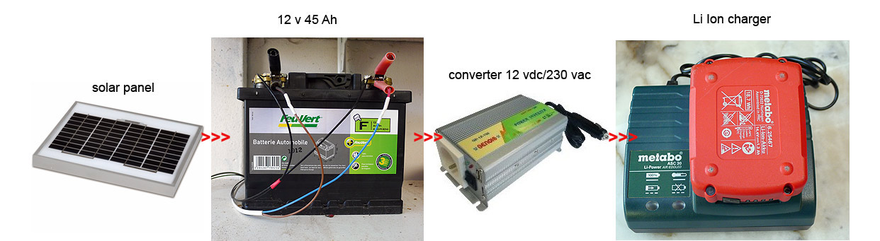

the battery runs down in 7hrs. Can the sun recharge the battery in the daylight hours available?

Yes of course..
Solar panel charge 12 volts battery, it's like a tank, on this bat I connect a DC AC Converter like this :
Amazon.com : 300W Car DC 12V to AC 220V USB Power Inverter Adapter : Vehicle Power Inverters : Electronics
and then I connect Li Ion charger on this converter..
I hope it is clear enough.
Phil.
For recharge one Li Ion, it take 30 minutes with charger 230 v and 80 watts uptake..
How with a converter 12/230 volt ? I don't know.
Rough math tells me that the demand from the 12 volt battery to feed the 230 volt inverter to supply the Li Ion charger will be ~7 amps. (NOT including the losses in the inverter and the Li Ion charger) Add another 500 mA.. 7.5 amps
You state it takes 1/2Hr. to fully charge each battery. (2 batteries) Figure 1 aHr. @ 7.5 amps..
If you don't plan to operate anything else from the 12 volt battery, figure the minimum battery size at 4 times this amount.. 30 aHr. This gives you a reasonably safe discharge level for a flooded cell lead acid battery. (25%)
Now you must replace the power that you use..
When charging a lead acid battery, you automatically lose 20% of the charge. Now you need to replace 9 aHr. back to the 12 volt battery..
I'll figure 2 hrs. of good sunlight in a day, which is possibly more than you would ever receive on a good day in December.. (Use the link I posted to figure that)
Divide what you need (9 aHr.) by the amount of good sunlight. (2) You would need to collect 4.5 aHr. per hour. Working voltage (12 volts) multiplied by needed current (4.5).. 54 watts of panel. I would round to 60 watts..
Rough estimate but close.. Oh, and you need a charge controller between the battery and the panel.. 😉

Hi OffGridKindaGuy,
Thank's for math !
I will use amp maybe two or three hours per day, that give about 3 days of listening. During 3 days, the lead acid battery will have enough time to recharge same if there is not much sun.
I'll buy the converter and experiment charge and discharge..
Yes I have a controller, it is integrated into the panel, solar panel is specific for battery.

I don't understand the philosophy of using two battery systems.
Each battery loses ~30% of it's input energy.
Two battery systems in tandem will lose ~50% of the solar power. What a waste.
Take the solar power and charge up a big capacitor.
Open up the lion charger and remove the whole mains side. Feed the capacitor charge direct into the DC charger circuit and feed the DC charger direct to the efficient amplifier, not a ClassAB.
Now you have NO BATTERY losses.

A blocking diode is a different animal than a charge controller..
Not supplying the battery with enough current to make it bubble a little will cause it to become Stratified over time..
Water Loss, Acid Stratification and Surface Charge - Battery University
I bought a converter, it's works.
At beginning voltage bat was 12,6, at end charge 12,3 volts.
So I hope charging two Li Ion without discharge completly.
