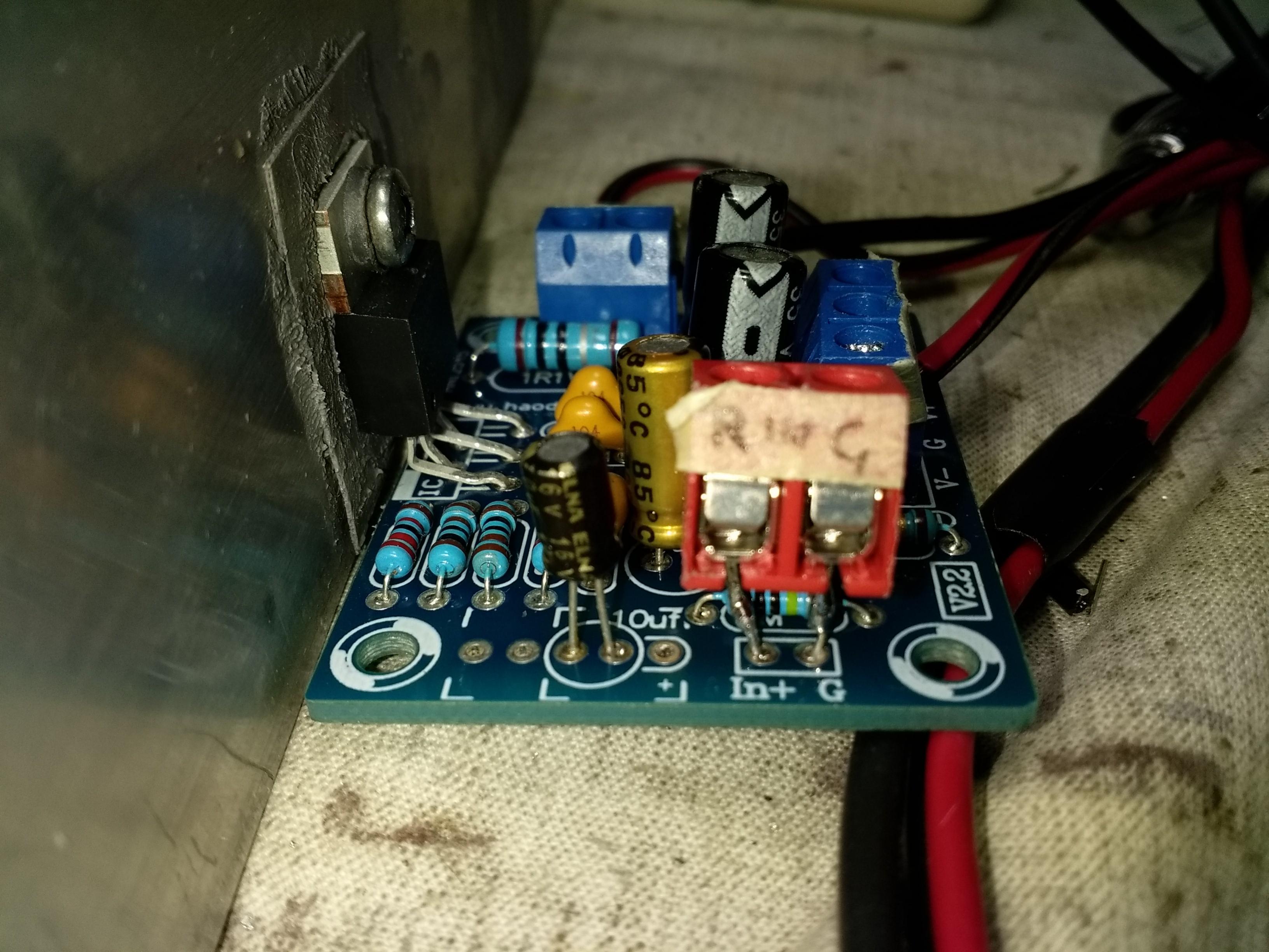

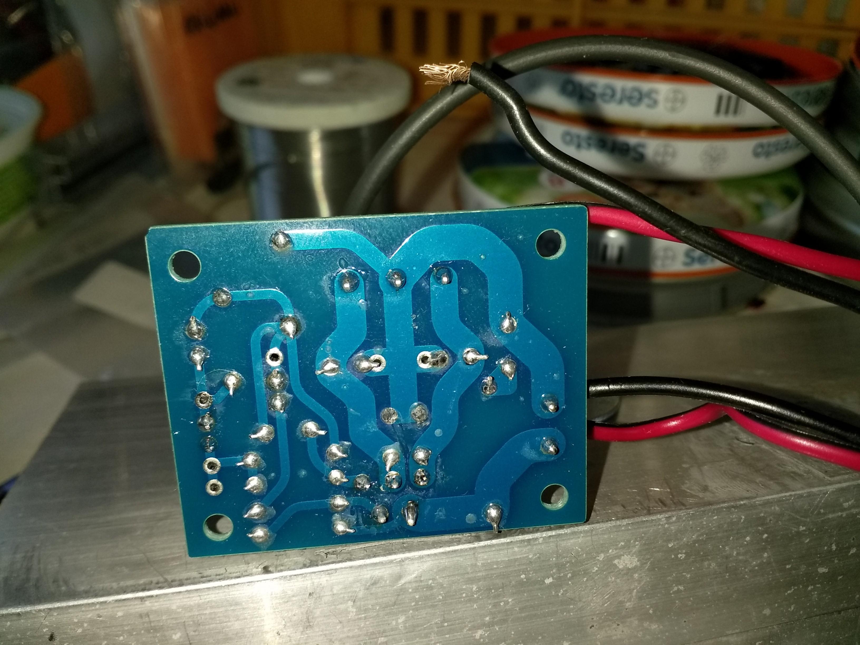

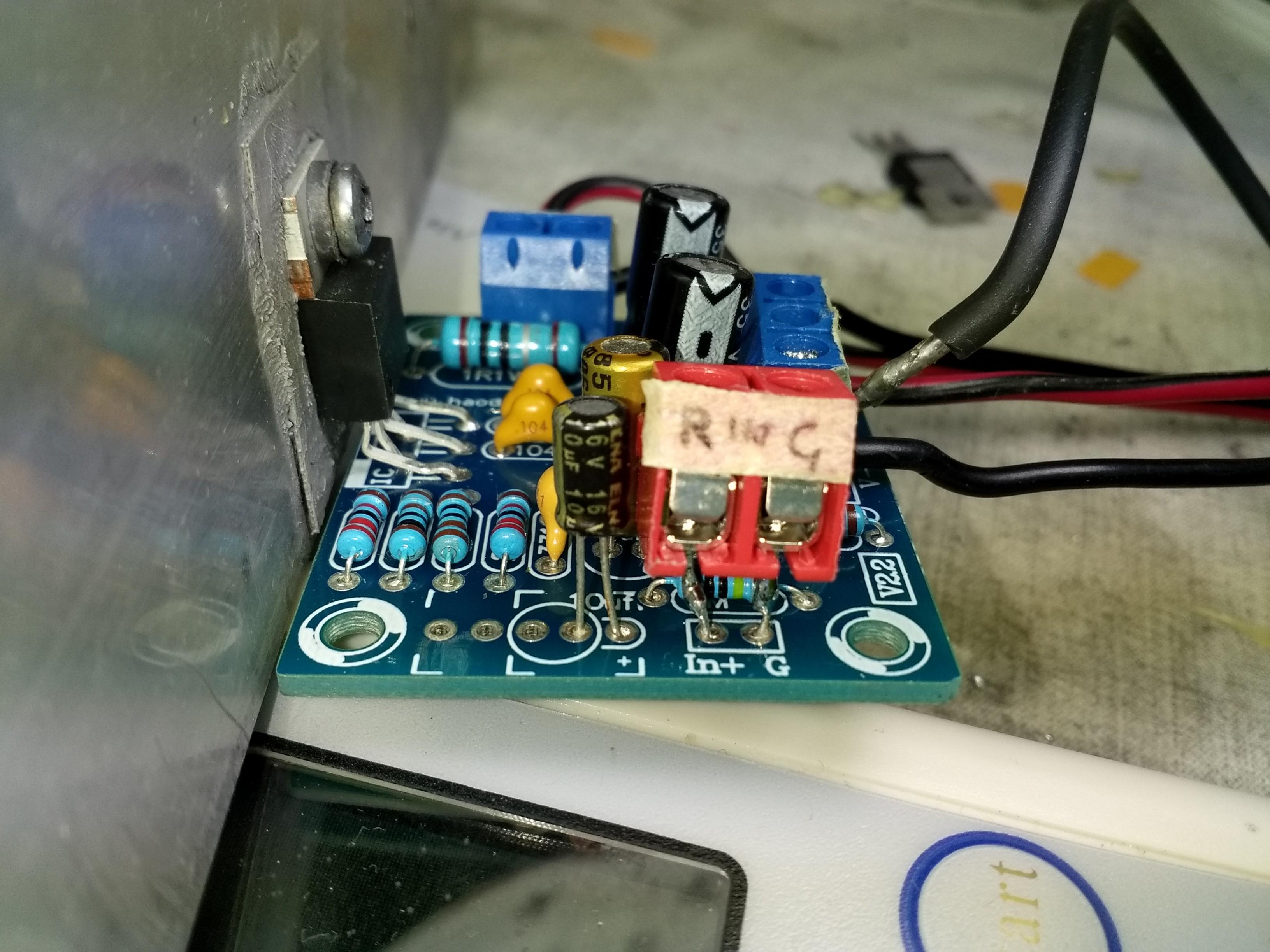

Ragazzi vi amo,ora funziona.
Siete stati fantastici.
Grazie
Metto le foto dell'errore prima e dopo.
Chissa' cosa sbagliavo in precedenza,forse la stessa cosa,mi sa che invertivo la polarità
Di quel condensatore.
Vi bacio a tutti

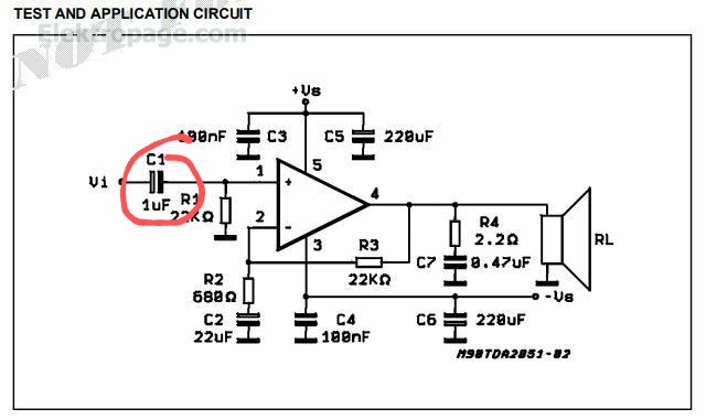

Una cosa volevo chiedervi , :quale Polarità deve avere quel condensatore?
Perche' a volte la trovo in un modo a volte in un altro.
  • tda2051_circuit_diagram_pinout_pin_connections_audio_amplifier_1_zz1~2.jpg

Guys I love you, now it works.
You are GREAT, thanks
Post before/after error picture.
Previous mistake was I had inverted that capacitor
Kisses to all.
One last question, which polarity should that capacitor have?
because sometimes I find it one way, sometimes the other
In truth, it´s the same both ways (in that case) because it has no DC applied ; although it is NOT bipolar, it can stand small Audio voltages with no problems.
I GUESS you had some soldering error which you corrected when inverting the capacitor.
Good luck. 🙂
