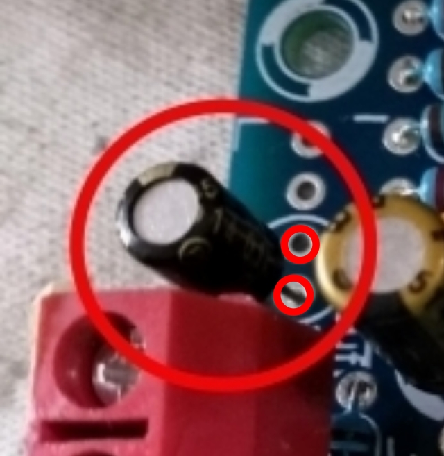

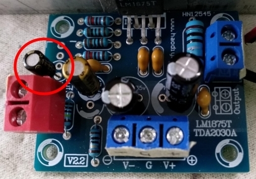

The capacitor circled in the attached image looks like it needs to move up one set of holes.
It appears from looking at the provided top and bottom views of the PCB that the pads that cap are soldered to are connected together on the bottom side of the board.
The red circles show the two pads I believe that cap should connect to.
Le tensioni sono corrette,e poi scusa cosa vuol dire , chip sono nuovi il cablaggio e' corretto, l'alimentazione c'e' ed e 34volt ogni binario 17volt .non puo essere alimentato male, l'altoparlante funziona.
Domattina ricontrollero' le tensioni ma penso che sia tutto ok
Administrator
Joined 2007
You put the black lead of the meter of the 0 volts line (which is ground) of the power supply. This point is where the two big power supply caps join together. Everything is measured from that point.
