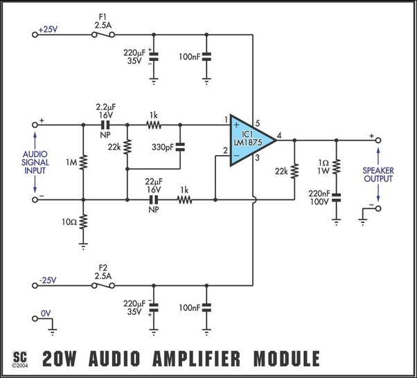

Anyway here's my schema and PCB, works pretty well. The relay is optional but avoids the very loud turn-off thump.
Edit:
I went through those links. You do not want to build this on a breadboard. At least a veroboard with tight component spacing and very short paths, as short as possible. I prefer using SMD as long as I can see them for this reason, it also simplifies layout. The 1875 is not the most stable chip at the best of times and needs babysitting. A breadboard is asking for disaster.
Hi, why did you choose 10ohm as zobel resistor instead of 1R? Was there a reason?
I haven't seen any stability with 10 ohms and this specific layout and component set. But then my input and feedback arrangements are very different too.
Also, I have a boatload of these 2W SMD resistors, so I tend to use them in all zobels. There is a case for lowering them in some instances, but I haven't encountered any yet.
The one thing I haven't included is the output inductor, which is soldered to the output jacks, as far away from the PCB as possible.
When in doubt, stick to the datasheet values.
This is. But i think your advice is good and i'll go for that.
