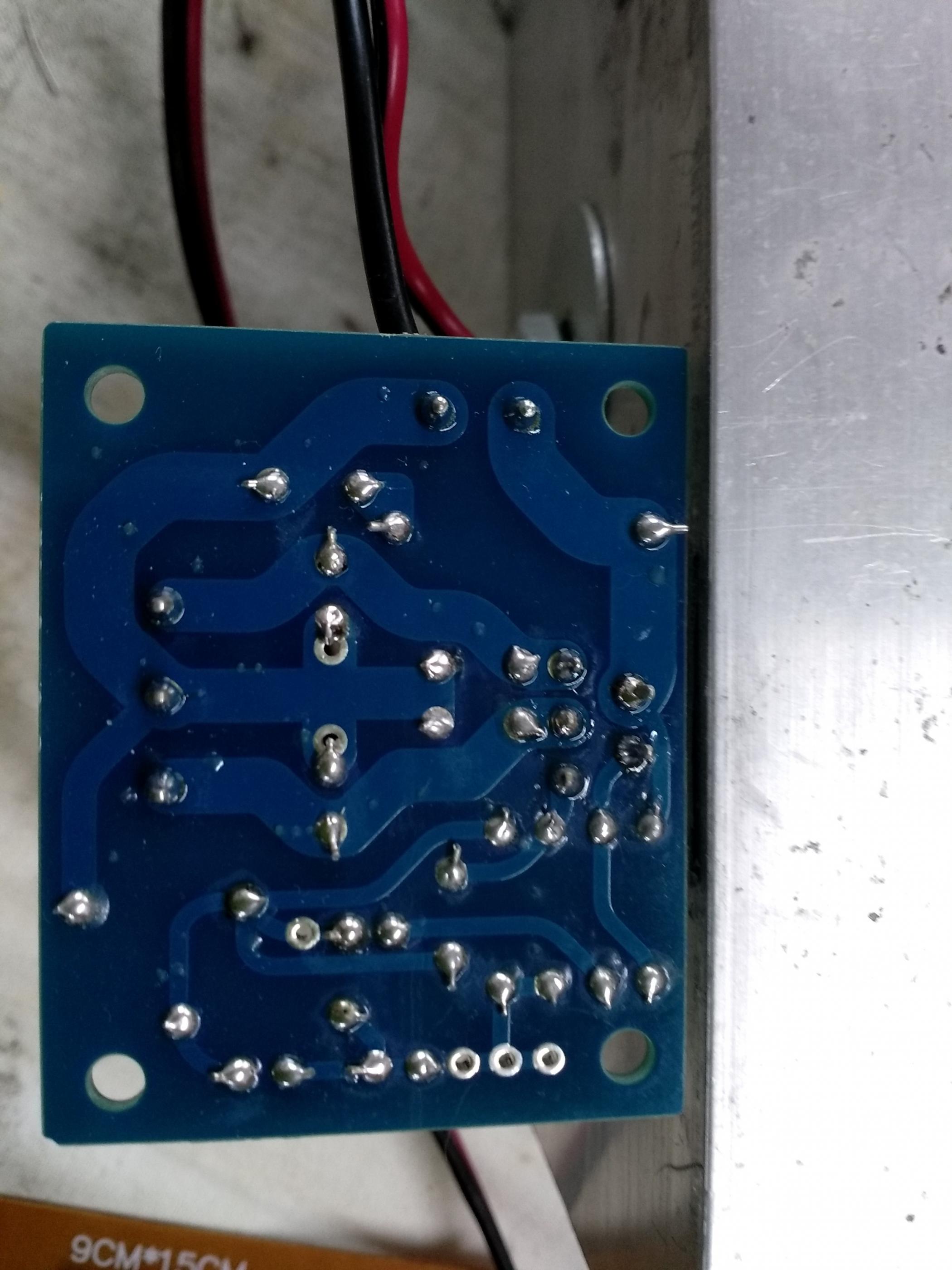

It is difficult working from pictures.
Begin at pin 1 and look really really carefully at your board and make sure it only goes to the parts it is supposed to go to. Follow each component lead and check check check.
Do the same for every pin.
Also do quick resistance checks from each pin to its neighbours and make sure you have no accidental shorts.
And another way to approach this is to remove the chip and then power the board up. Apart from the supplies you should see no voltage on any other point.
You can also check the connectivity (components) between the pins with the power removed and also make sure you read the expected resistance between the appropriate pins.
YOU MUST FOLLOW INSTRUCTIONS

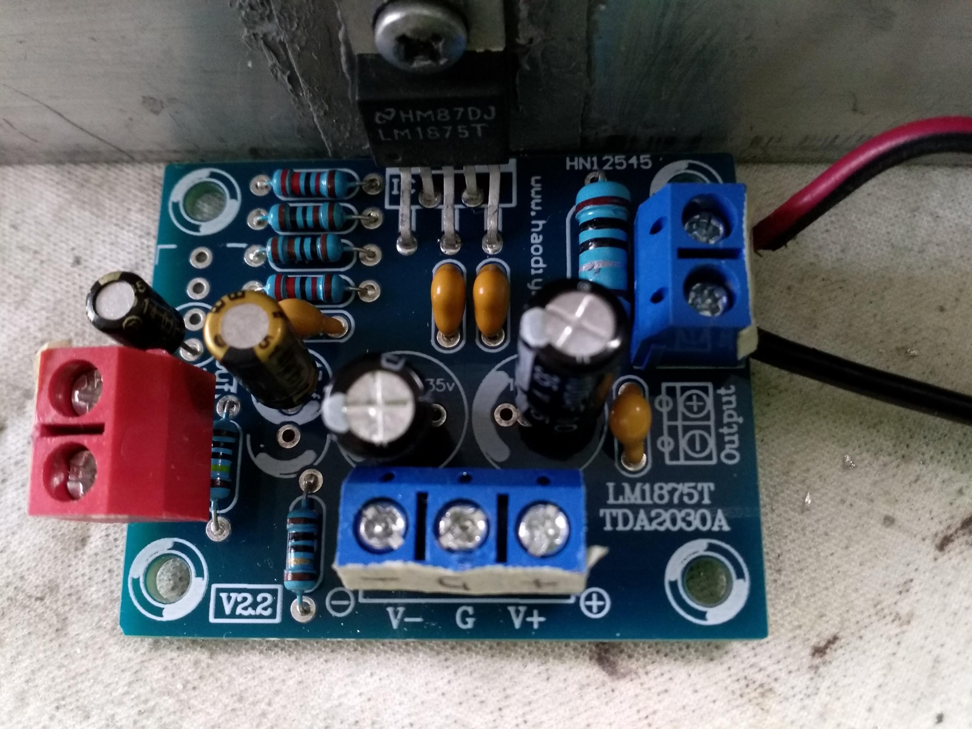

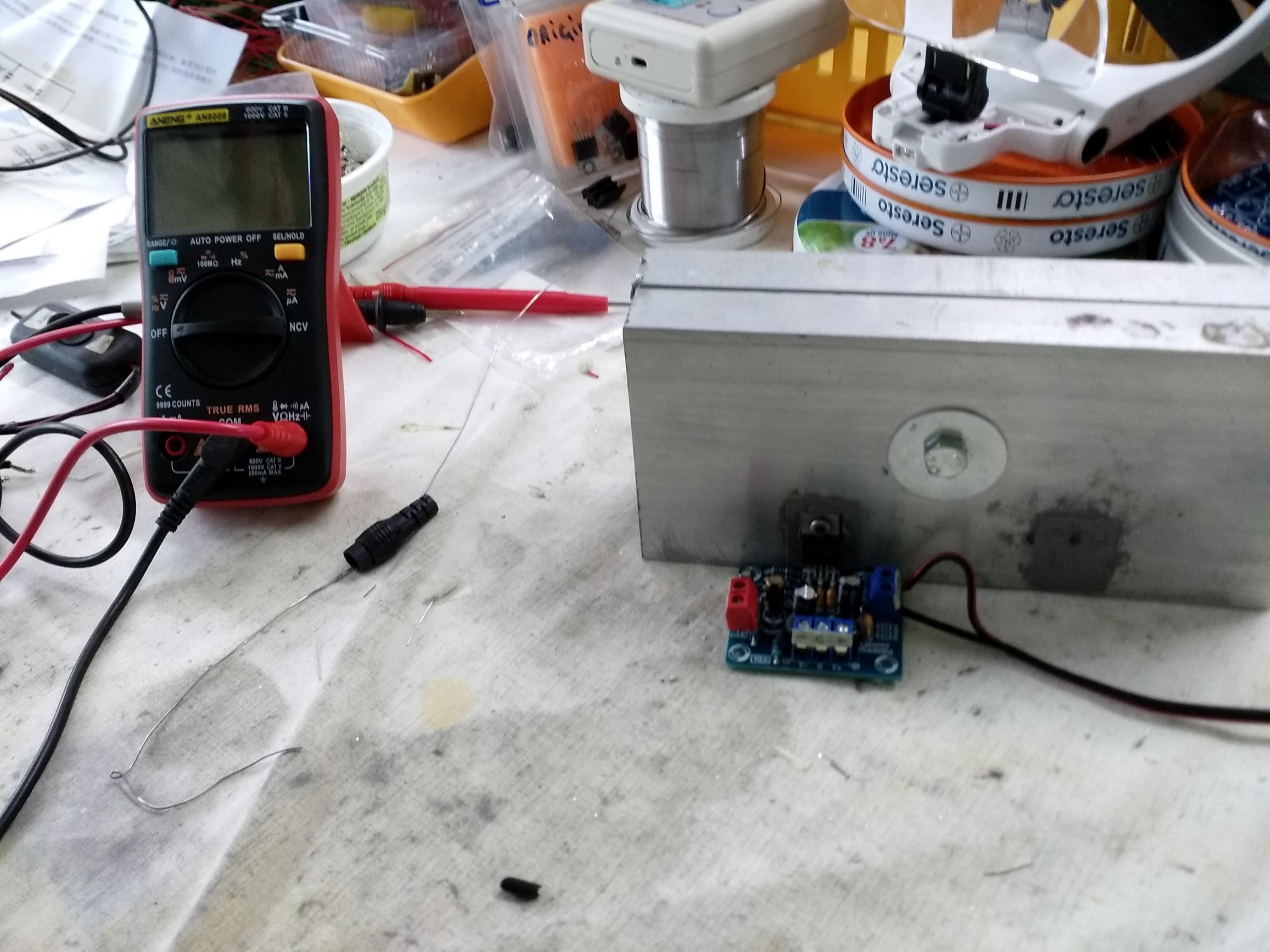

Hello everyone, here are the measurements: pin 4 is connected to 2 through a 22k resistor measuring between 2 and 4 with power supply switched on from zero,
NO NO NO NO NO
You were told:
1) turn amp OFF, wait until rails are ZERO.
If after 2 minutes you still have some residual voltage, short them to ground with a piece of wire.
<<< this is to GUARANTEE supply rails are ZERO volts
2) measure resistance from pin 4 to pin 2 using the resistance scale (200k), straight from chipamp pin to pin, post result.
POST THIS RESULT.
with power supply switched off for 22k.
What does this mean?
Switched OFF is switched OFF, period, not "for 22k"
from pin 2 to ground I give 4.7 ohm.
You mean you measure 4.7 ohm?
It´s a too low value, we would expect 22k or some similar high value.
Are you measuring with power supply OFF, ZERO Volts on rails?
UNPLUG power supply from mains, just in case you forget to turn it OFF.
the feedback resistor (22k) is connected between 2 and 4.
In theory it is connected.
I will trust pin 2 to pin 4 measurement when I see it.
Pin to pin themselves, not solder pad to solder pad. Not the same.
between pin 2 and the ground it gives me continuity (short), but also a resistance of 4.7 with the power supply off.
You are giving 2 DIFFERENT results for the SAME measurement.
Your test METHODs are unreliable and maddening.
YOU MUST MEASURE EVERYTHING WITH POWER OFF, SUPPLY UNPLUGGED FROM MAINS.

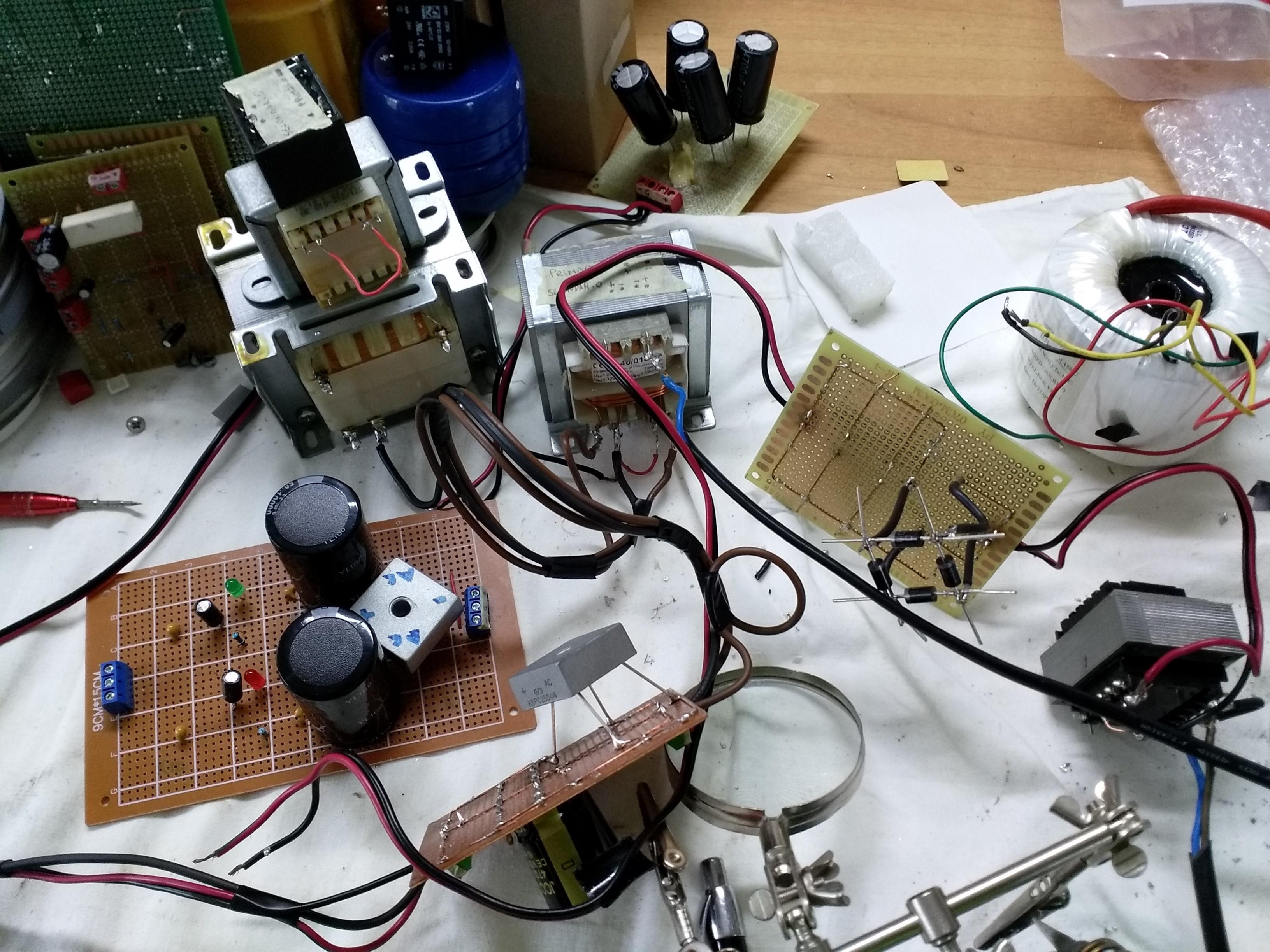

That way too large stripboard, besides huge size creating lots of dangerous antennas, is way less reliable than standard PCBs and way more error prone, because you MUSY cut tracks yourself, easy to miss one cut.
I love veroboard and in fact printed a few spare ones myself (the real one is hard to find here) for one off quickies, go figure.
I don´t even drill them , but build with copper tracks up, and blob soldering to them, poor man´s SMT 😉
I would also suggest building it point to point without a PCB, that way we can all see exactly what is connected where. The way you build it is impossible to figure out the connections.
There is no need to power up the circuit until we've had a look, and then you can go and build it in your own style.
