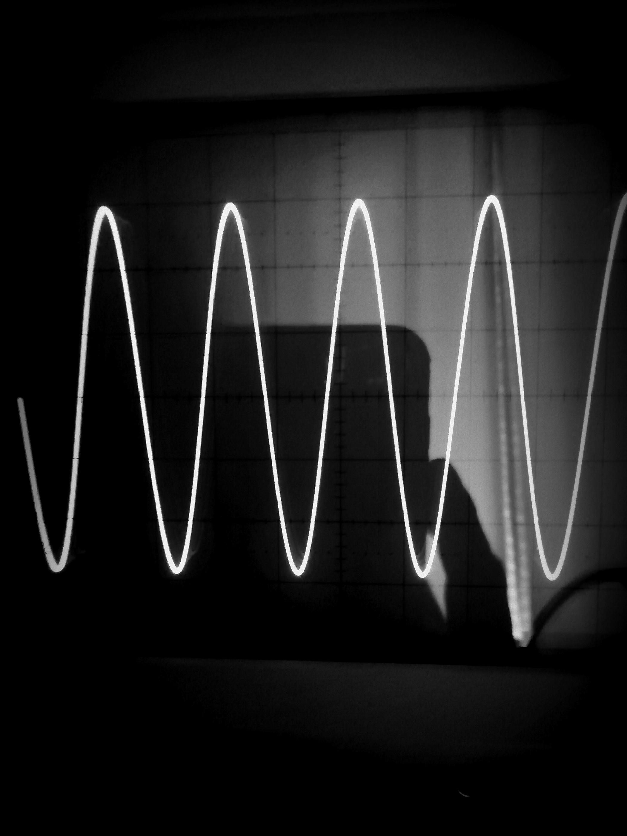

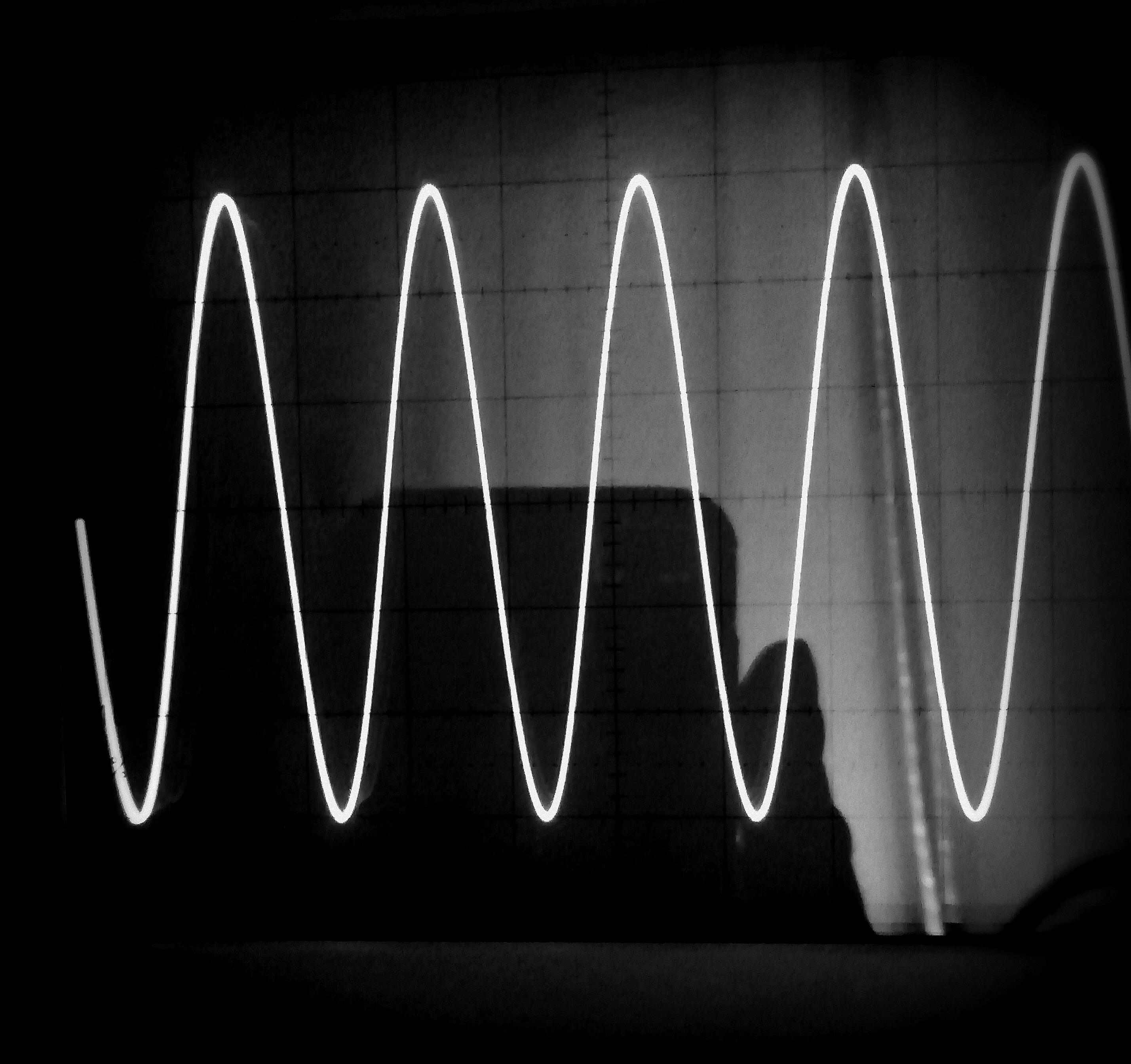

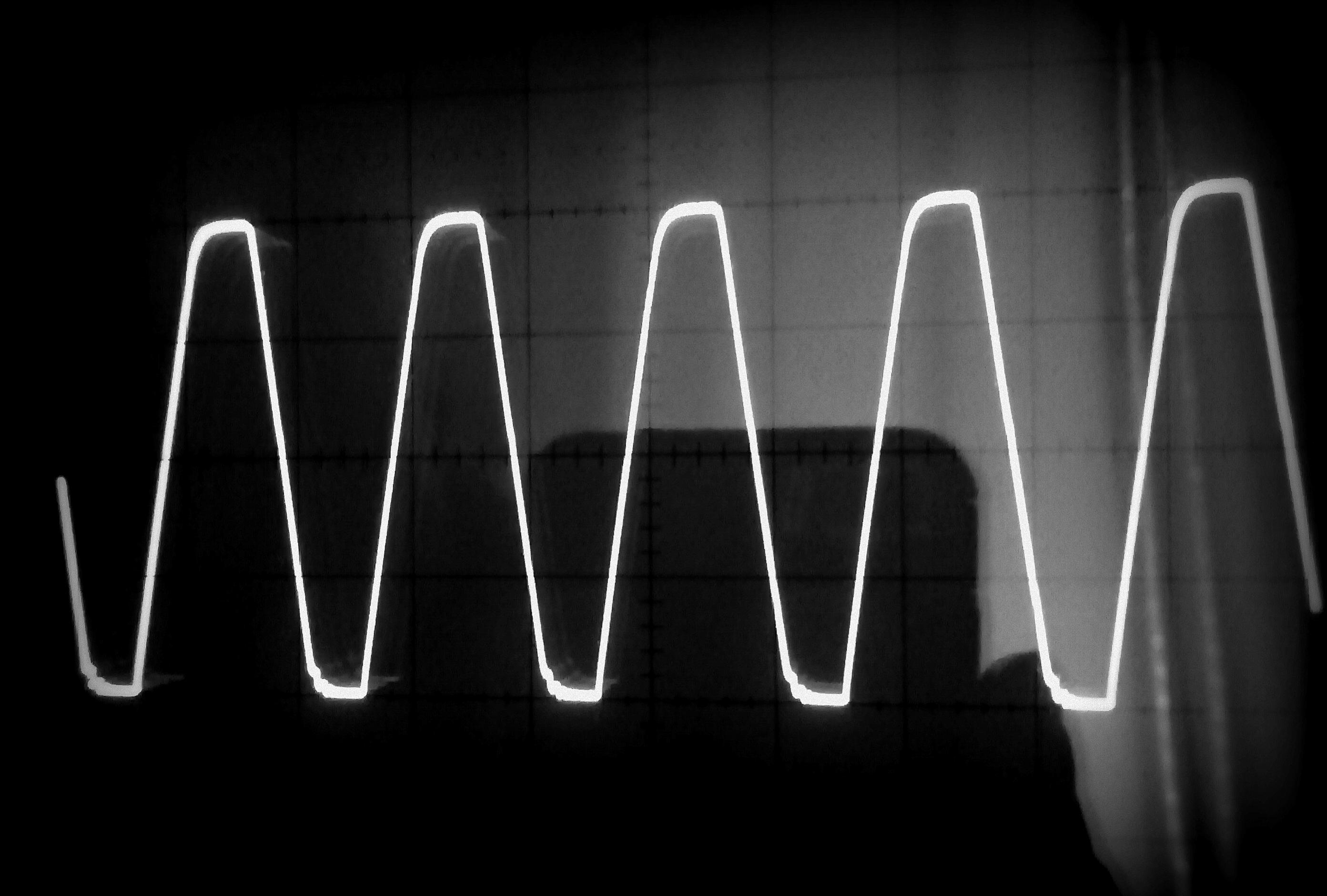

I put a +/-24Vdc power supply on the LM1875 amplifier and swapped between inverting and non inverting configuration using the same gain setting resistors. I could get to +/-20V at the chip output in the audio-band. For both configurations, the output offset was very moderate at 1mV. The inverting configuration showed a better output signal symmetry above the audio-band (square-wave at 50Khz) than the non-inverting configuration.
I had no signs of instability in either configuration.
Sorry from me and my Hameg for the mediocre photo quality.
The slew-rate is specified to 8V/us in the datasheet. It seems to fit reasonably well with my observations.
What's your input signal supposed to look like at 50kHz? Sine? Square? There's some ripple to be seen at the lower slope - is that due to clipping?

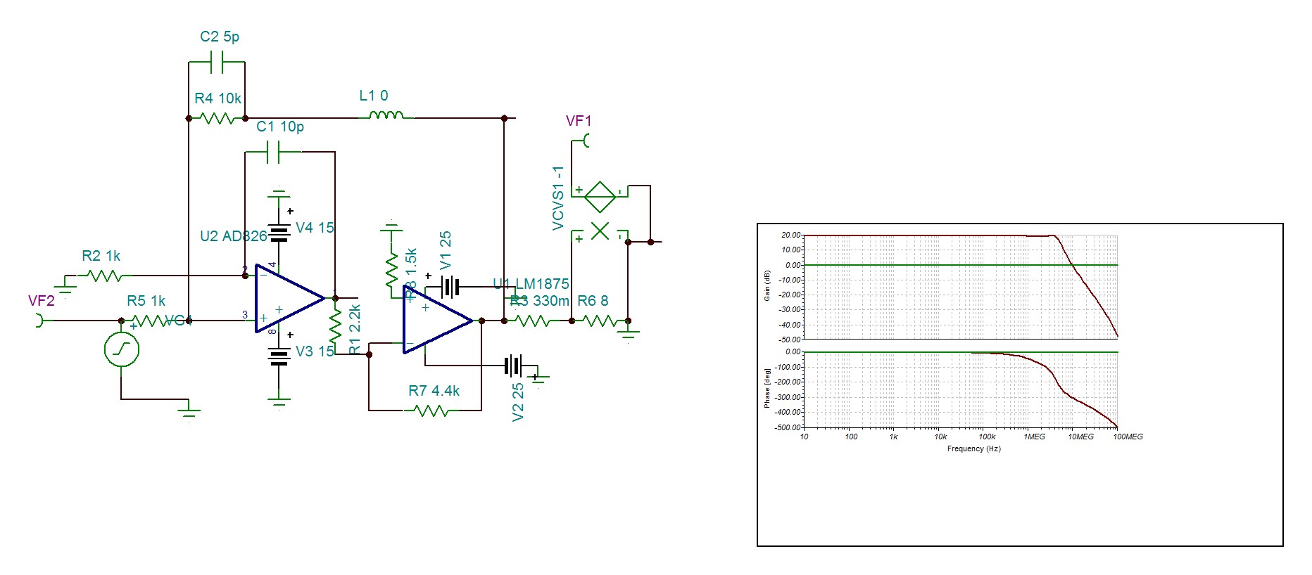

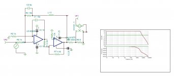

Here what may look like with inverted according to palstanturhin circuit but with AD826 . The distortion should be 2.5 times the distortion of AD826 in 2x gain . -100db 3rd .

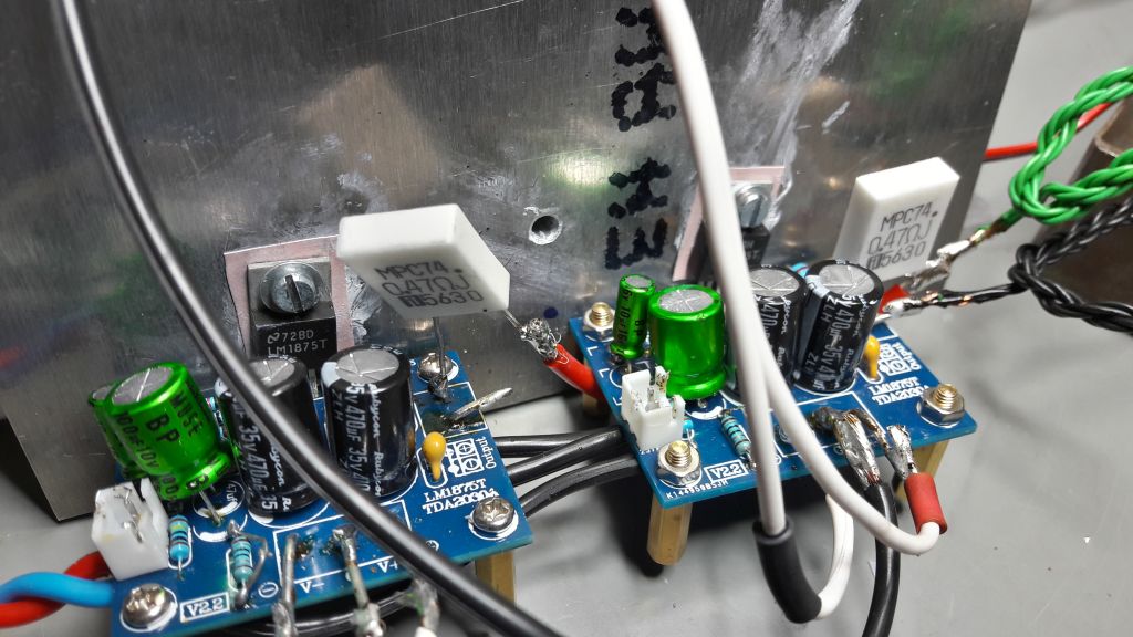

Hi guys
i do not want to disturb you 😉. as i want to show and try out by myself the parallel configuration with this LM1875 kit amp.
here it is
pic 1
this is just a paralleling the actual mono kit to build a 2x LM1875 into load of 4,459 R. ----i have to look for a lower resistor and more power it can be dissipate😀
all connection are under the PCB:
connect signal in
signal GND
power GND
output over the resistor 0,47R ---> then right to the load (4,459R)
i use just 0R47 5 Watt resistor what i thought thats ok for the first test

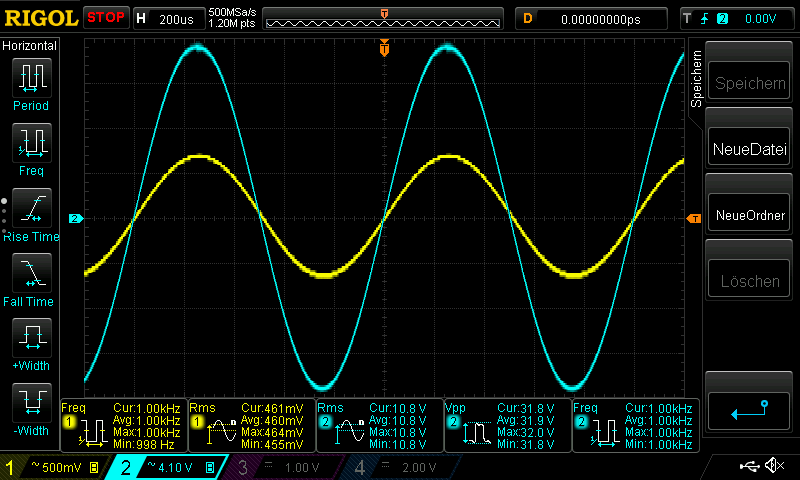

pic 2
+/-20V supply at my Rigol PSU - input 510Vrms-10,8Vrms no clipping --> 26,15Watt- 2,42Amp into 4,459R

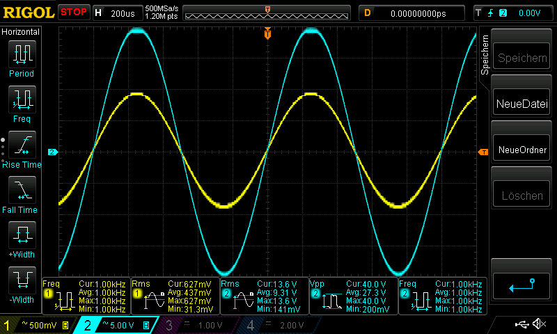

+/-25V supply at my Rigol PSU - input 640Vrms-13,6Vrms no clipping --> 41,48Watt- 3,05Amp into 4,459R
pic 4
+/-27V supply at my Rigol PSU - input 680Vrms-14,5Vrms no clipping --> 47,5Watt - 3,25Amp into 4,459R

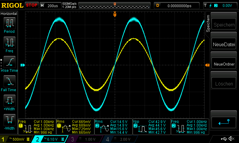

pic 5
+/-27V supply at my Rigol PSU - input 760Vrms-15,9Vrms no clipping --> 56,7Watt - 3,565Amp into 4,459R

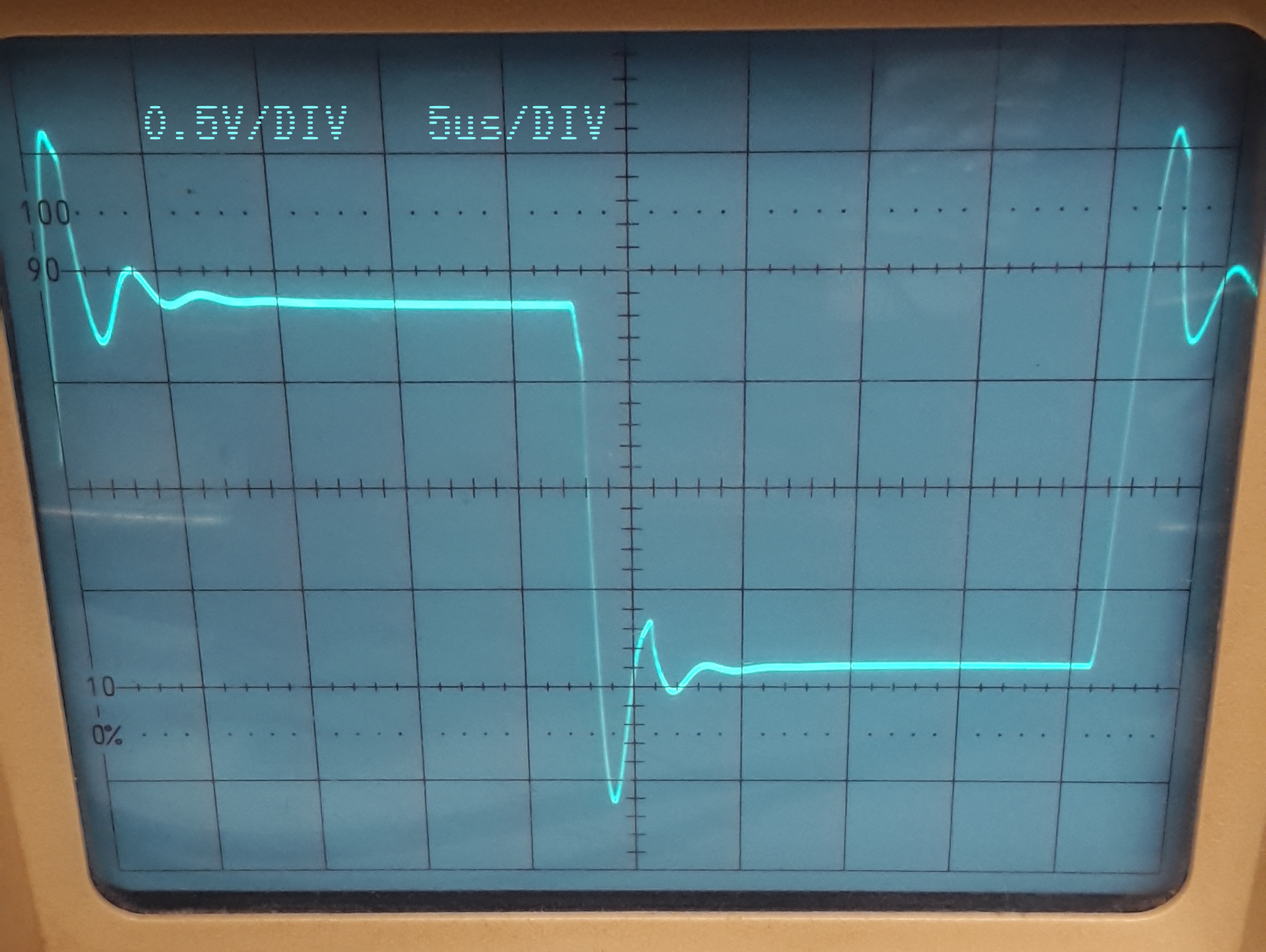

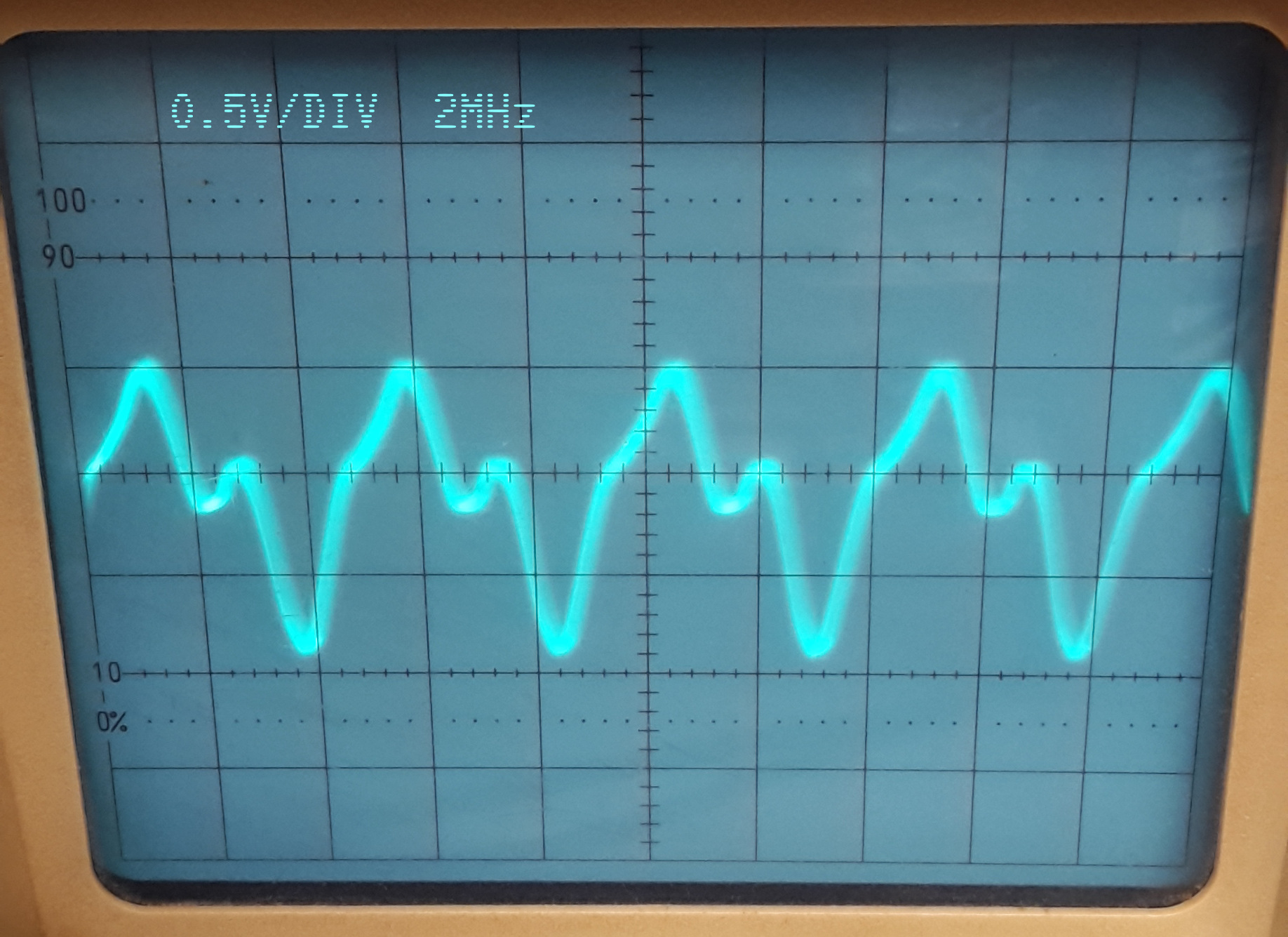

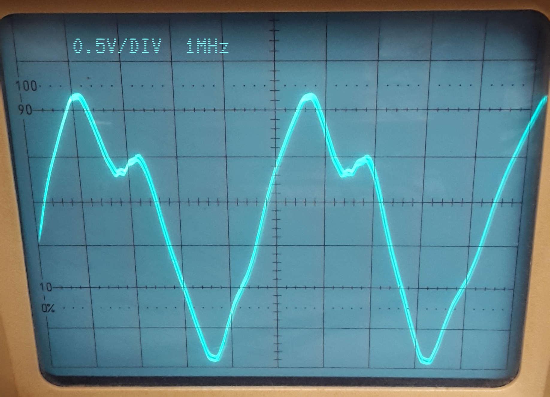

I have received my LM1875's today. The first one I tried was DOA; output was clinging to negative rail with some little oscillations visible, but no measurable short. The second one worked as expected, but unfortunately it seems to be only marginally stable with 6dB gain. The square wave response at 2Vpp into 8R shows some 40% overshoot, which is quite a bit too much I think. Adding 100nF to the output makes the square wave ring like a bell.
Next try will be to re-wire my prototype to the inverting configuration.

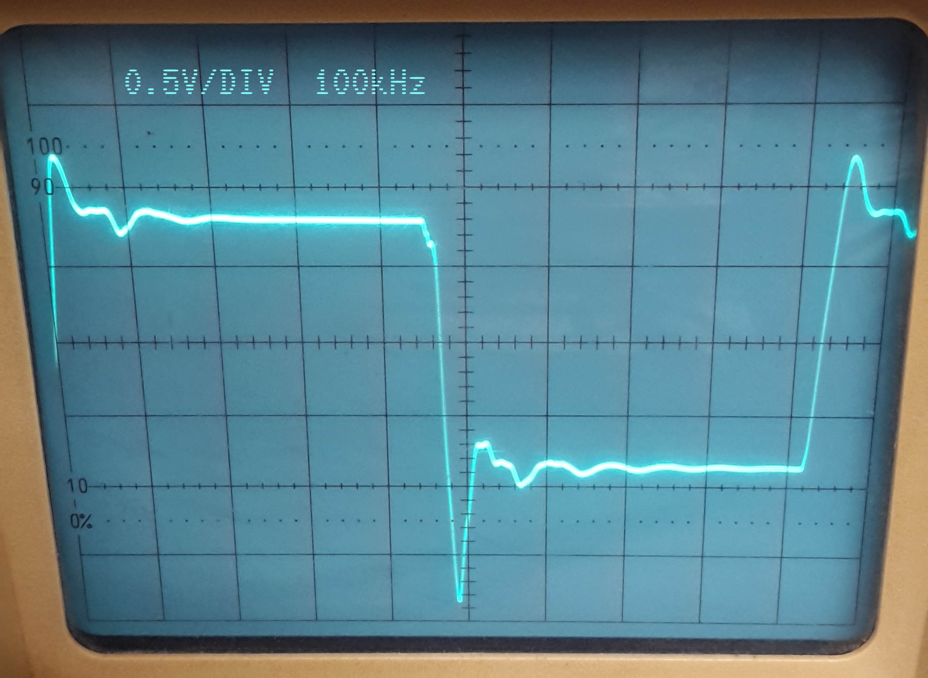

hi Preamp
can we see some scope pics?

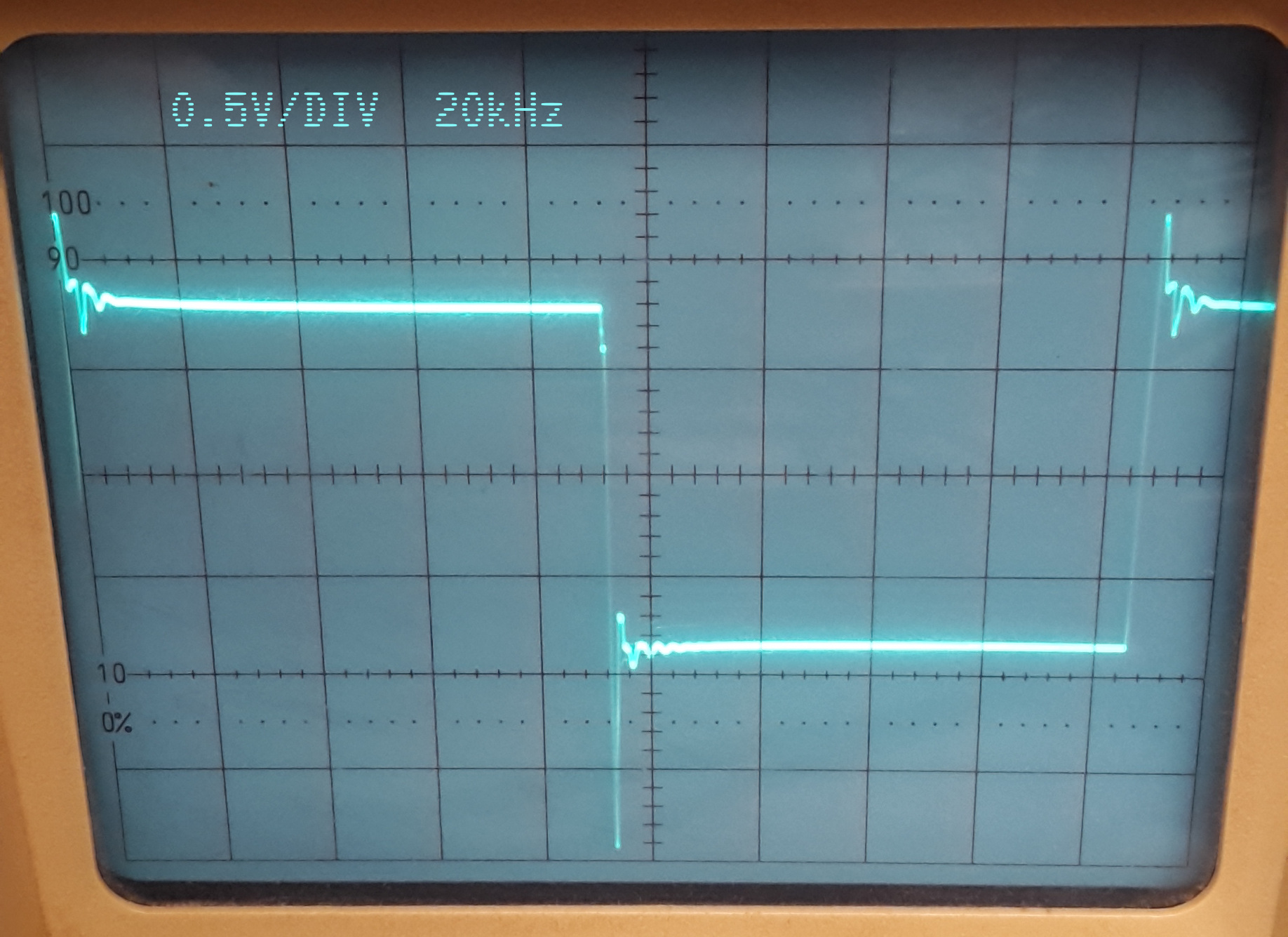

I had hoped to get around this, but here you are. 20kHz square wave at almost 2Vpp into 8R.
thx
Quickly tested the inverting version while I was at it. Used 1k at the inverting input and 2k as feedback resistor, with the non-inverting input tied to ground via a 10R resistor which was fetched from the scrap heap.
Doesn't look that good either. The ringing is damped much better now, but the spike on the negative slope is much more severe. What's more, this configuration has a huge power bandwidth up to and beyond 1MHz without any noticeable amplitude reduction, which might pose some problems...

Good work, Chris. You are in the lead.
56W in 4 Ohm (close to) means 110W in 8 Ohm with a BTL version. When you can handle the current, bridging is rather trivial. Parallel configuration of two chips doubles the current handling but quadruples the power capability. This is why paralleling is a good trick to master when you want high output levels
Also I have the problem that my power resistor gets really hot in no time.

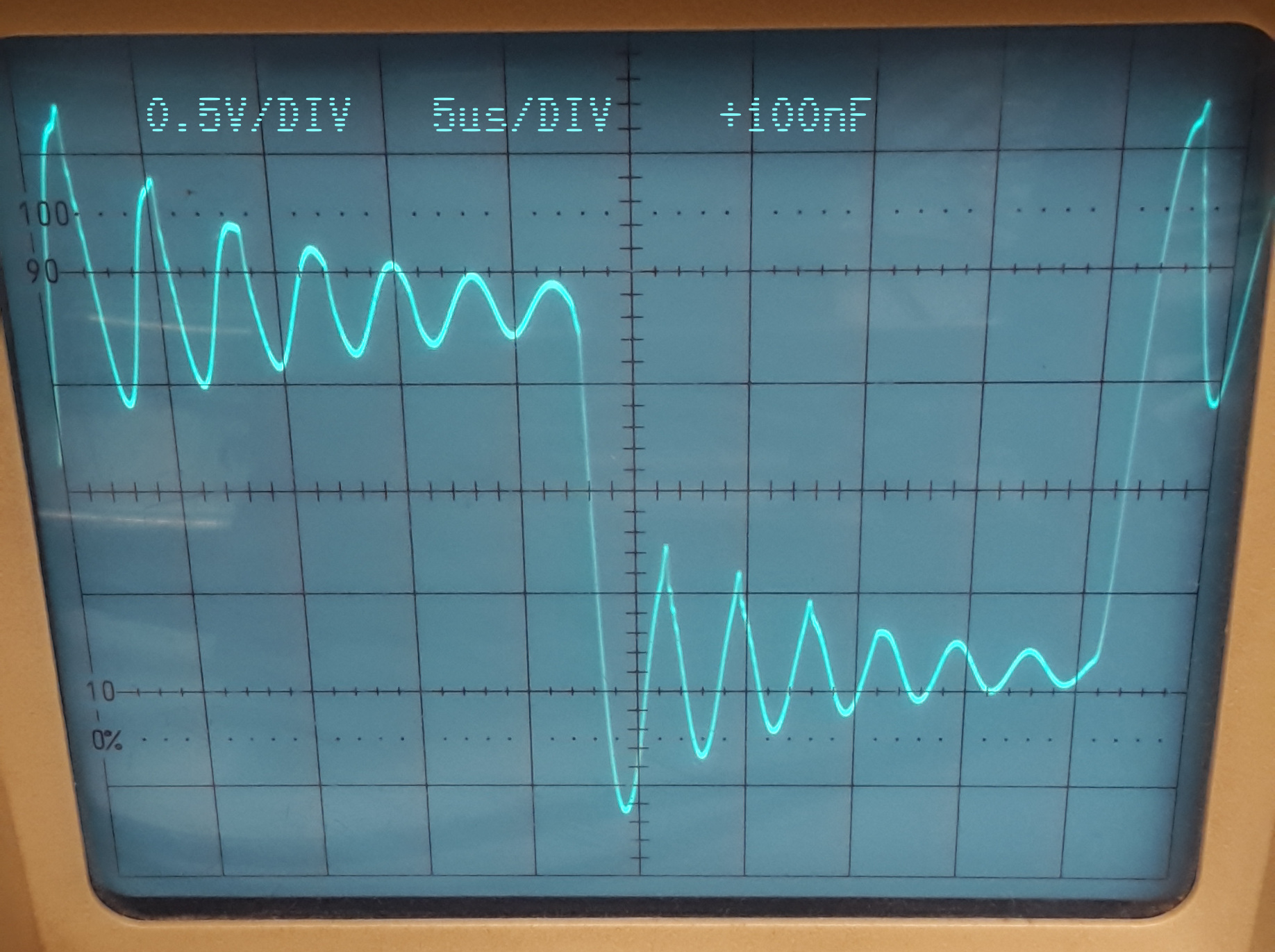

True, not a very pretty sight. You seem to be very much on top in general so you have: 1) Very short leads on your power rail decoupling? 2) 100nF HF decoupling of the power rails? 3) Very short leads on your feedback resistor? 4) Short leads on your Zobel-network?
LM1875 is not very forgiving when the leads are not short.
