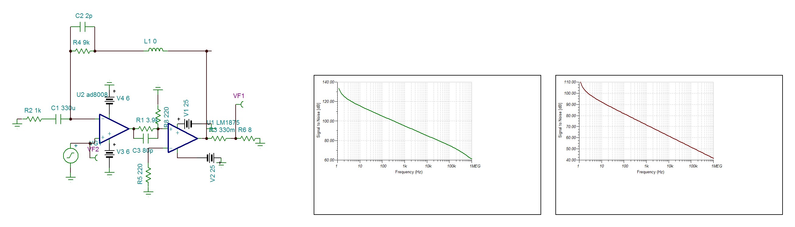

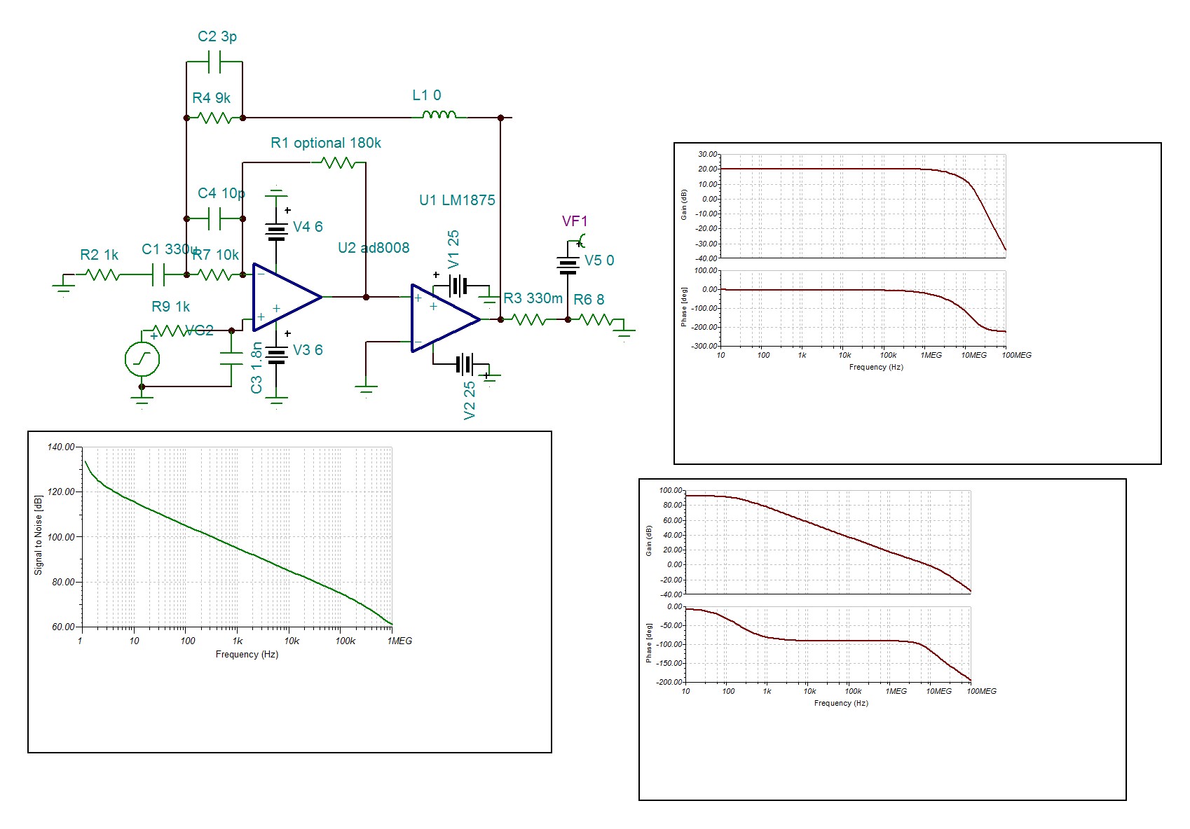

palstanturhin , you were right to ask noise simulation. Indeed LM1875 is rather noisy . But by the original composite circuit adapter for AD8008 , it falls 20db . I suppose the Dtot also decreases by the same ratio. I posted bellow the comparative simulation . My precedent "second option " have 10db higher noise for identical transient response. So we forget all and restart with a proven version.
Good work, Chris. You are in the lead.

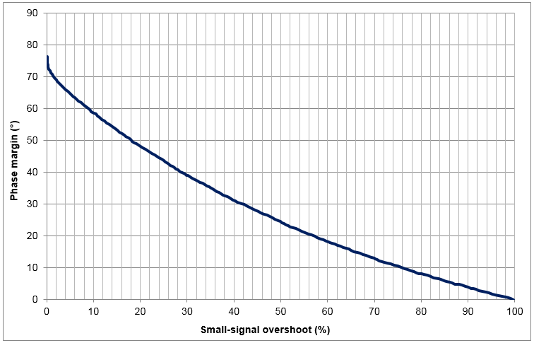

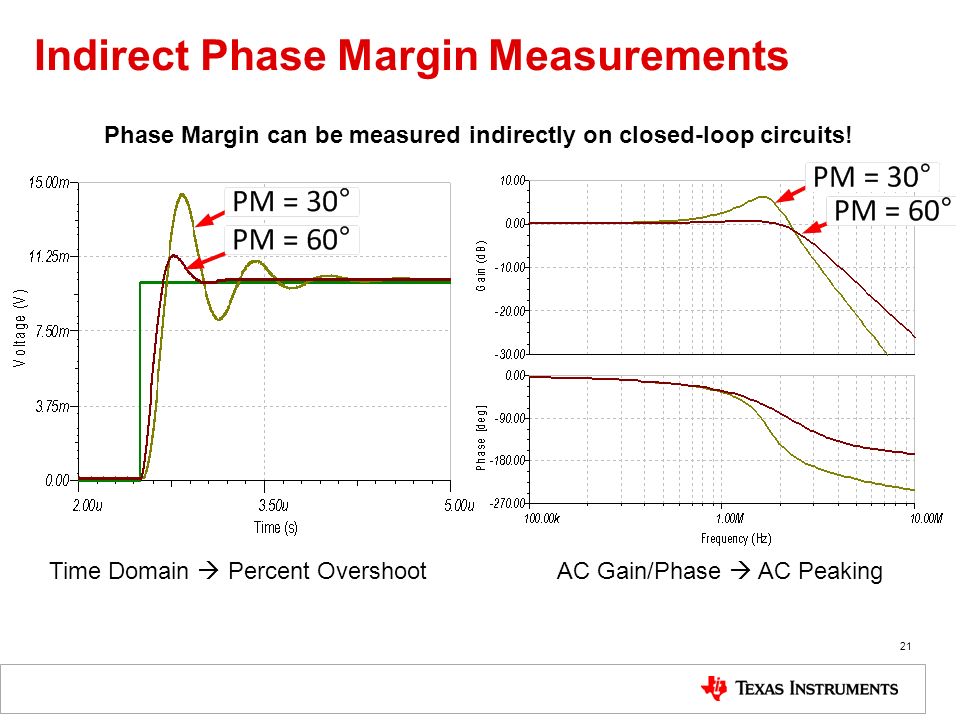

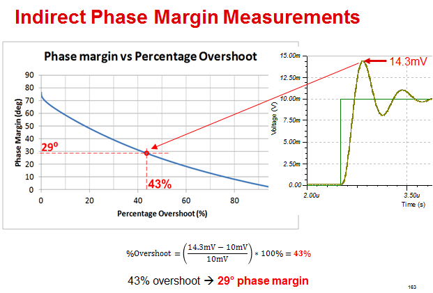

Found some nice graphs regarding phase margin and percent overshoot:
simplified and re adjusted of the preceding version. The noise is measured R1 . The frequency response is limited to 100khz to avoid slew rate mismatch problem. All now is needed to know how to parallel. If it is paralleled pin to pin , then the one with higher gain will pull more than the others . Thanks to FF's observation that at high power the 1875 oscillates , it means the Hfe of the outputs at high currents decrease, by this the other ones deliver more . This is the same phenomena as a carriage pulped by several horses . If one is more energetic than the others , it will pull the carriage alone but it will get quickly tiered, easing himself to let the other pull as much . All need to know what is the output impedance of LM1875 without feedback. The simulator gives a constant 0.1 ohm but it is not realistic.
Power dissipation . Each amp drains 100ma at quiescent says the datasheet. With 50V supply, it dissipates 5W . But , on figure 9 ,4ohm and figure 10, 8 ohm it shows 10W and 8W dissipating. Can someone explain? If we consider 5W , then 4,pairs of it needs to dissipate 40W . With my experience with class A amps a heat sink of 8 inchs wide 4 inches high with about 4cm thick , at 30°C ambient rises to52°C . The good news is that the power dissipation remains near constant with power if each amp gets the load 16 ohms with 50V supply.

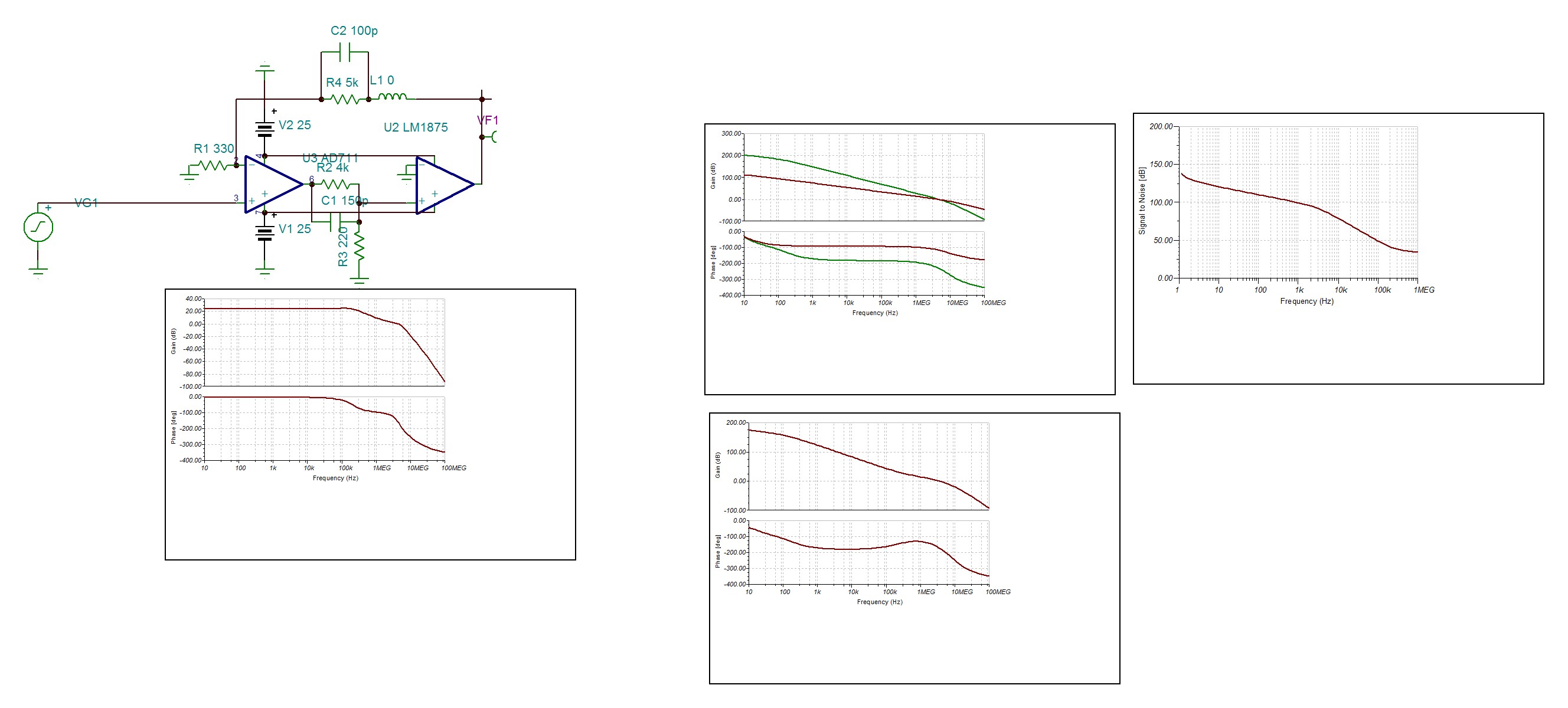

Here is the sim of the article circuit. The upper right is the open loop response of ad711 and 711+1875 without intermediate network , notice 180° phase shift above 1kHz. Bellow right is with network. Left, in closed loop . Compare it with mine .

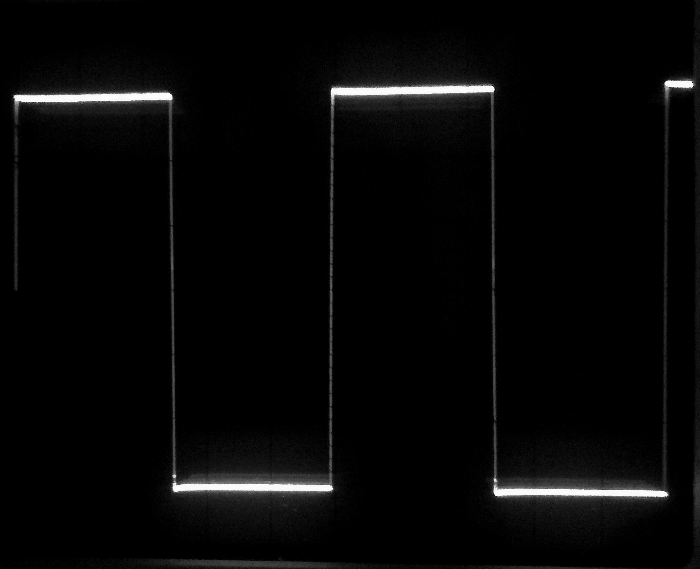

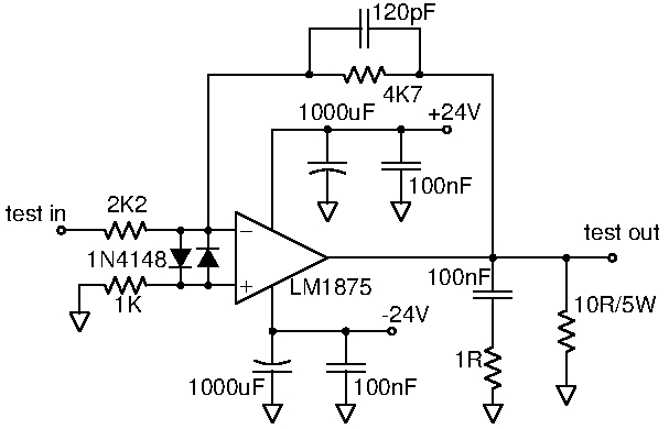

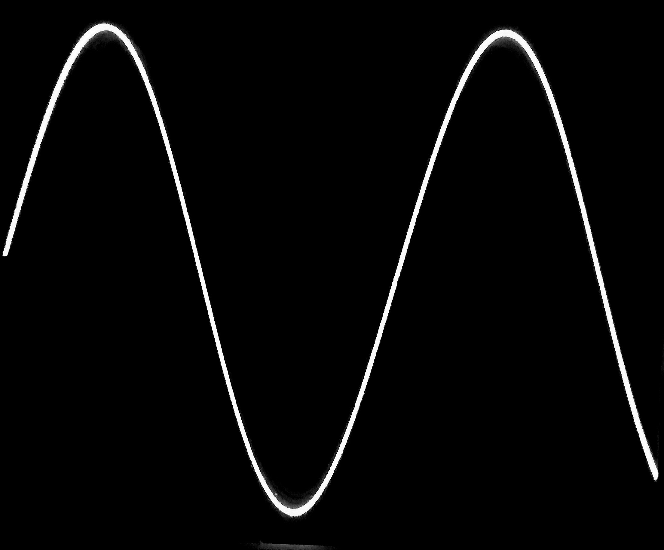

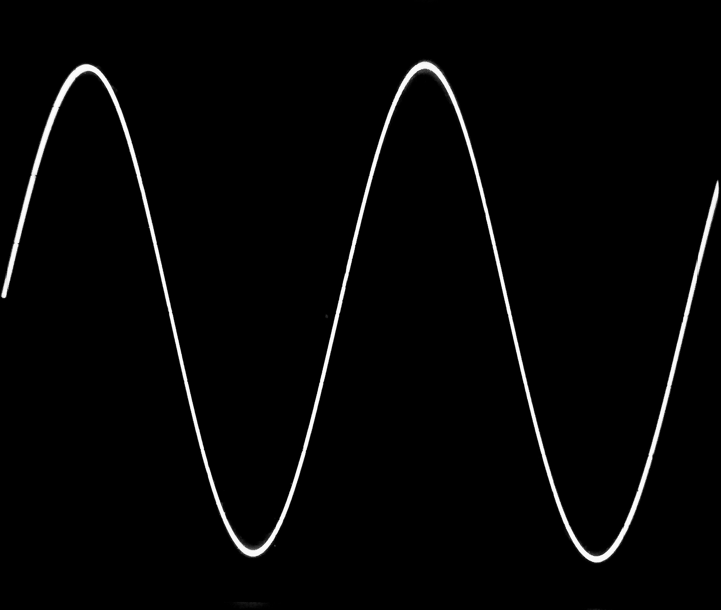

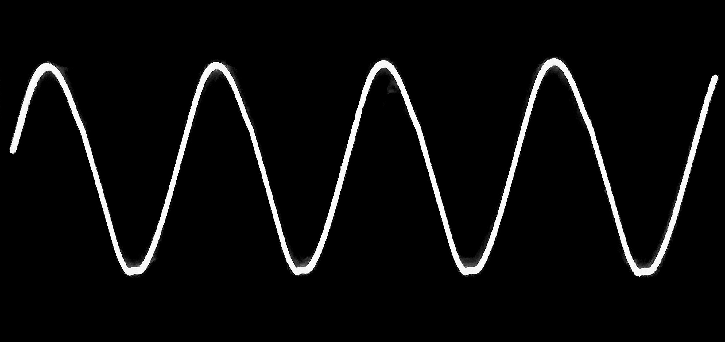

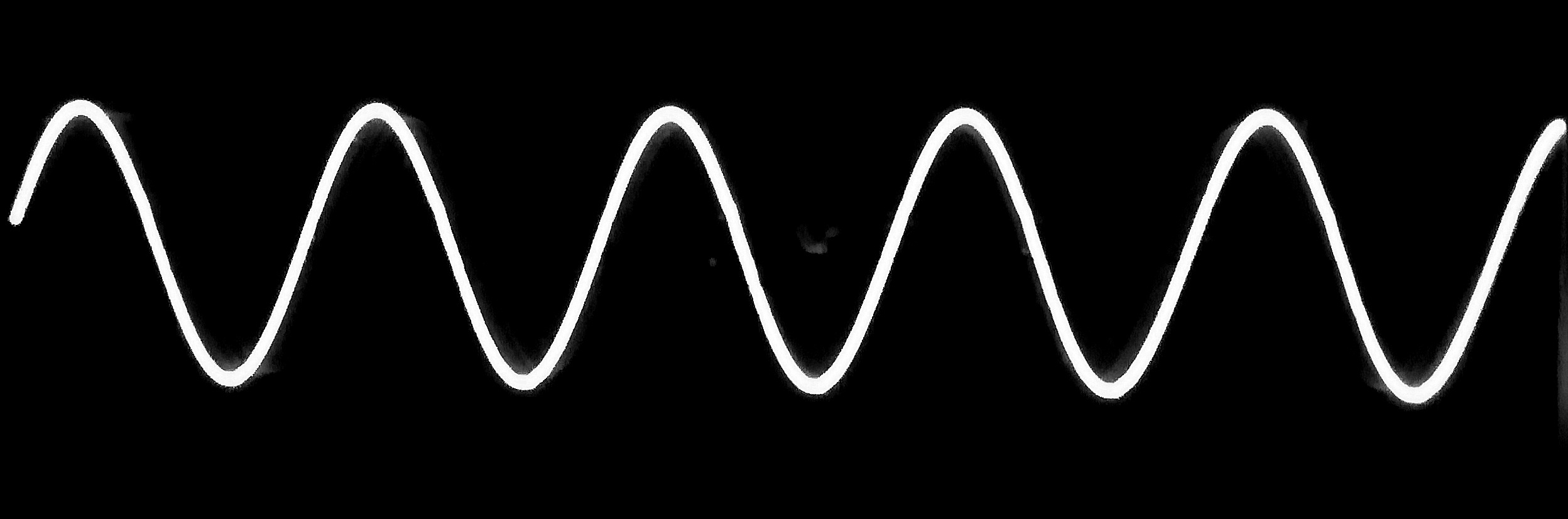

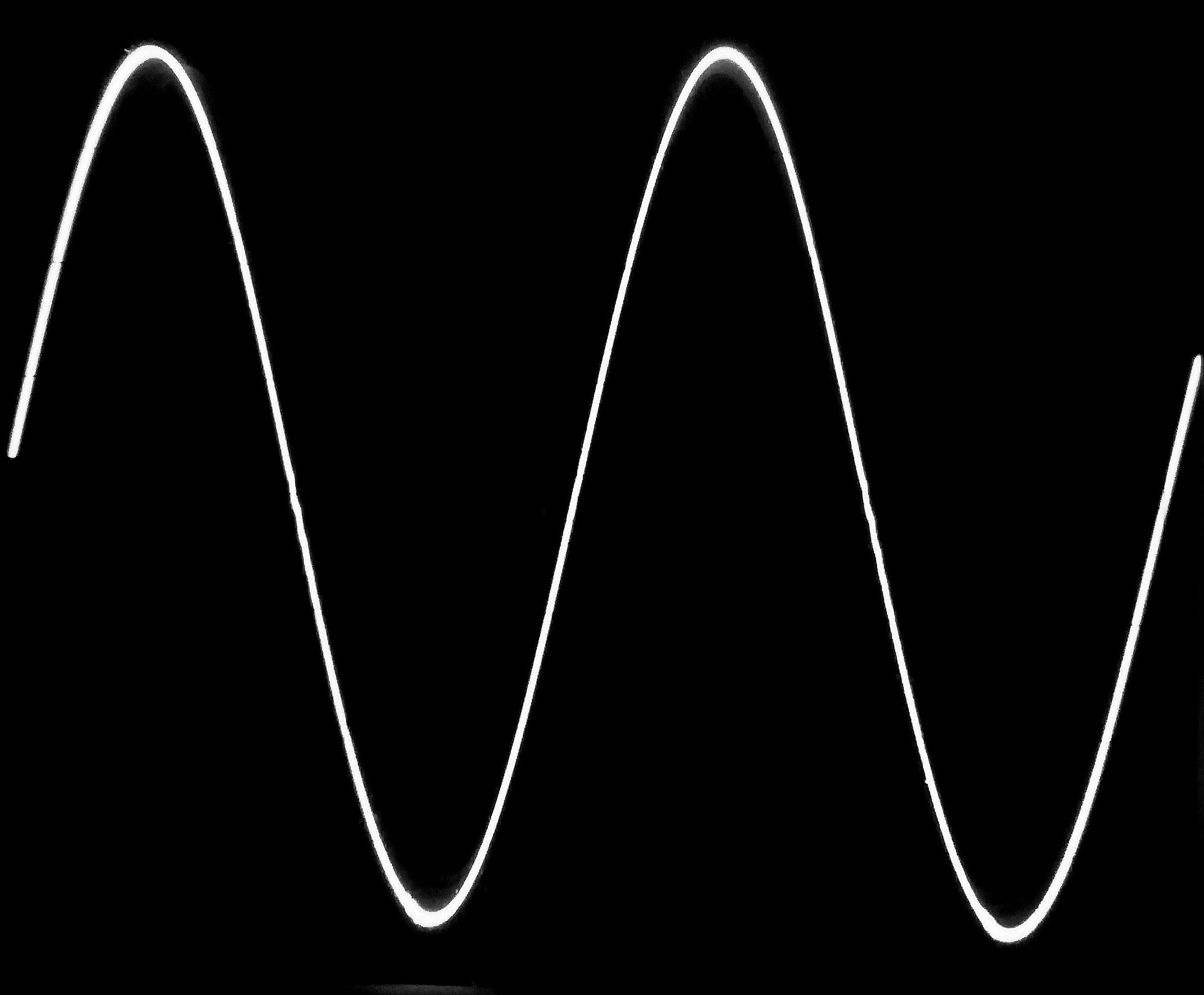

Before moving on with modification of my LM1875 breadboard to test the LM1875 configuration in the composite amplifier article, I decided to document some last results of the LM1875 with inverting coupling and a gain just above 2 times.
Output curves:
1KHz - 36Vpp sine-wave (a bit below clipping at +/-20V)
1KHz - 30Vpp square-wave
8KHz - 36Vpp sine-wave (a bit below clipping at +/-20V)
8KHz - 30Vpp square-wave
20KHz - 36Vpp sine-wave (a bit below clipping at +/-20V)
20KHz - 30Vpp square-wave
100KHz - 10Vpp sine-wave (output amplitude limited by the slew-rate)
100KHz - 10Vpp square-wave (output amplitude limited by the slew-rate)
200KHz - 6Vpp sine-wave (output amplitude limited by the slew-rate)
That's looking really nice, much better than my results! Adding some pF across the feedback resistor just made things worse. Makes me think that my LM1875 are anything but genuine... or that my prototype is sufficiently insufficient 😱.
The non-inverting version with lowered resistor values (100/180) is pretty much the same.

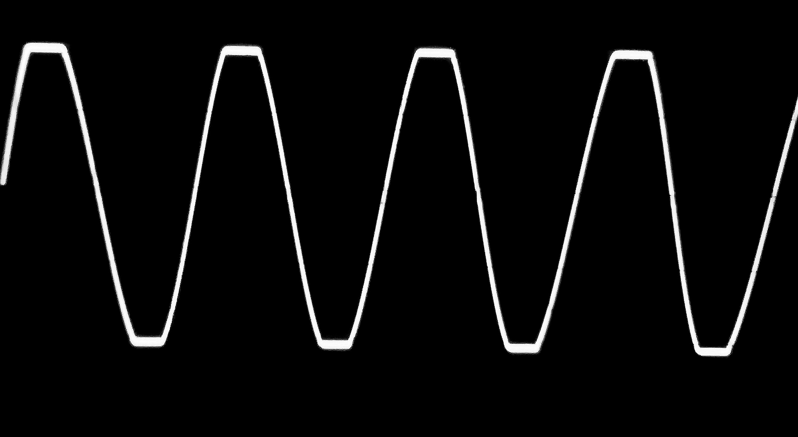

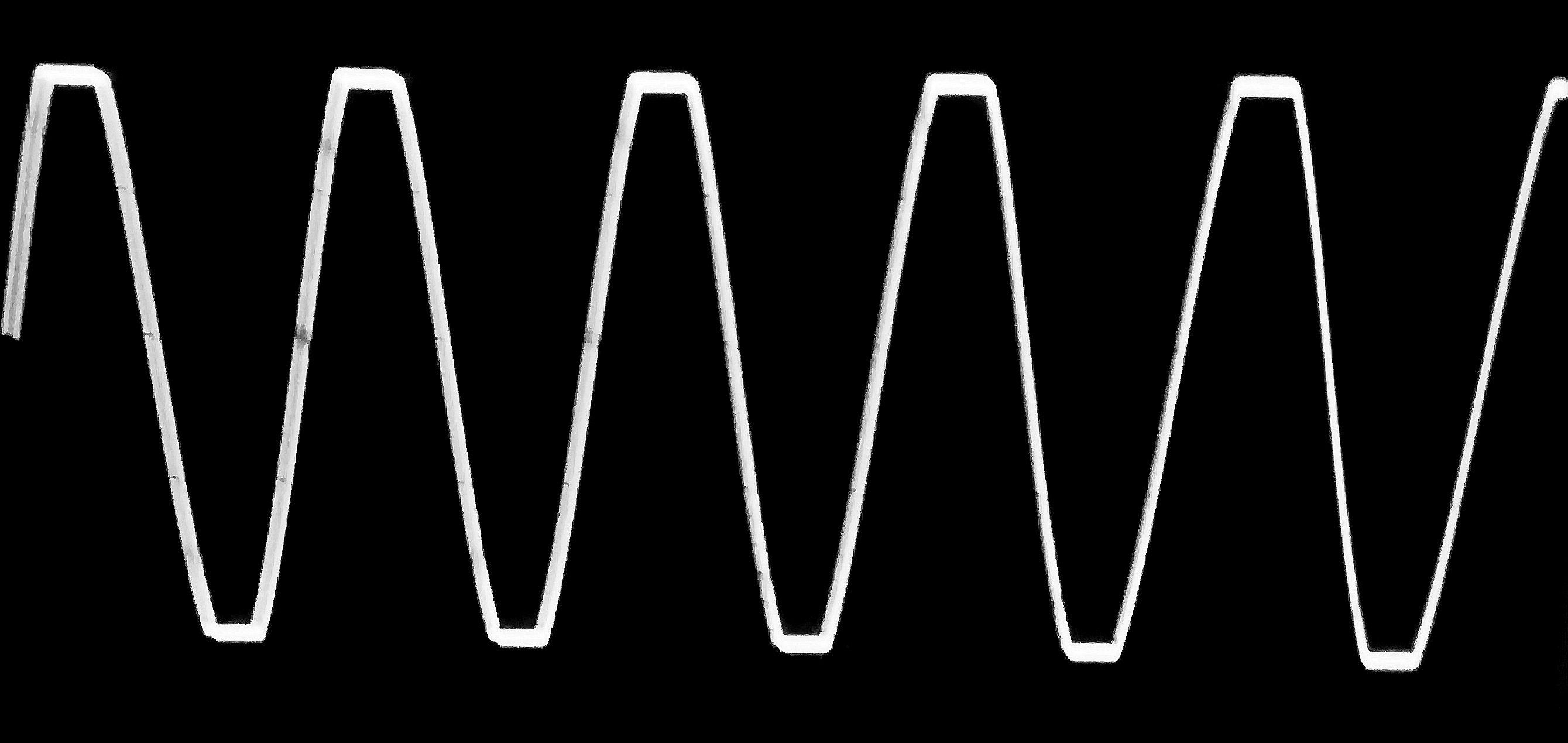

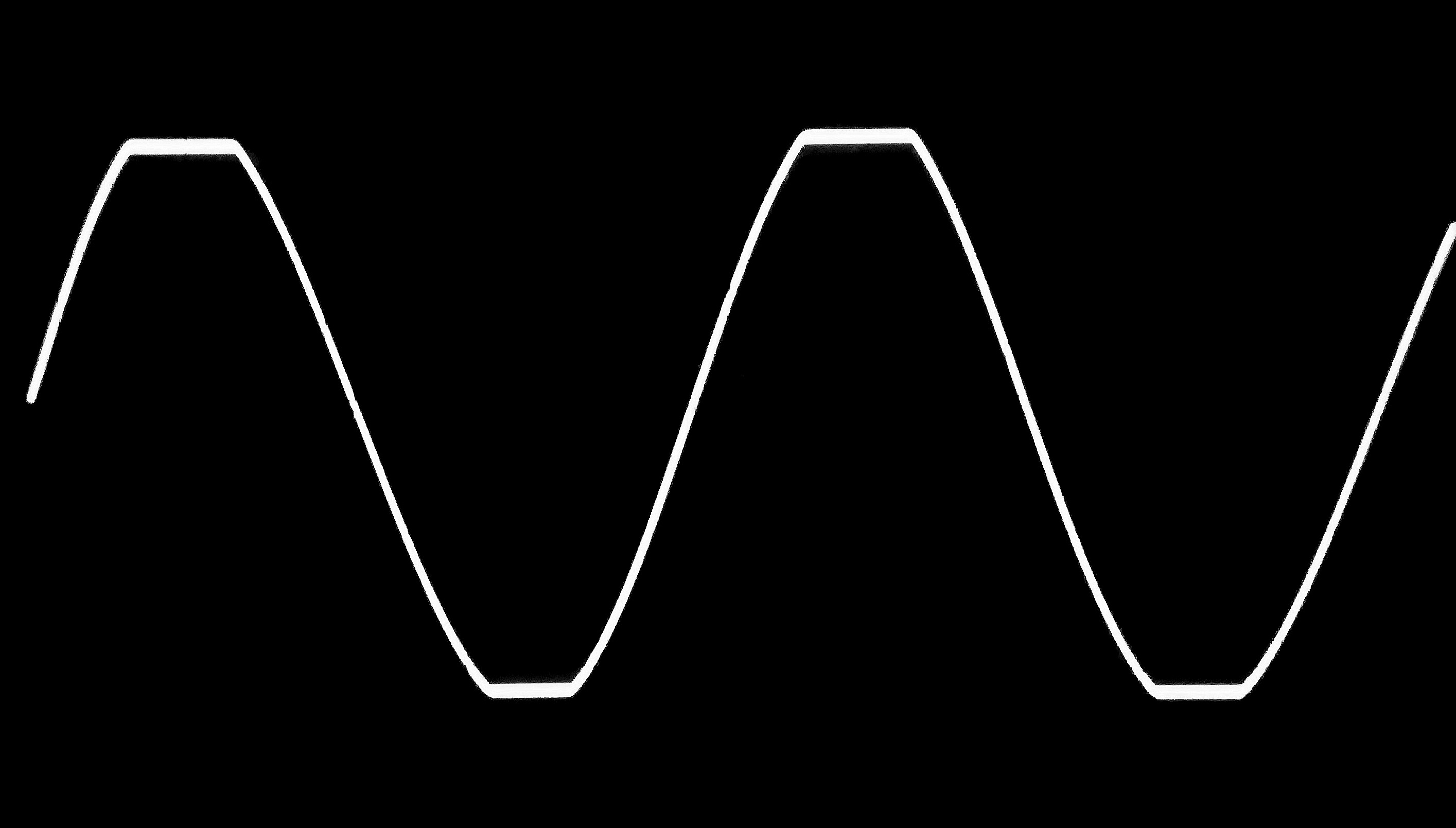

Could you do clipping tests also, just to see what happens.
That may be of interest when deciding which stage should clip first, the 1875 or the opamp?

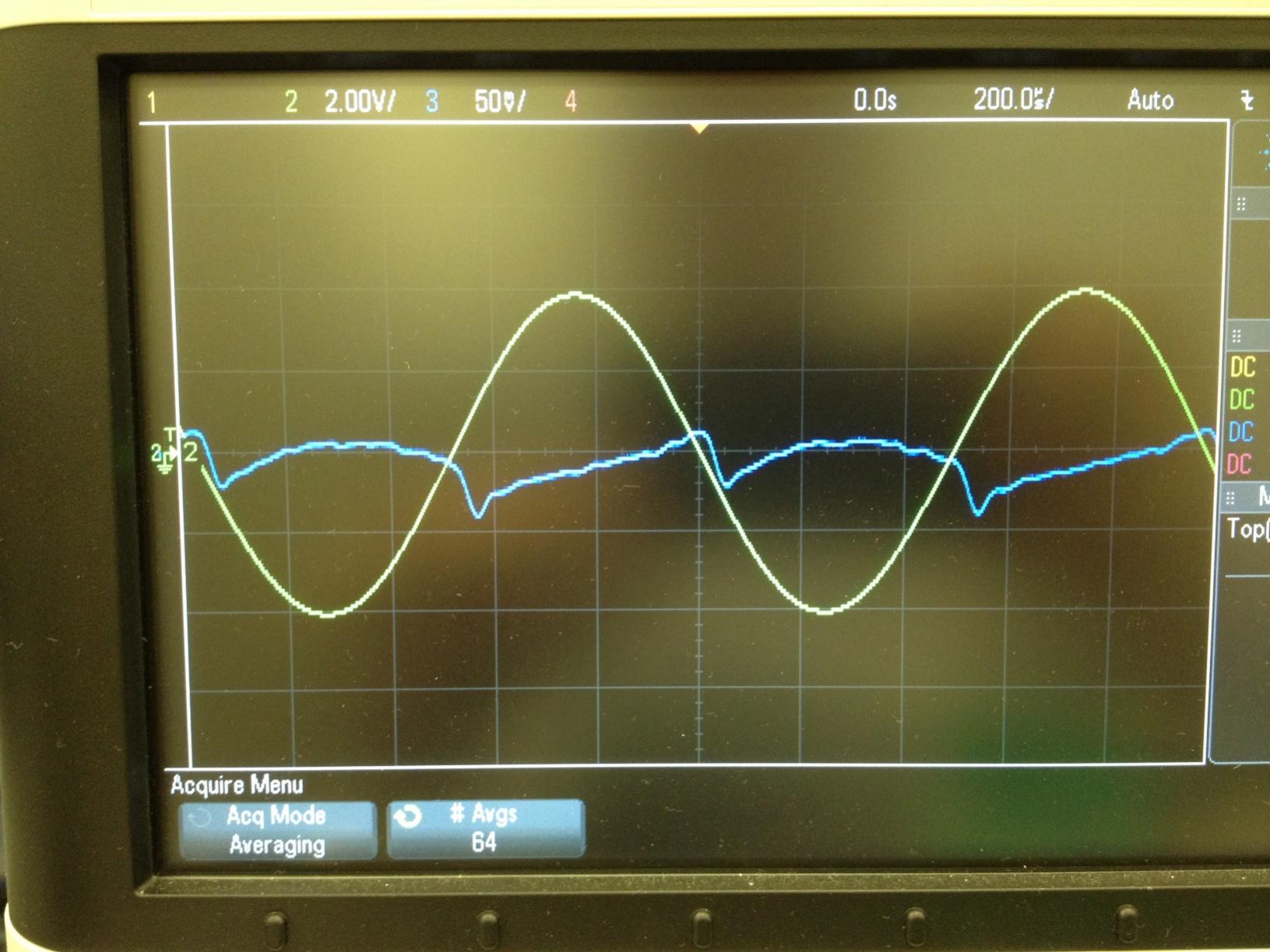

FF, can you apply a pot. From input to output and adjust for null to see the shape of the distortion for 1 kHz 1W. Joyeux Noël.

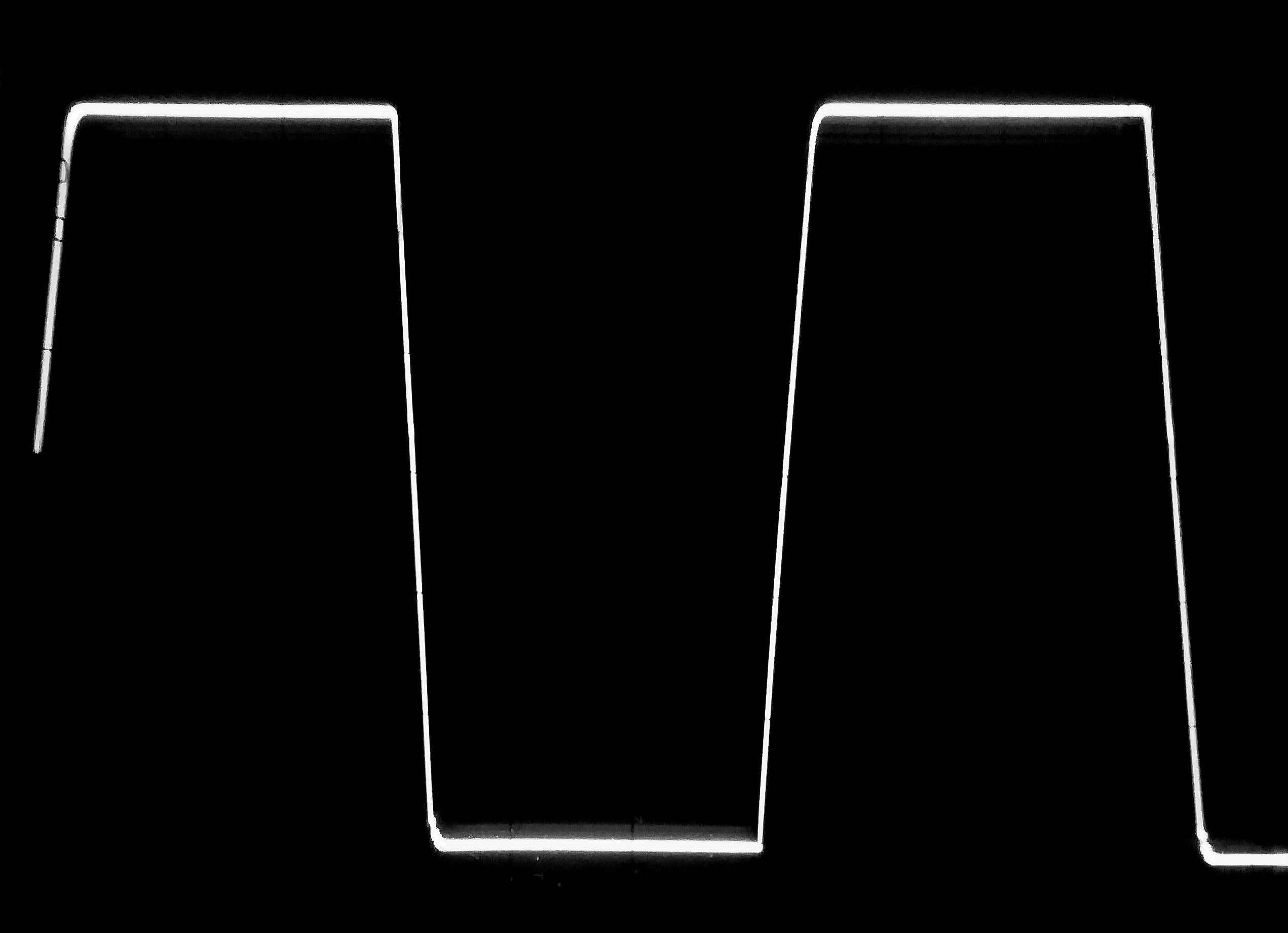

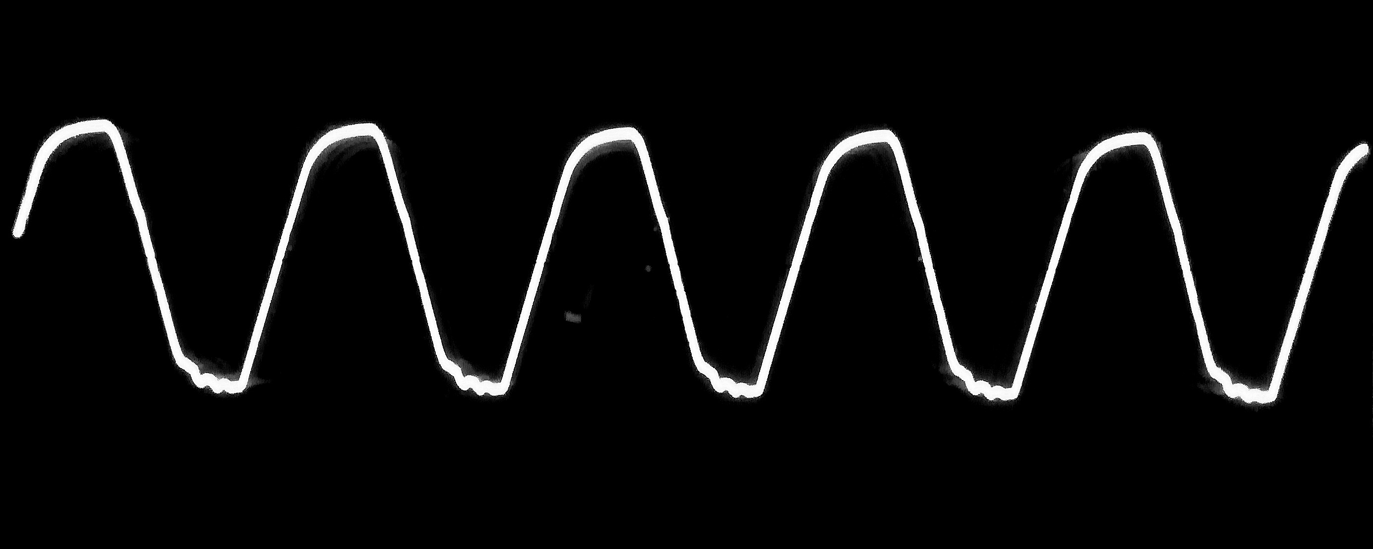

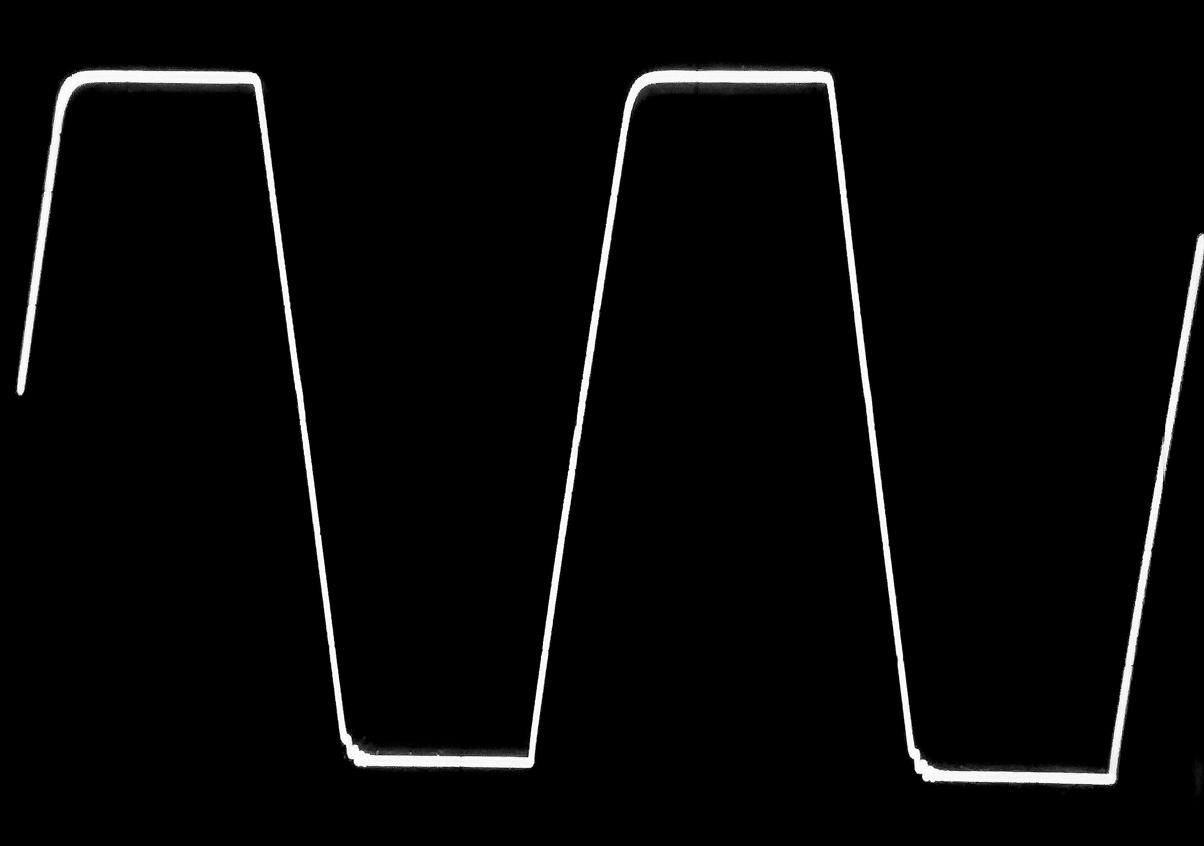

The easiest first - clipping wave-forms. Done at 1KHz, 10KHz and 20KHz. For all, clipping at +/-20V (40Vpp). 10KHz photo not very sharp.
For the time being I only have an LM1875 on test, no OP-AMP. So, it is obviously the LM1875 that "clips". This is why I want well controlled fixed gain in the power amplifier such that I know the amplitude range of the OP-AMP during operation (no OP-AMP clipping).

Kokoriantz, I had to read your request twice to understand your aim. Am I right in that you wish to subtract the output signal from the input signal such that you (ideally) can see the distortion component? Be aware that my signal generator is an "Instek" with a THD of 0.1%. I guess that even 0.1% may tell you something about which harmonics are dominating? I do unfortunately not have a spectrum analyzer but if I use my Hameg with the input signal on one channel and the output signal on the other channel, subtract the two channels and adjust the sensitivity of the two channels for a minimum output signal, will that do?

You see like this . As the NFB now is 10 times higher than the model used for datasheet measurements, yes you already added an extra zero to the distortion number, but the crossover distortion compensation can be limited from now on by the slew rate . The scope will show you.
