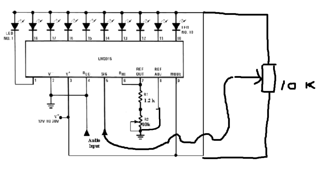

Make sure you have the LM3915 wired (initially) to be at its most sensitive. Try it wired like this. The value of the preset can be 10k if that's all you have.

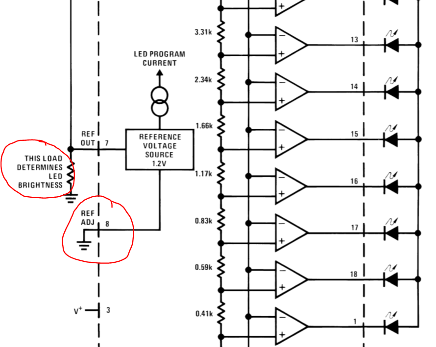

my vu meter circuit is slightly different. I have resistor from pin 7 connected to pin 8 and pin number 8 goes to variable resistor instead of the ground. isnt that right?

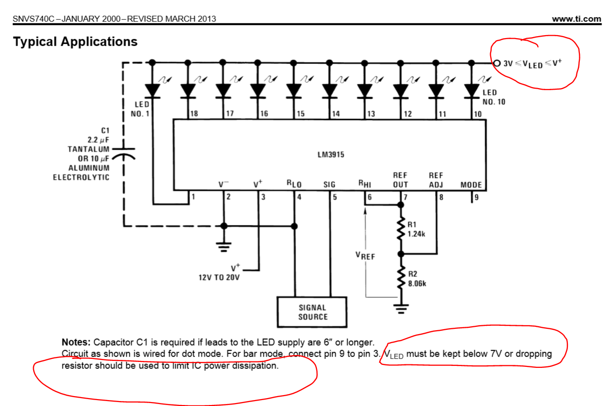

That set up doesn't give the highest sensitivity. Try it like this. I also read something else in the data sheet... which we can worry about that later, and that is that the supply voltage to the LED's should be limited to 7 volts to avoid overheating the IC with to high a loading.

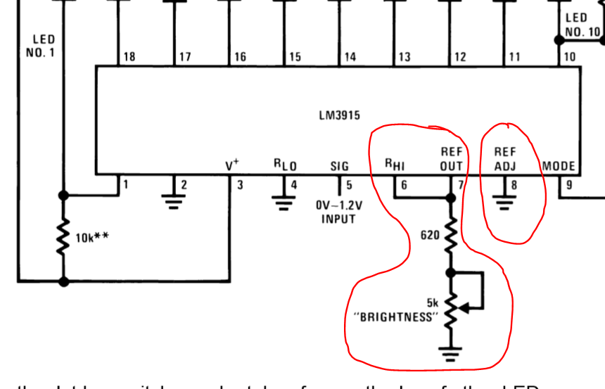

Oh and i noticed one more thing. When i tried to disable connection between the variable resistor middle leg and the side one all the leds blink!!!!! Scheme seems working but the leds blink very unbrigthly i can barely see them:) and when i connect variable middle leg to side one 6 leds blink but very bright and nice

in the second photo. Shouldnt the middle leg of the variable resistor be connected with side one?
It can be wired like that but that is lowering the sensitivity. The data sheet suggests that wiring pin 8 direct to ground gives the highest sensitivity (so all the LED's light up for just 1.25 volts applied to input). Pin 6 and 7 connect together and these go via a resistor to ground. The value of this resistor sets the brightness.
Wire it up as shown in the first picture and with pins 6 and 7 joined.

i dont quite understand those connections in the first photo. 8 is connected to the ground? and 7 connects one side variable resistor?
Yes, pin 8 to ground. Don't go to low in value with the variable resistor, particularly if there is no series resistor added. Otherwise you might overload the chip. Just make it 5k as a safe value. Doesn't matter if the LED's are dim... get kit working first.

Make it look like this. You can keep the 1.2k because that prevents the total resistance going below that, even with the pot on minimum resistance.
The pot at the right should enable all the LED's to light as you turn it. When you get your meter you can then check how much voltage is needed to light them all as you turn the pot by measuring the input voltage to the chip.
