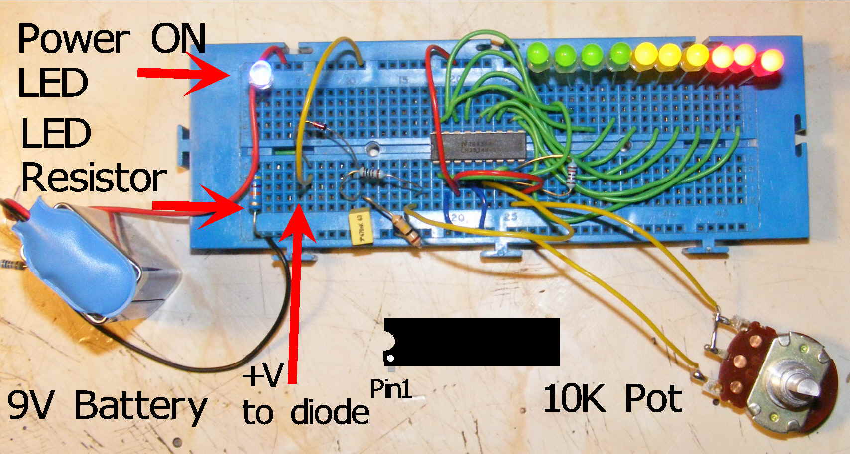

the Audio input goes to the diode, the resistor to Pin 5
the audio ground goes to negative
To test Connect the diode input to +ve this puts 9v on the input. All the leds should light if pin 9 is connected to positive (bar graph mode)
Here is the LM wired up to test.
I suggest you put a led and resistor (1k-5K resistor will do) from positive to negative as a power on indicator, this will show if the battery is connected and if it has some power in it.
Check the IC is the right way round. Pin 1 is the end with a small cut out/ dent usually semicircular. some have a dot molded by pin 1
Do connect Pin 9 to positive.

Can you check the resistor from Pin7 to pin 8. it should be Brown Black Red + Gold or silver. your picture suggests Orange as the 3rd band
If its orange then its a 10K not 1K
the original Gif suggests 1.2 K thats Brown Red Red + Gold/silver
(Brown Red Orange is 12K)
the value of the resistor from the diode to negative should be around 100K , the one to pin 5 @ 1K
I can not read the values from the photo I'm afraid
Is there a wire from pin 4 to negative? there appears to be one from pin 2 to negative.
To stop confusion have Positive only at the top of the breadboard and Negative only at the bottom. Do not use the extra power rails. Put a power light from + to - to tell you the battery is connected.

If you connect input pin 5 to pin 3(short pin5 to pin 3 with a jumper), what happens.

Resistor between pin 7 to pin 8 is 1k
resistor from diode to negative is 100k and other resistor from diode is 1k. capacitor im using is 1uf and capacitor positive connects diode cathode and negative to ground :/ When i connect my audio to pin 5 everything works but only 6 leds blink... when i connect to diode all the leds immiadetly turns off
