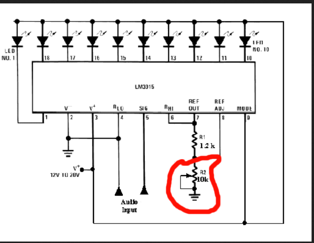

the lm3915 and the others in the LM39xx familly will happly run on a 9v battery accordin to the data sheet even down to 3v.

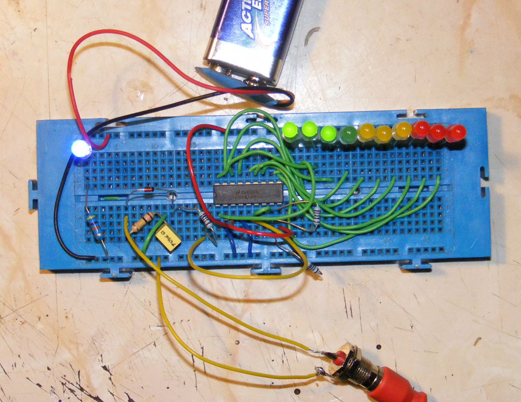

If you can manage a photo of the breadboard layout you are using maybe we can see the problem. I'll try and post one soon on a typical breadboard

Both pin 2 and pin 4 should go to negative, it looks like only pin 2 does.
pin 9 should go to positive for a bargraph or do not connect for a dot mode.
Make sure the LED's are the right way round >Flatside of the leds to the Chip other side to positive.
A voltage on the wire to pin 5 should light the leds. You can try this by connecting another variable resistor (potentiometer) one side to positive(+) one to Negative(-) and then the middle to pin 8
this will allow you to adjust the voltage from @ 0 to @9 volts and see the leds light.
once this works we can add the few parts needed to make it work on music signals

looks like the potentiometer is connected to pin 8 and if i'm looking at it right there's a loop that forms a short across the pot...
pin 9 (can't tell) appears to have no connection so it's in dot mode...
staring at this I agree I think pin8 is grounded, my first guess was pin 9 grounded.
So Disconnect the wire from pin 8 to ground
Pin8 connects to the Potentiometer
Pin 8 also goes to one end of the resistor, the other end to pin 7. I think that is done on the board.

I know this probably sounds obvious (this is aimed at lukutis 🙂) but it can help to look at each pin in turn on the IC starting at pin 1 and then confirming and checking it goes exactly where it should. Go around the IC methodically and tick them off as you check each one.
Just looking at it all as a whole and you miss things.

i have pin 2 connected with pin 4 but only pin 2 connected to ground. Do i need to connect pin 4 with ground also? And i dont need connection from pin 8 to negative just to the middle leg of variable resistor?
well we have to assume that all your connections are good (some breadboards will give you connection problems especially if you use different diameter wires in adjacent holes)
if pin 2 and 4 are connected and 2 see's ground then 4 should be grounded (only real way to know is to verify with a multimeter set to low ohm's scale)
tying pin 8 to the pot wiper will change the sensitivity (which from what your telling us isn't sensitive enough)

pin8 goes to the variable resistor and the middle leg of the variable resistor goes to negative (ground) (as per the original diagram in the first post)

so if you take everything off pin 8 install a jumper to ground you don't get leds further up the ladder to light up?
try hooking pin 9 to b+ (your positive supply point) and describe to me what you see?

so does your meter correspond to the levels on your computer.
cause you can't meter what isn't there.
and yes pin 8 to ground.

The original diagram shows the middle leg of the variable resistor connecting to one end of the variable and ground. The other end of the variable goes to pin 8
As turk suggests connect pin 9 to positive to make a bargraph.

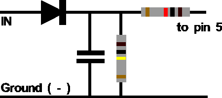

To make it work though I feel the original circuit is not much use and you need a diode, a capacitor and 2 resistors, see image attached.
This will give only positive voltage to the VU meter, the value of the capacitor will alter the decay time of the bar graph, try 0.1uf > 1 uf the larger the value the slower the meter.

Yes i have them connected like u said. Where does this diode connects? i didint quite understand those IN and OUT
