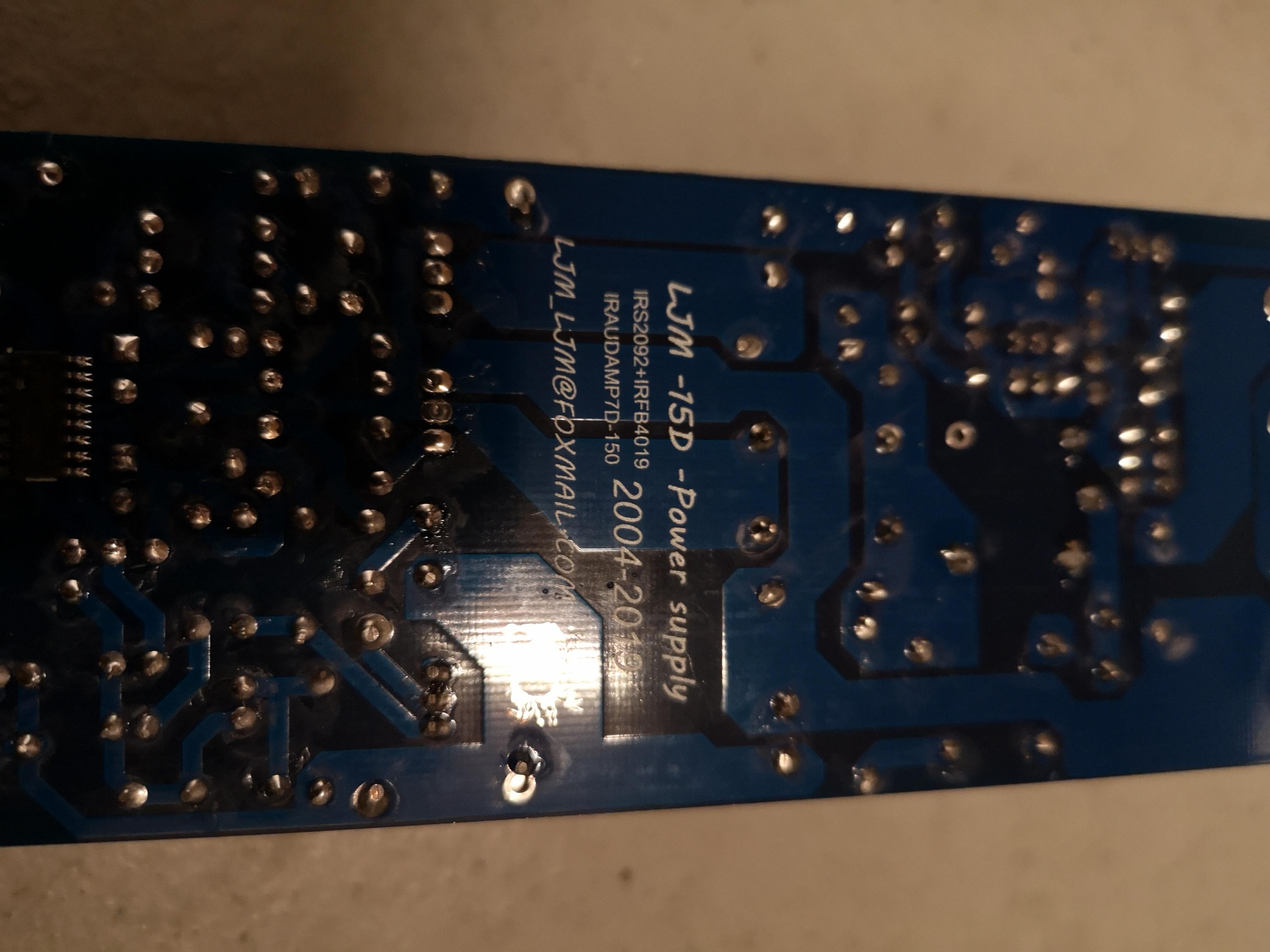

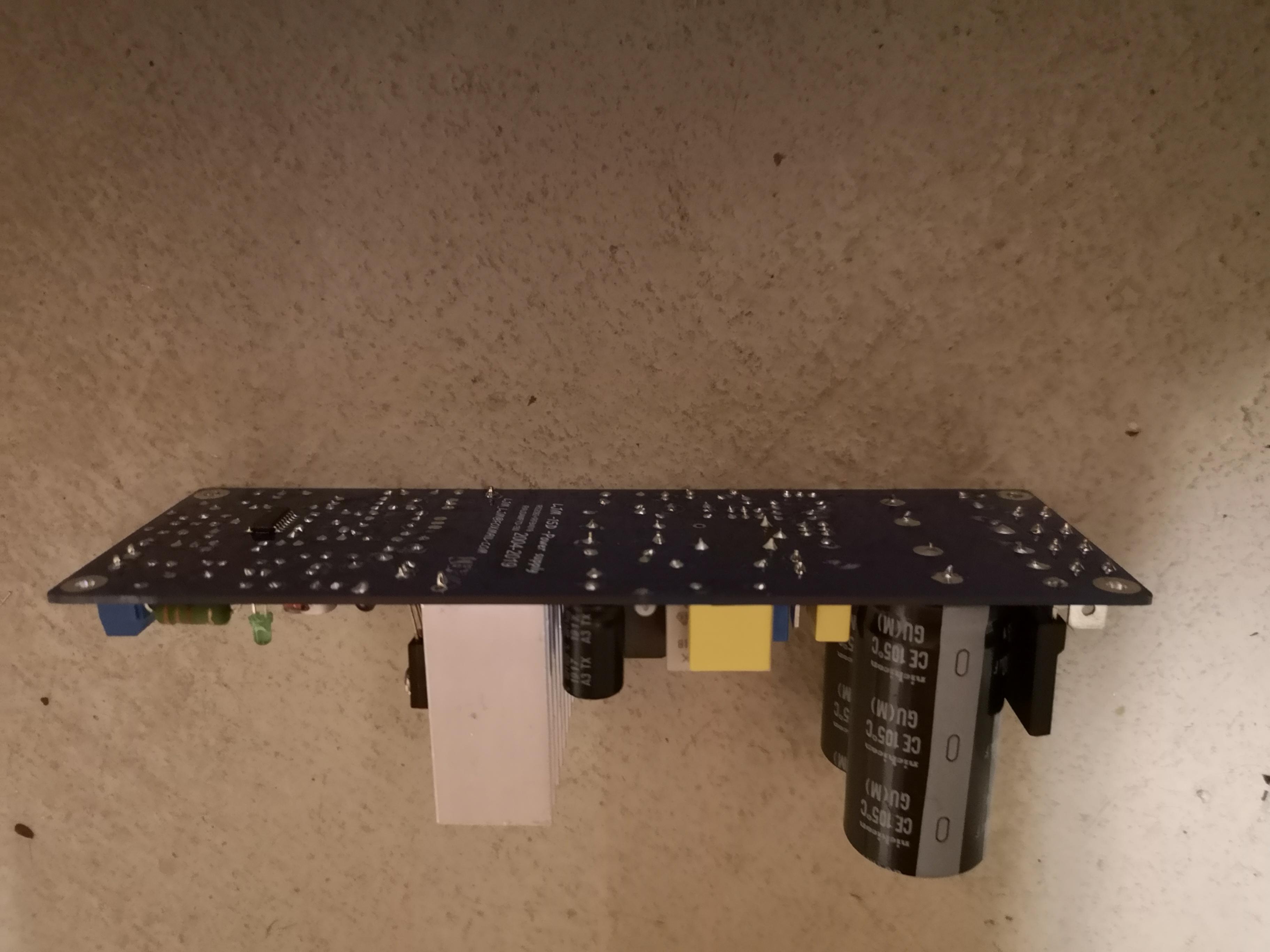

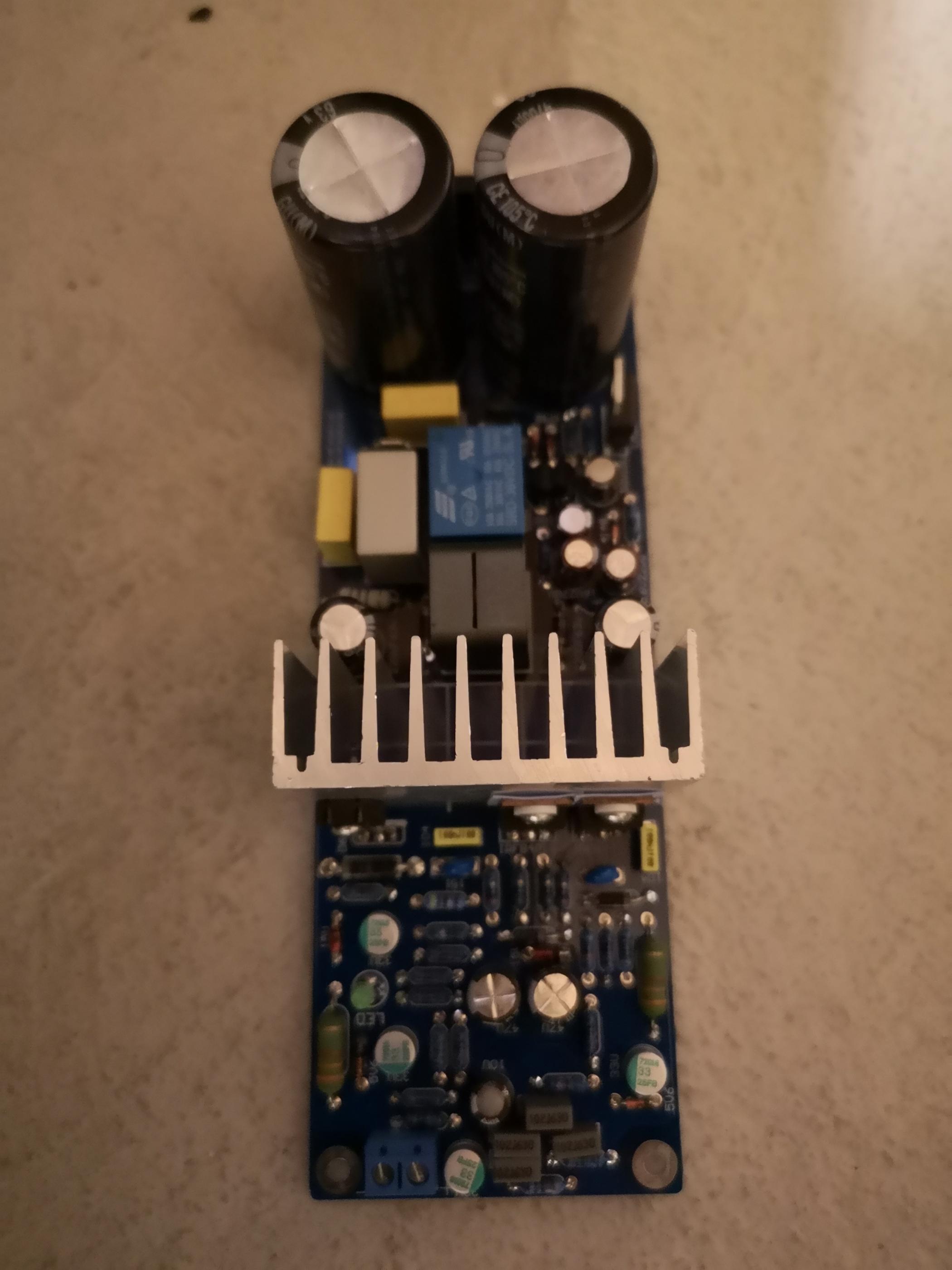

LJM-15D POWER SUPPLY MODEL
Hi all,
I Just purcase this module and wonder
If i can use thisone as a replacement for
a 150w subamp?
And how can i implement an auto on/off
function as seen on mostly every subwoofer amps
nowadays?
