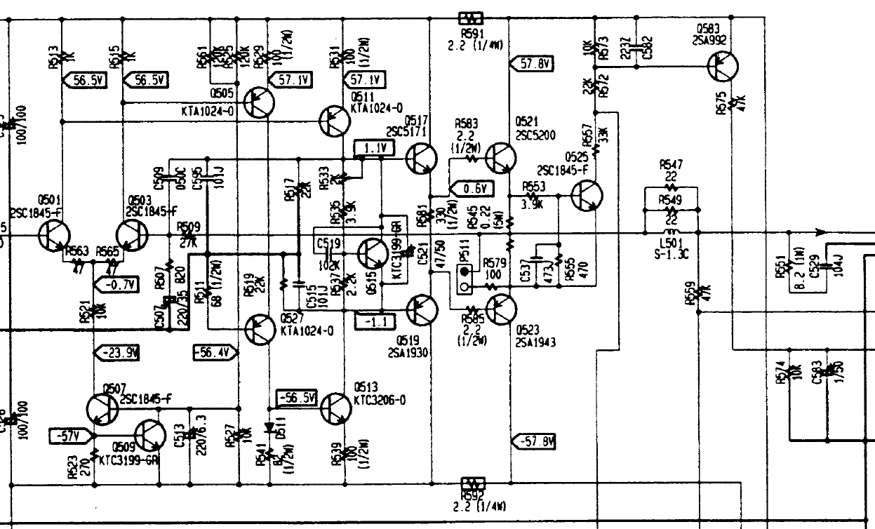

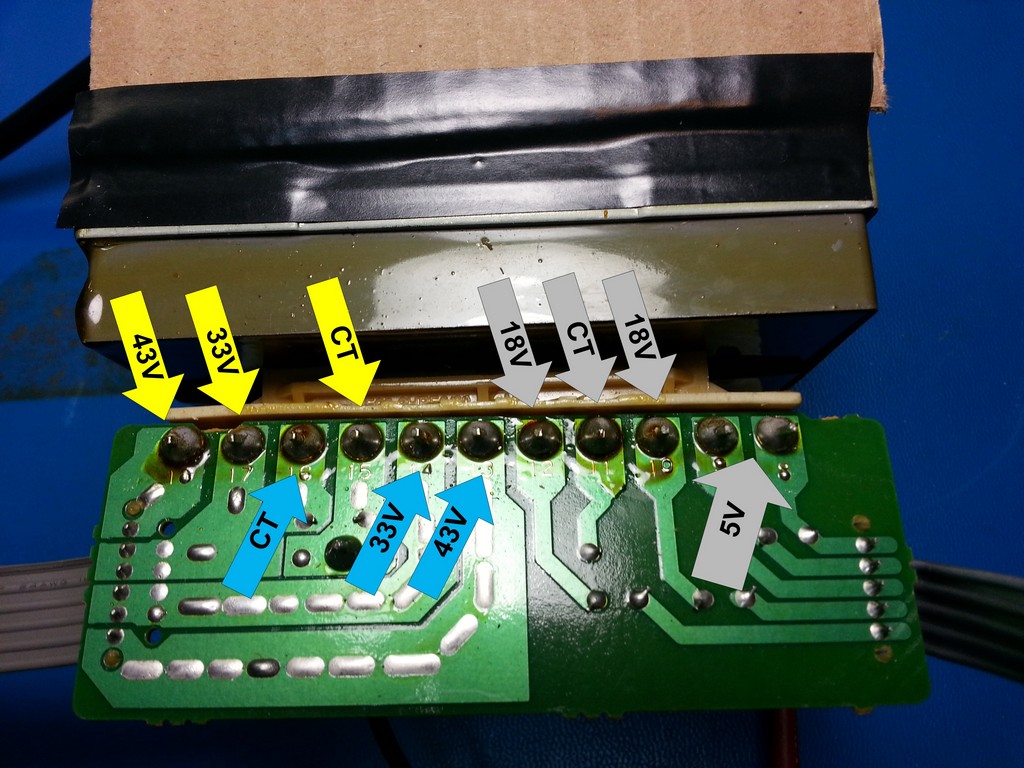

LJM mentions it's OK to use less then +-60v rails and I've got an Onkyo adm21 that I was thinking on using the chassis, heatsink, and transformer. The transformer has 43-0-43, 33-0-33 (not used), 18-0-18, and 5vac. The schematic for this amp shows +-57.8 rails and it uses 2sc5200, 2sa1943 (just one of each for each channel.

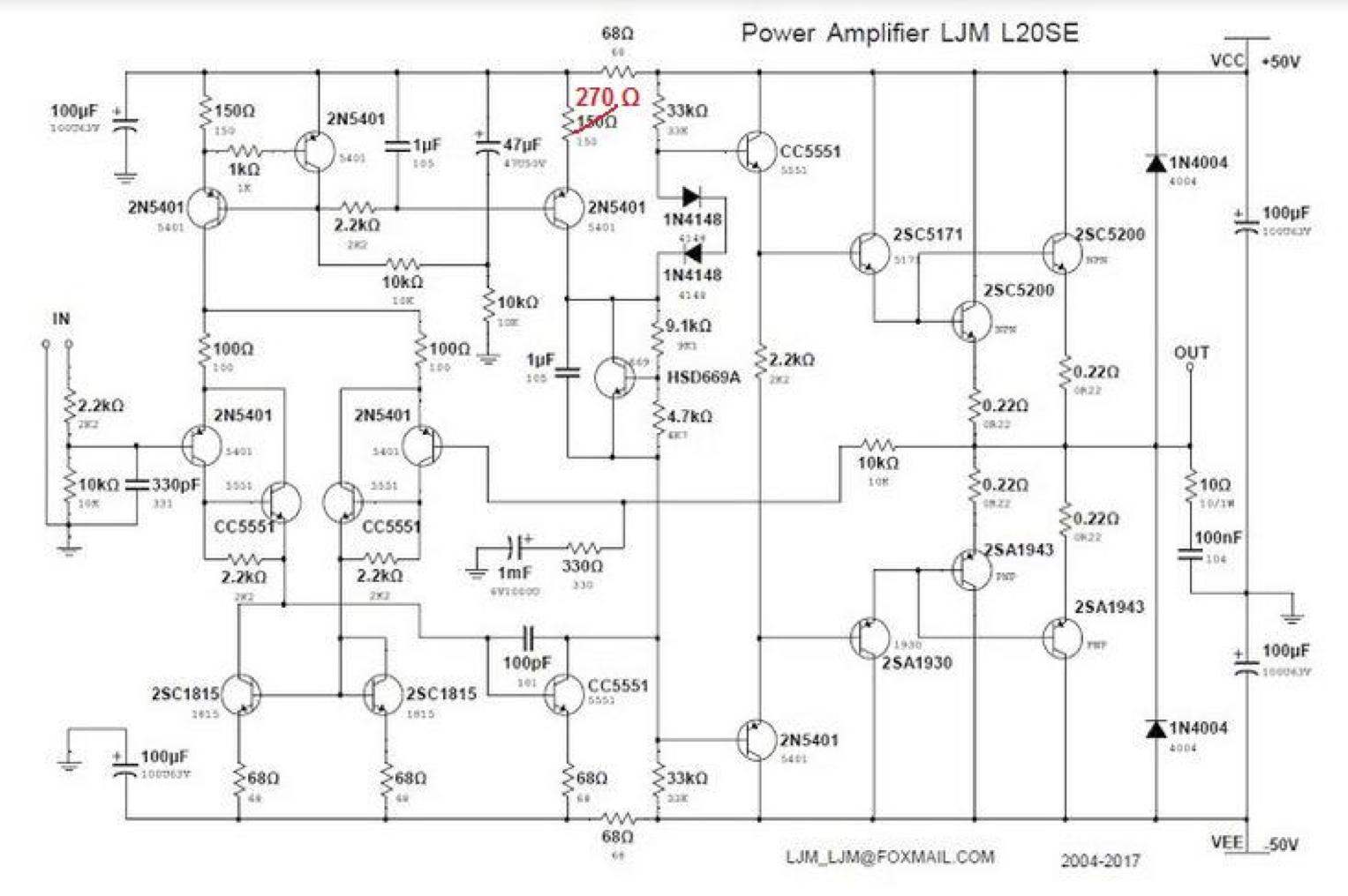

Sorry but I can't relate with this statement. L20.5 has only 6 small signal transistors but L12-12 and L20SE have 12 small signal transistors on PCB (excluding output, drivers and bias). Even MX50 ones have 10 transistors with two extra driver size transistors (which makes 12 actually). How come L20.5 regarded as an "upgrade" despite reduction in complexity?
Did you miss the two tiny dual surface mount transistors? (Four more?) They are very small six pin surface mount packages.
I didn't notice those tiny smd transistors until you pointed out. So we can assume that 10 small transistors at best. I have to apologize in this regard.
One can probably not generally gauge the quality of an amplifier by the number of transistors - take Hood1969 for instance. However, I believe the L20SE is one of LJMs favourites?
L20SE with TTA/TTC Toshiba's looks promising to me too, except those high voltage transistors (5551/5401) at input stage.
The 5551 and 5401 might be a good choice for certain usages (locations/purposes) in power amplifiers and not other locations.
What's the magic of 2N5551 / 2N5401?
Surely it is the quality and implementation of the design NOT how many transistors or other components used. Many would argue that a Class A design sounds best and they are usually low component count. Yes
But the problem is, we are not discussing single ended class A topologies here. LJM boards are tend to be class B style boards and such topologies must retain a degree of complexness in order overcome obstacles on their way. There is no free lunch here. Invention and evolution of opamp IC's is a good example.
Is the L20SE going to live with this much rail voltage?😕
I would use the 33-0-33 rails on your transformer for an ~ 45-0-45 VDC rails .
Modules will run much cooler and have the added ability of easily driving much lower loads . Even if your speakers are rated at 8e , there may be points where they drop to about 3e .
"Power 200W 8R 350W 4R at DC + - 65V
Performance parameters:
Dual power supply range :+/-DC18V- +/-DC65V. (recommned +/-50V)"
If you decide to use the lower voltage windings, you could check the winding cable thickness to ensure the necessary current is available, otherwise rail voltage will drop considerably under load. Instead you could consider regulating the 57.8V down to 50V. Will generate bit of heat, but rails will be less noisy and it might save you some (expensive) power supply caps, if there are not enough originally in the Onkyo.
