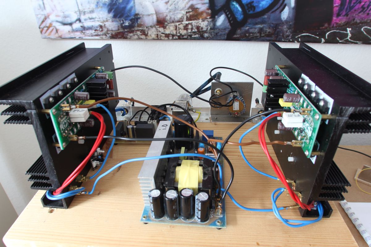

Re. the SMPS discussion, my two MX50SE have been running fine with one of those for a long time now. Dead quiet and sound great - and they run cool on relatively small heatsinks - Kudos to LJM for that design! But, worrying about HF etc, the current project has 2x30,000 uF on the rails w. slow start circuit - while killing all ripples etc they also give a bit of extra transient resources. Also this project is totally hum- and and noise-free, partly thanks to the two SMPS - Re. the L20.5 suggestion - current (2019) version is no 10, correct? But the older one is preferred?
Hello my test setup has been running since:
Power supply 2 x 54 volts + Softstart.
I reduced the input sensitivity by adjusting the resistance and the potentiometer is no longer required.
No background noise perceptible.
I'm curious how it sounds when it has been running for a while.

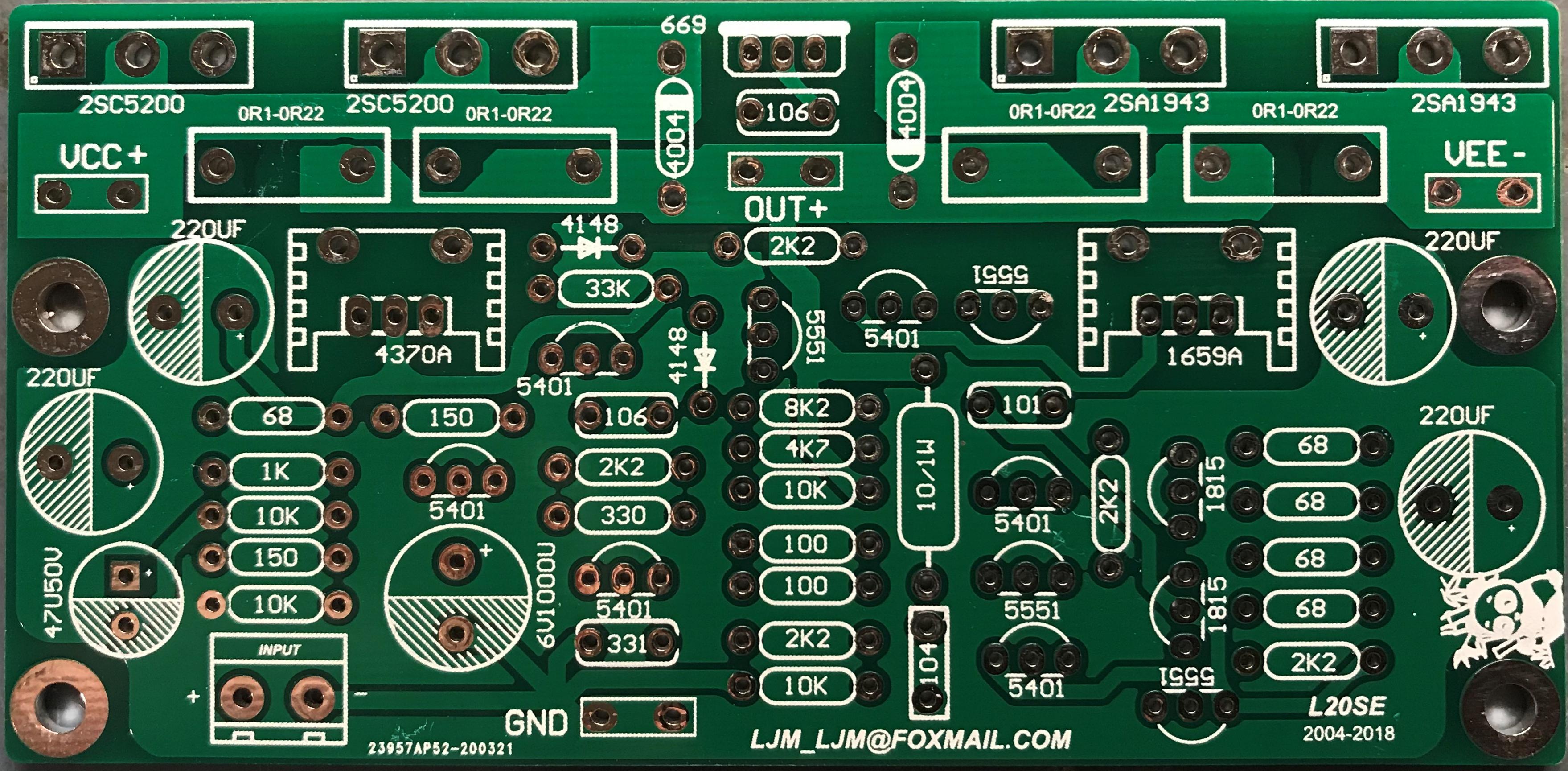

can you describe to us what the challenge was for the fit?
One board got hot, the other not. It was oscillating I guess. I started fiddling around, made some mistakes I guess and burned the boards. Installed replacement boards, one board got hot the other not. Bought a sh-load of transistors from reichelt.de and matched them. Installed potentiometer to adjust IQ. Boards are now equally hot and the amp does not oscillate anymore.
I am not sure what solved the problem since I did this to the boards that I accidentally torched. I think setting quiescent current might have been the important thing.
Will experiment with my untouched boards to confirm at some point.

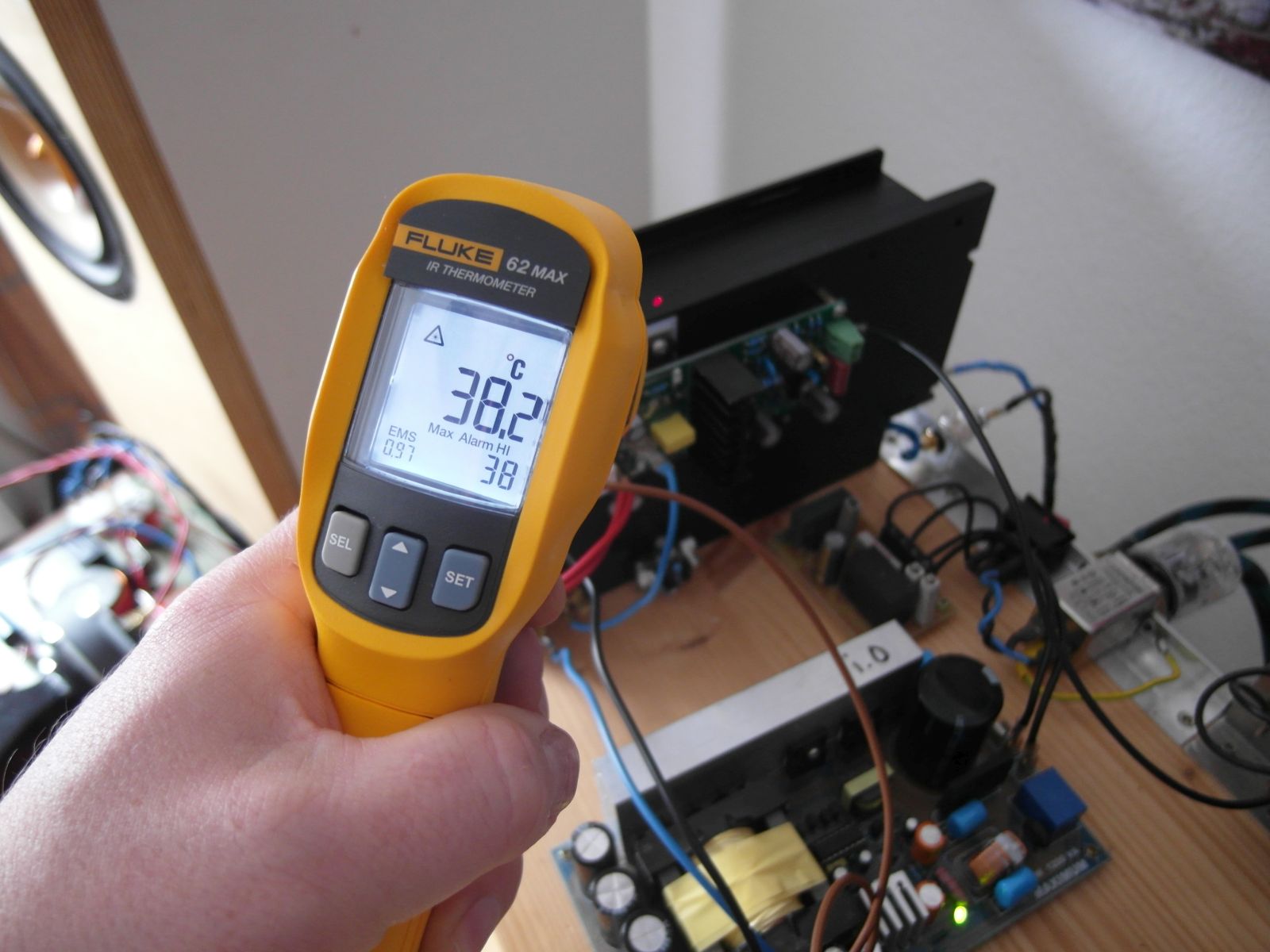

My two L20.5 show the same phenomenon:
The left amplifier / heat sink heats up to around 40 degrees, the right only 22 to 25 degrees.
Question to LJM:
For me it is no coincidence that two people have the same phenomenon.
Is there a system behind it?
A -> Hot B -> cold?
The L20.5 has only one PCB so both are the same. Mine have the exact same temperature but that is because I installed a trimmer (comes with fixed bias) and I measured and set the bias.

Actually, on one of the boards I got the silk screen says 1k1 on it for the resistor that was substituted for a potentiometer, on the other it says 1k. Seems there are different versions and that they get sent out randomly.Are the PCB layouts the same or symmetrical? Did you check for oscillation
with a scope?
LJM said QC does not matter for the sound of this amplifier and that it can be different than advertised.

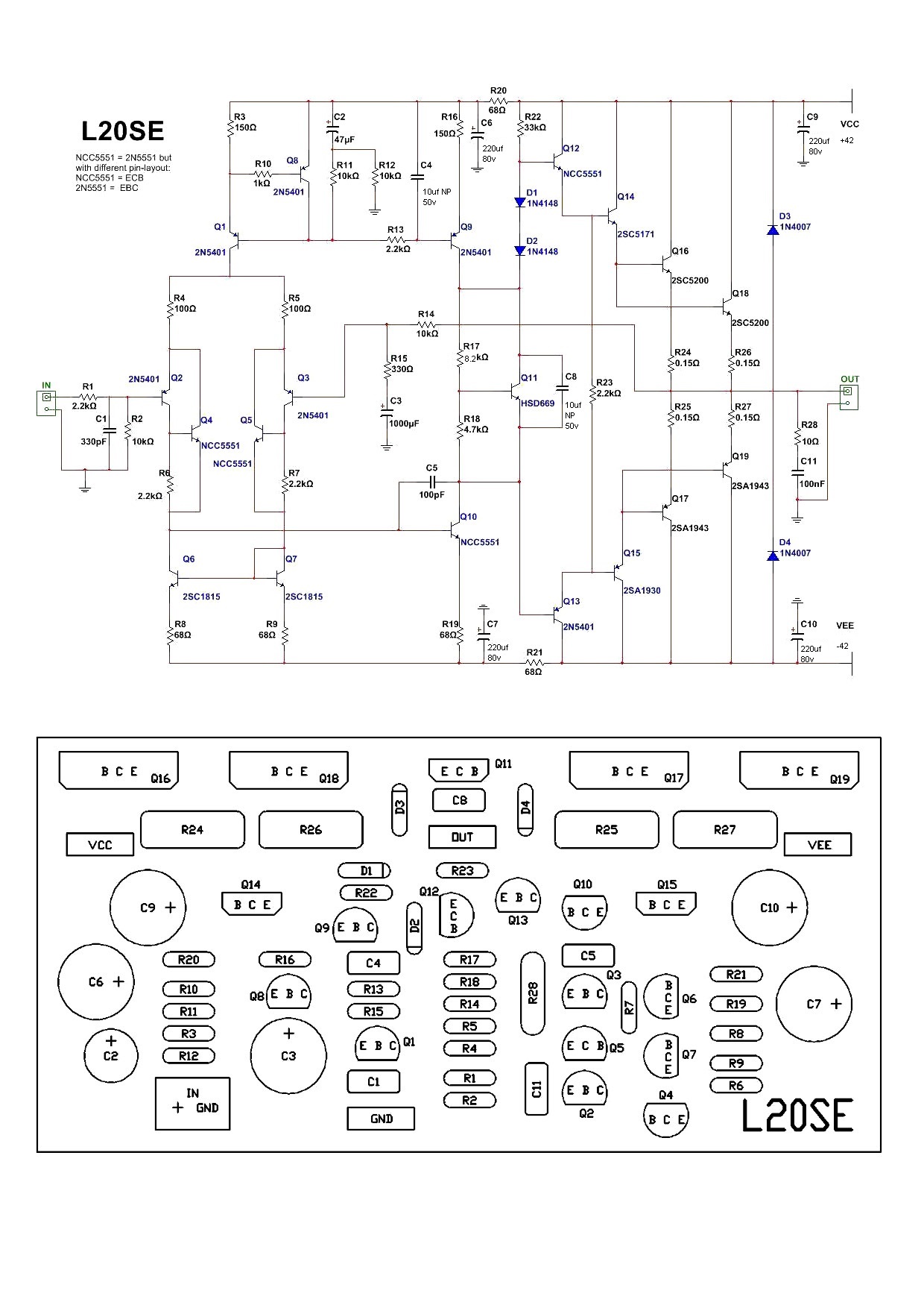

Just starting to build a pair of these. I'm using a 30-0-30 300va toroid and one or maybe two Rectifier Filter Power Supply Board w Speaker Protection 4x50V/6800UF on each board.
One question about multi turn pot for bias control. I've built the MX50SE and did the bias pots...glad I did. On the L20SE boards I received, R-17 is 8.2k and C-4 and C-8 are 10uf/50v NP. Also I noticed C-6, 7, 9 and 10 are 220uf / 80v.
Do I leave out the 8.2k and put in a 10k multi-turn? That's what I did on the MX50.
Older home audio amplifiers have a bias pot and I'm comfortable doing any mods to make this as nice sounding as possible.
Any help would be very much appreciated before I get too far along with the build.

Question... The kits I received are using NP 10uf electrolytic caps for C4 and C8. Not much room there! The schematic posted by Eliseu shows a 1uf in these locations. So my Question is.. OK to use 1uf Metallized Polyester Film Capacitor in these locations? They sure would fit better.
