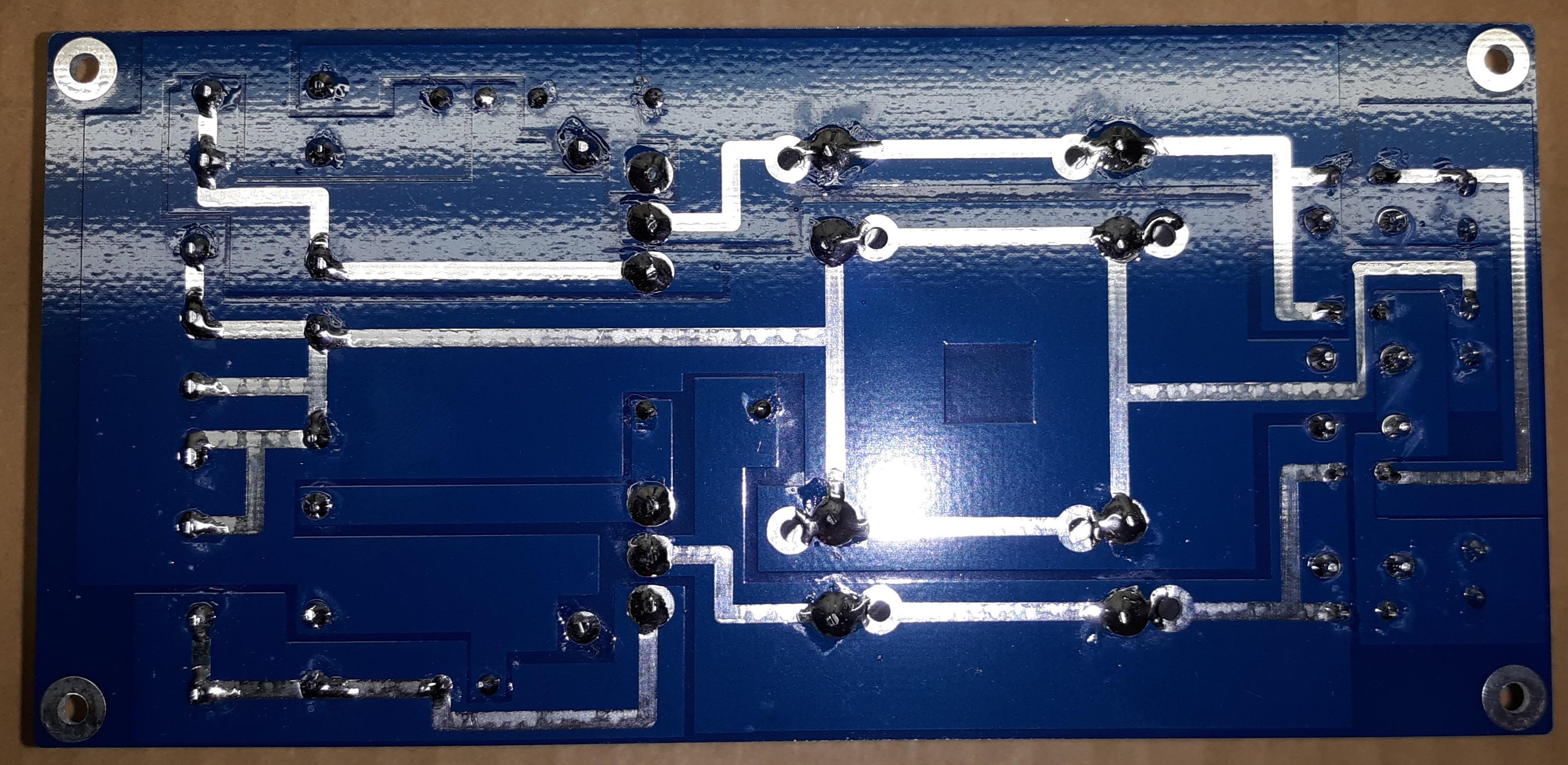

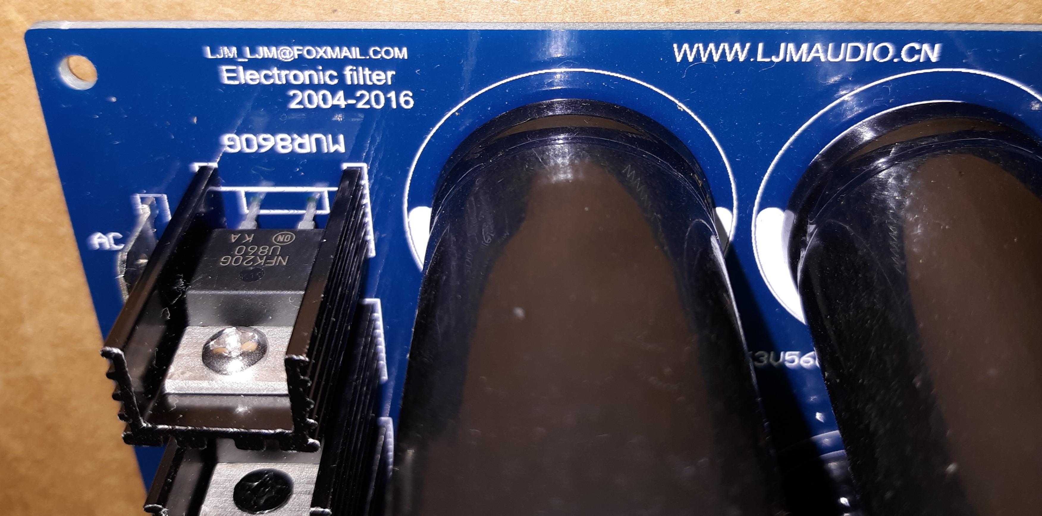

His original (old) logo is on the top. See photos (between the four large Nichicon caps).

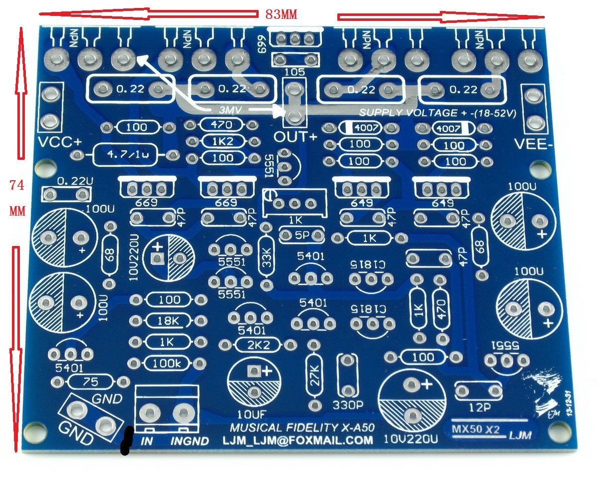

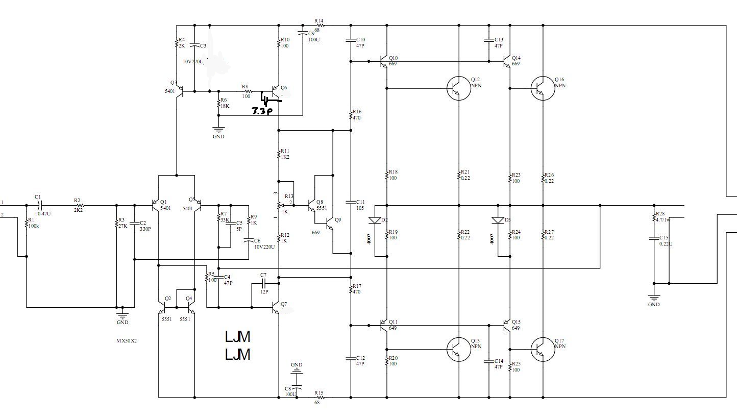

For the mx50x2 there is a small trick have to do.Ad a small ceramic capacitor 3.3 pf at Q6 (5401) underboard.This capacitor solve all of your problems.
I can try that. I rebuilt the damaged MX50X2 with genuine Toshiba 2SC5200N, TTC004/TTA004 (all well matched) and new matched diodes (for the lower 2SC5200N bias/Vbe) and replacements for the burned resistors.
That configuration has run fine for sometime first with a regular but lower voltage transformer (+/- 30V DC rails) and now using +/-33V regulated (SMPS). I did not return to using the +/-50V supplies on the MX50X2.
However I also built the MX50SE (where the D1047 also blew on +/-50V) and put 2SC5200N/2SA1943N replacements and I think that the MX50SE sounds better than the MX50X2. I used 10k and 1k for the feedback resistors and a 2k 3296 trimmer for the bias setting.
Next I plan to compare some more with my finished DIY MA9S2 and later with in progress next projects (KSA50 and L20.5).
I don't have much of a scope right now (just DSO138 and homemade) but I would like to start evaluating the stability/distortion. Perhaps I will just try with the DSO138 and a 20kHz square wave. Did you measure or simulate for the 3.3 pF modification?

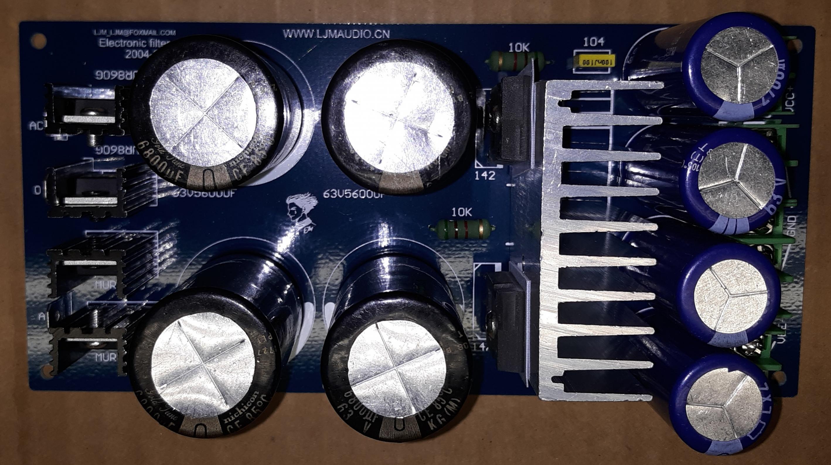

No, I don't have a schematic.
But it is very simple. The most basic capacitance multiplier consisting only of a Darlington, one resistor and one capacitor. Only a TIP142 with a 10k resistor to the base from the input filter caps and then one of the smaller electrolytic caps from base to ground.
Then the other smaller electrolytic cap is from emitter to ground on the output.
The negative side is the same except for polarities (uses TIP147).
The TIP142/TIP147 shorted twice and then I stopped trying to use it. I would look for a more rugged regulator design with some protection instead of this.
Well if you momentarily exceed the SOA the TIP142/TIP147 fail instantly in my experience with this board. (Twice.)
One suggestion was that I put a string of diodes from collector to emitter to protect the pass transistor if it comes out of saturation. Such as three diodes (about 1.8V). Also a protection diode from base to collector (for discharge protection).
Then a resistor in the emitter can be used to turn on an over-current protection transistor that steals the current from the base of the pass transistor.
I would suggest looking for a commonly used and well regarded design. I don't have one to suggest. Instead I went to using two regulated (SMPS) supplies. That (SMPS) is a more controversial choice but the ones I am using are working fine for me.
Perhaps someone else can suggest a good (rugged) regulator or capacitance multiplier to use. It is just my suggestion not to use the most simplistic type without any protection.
