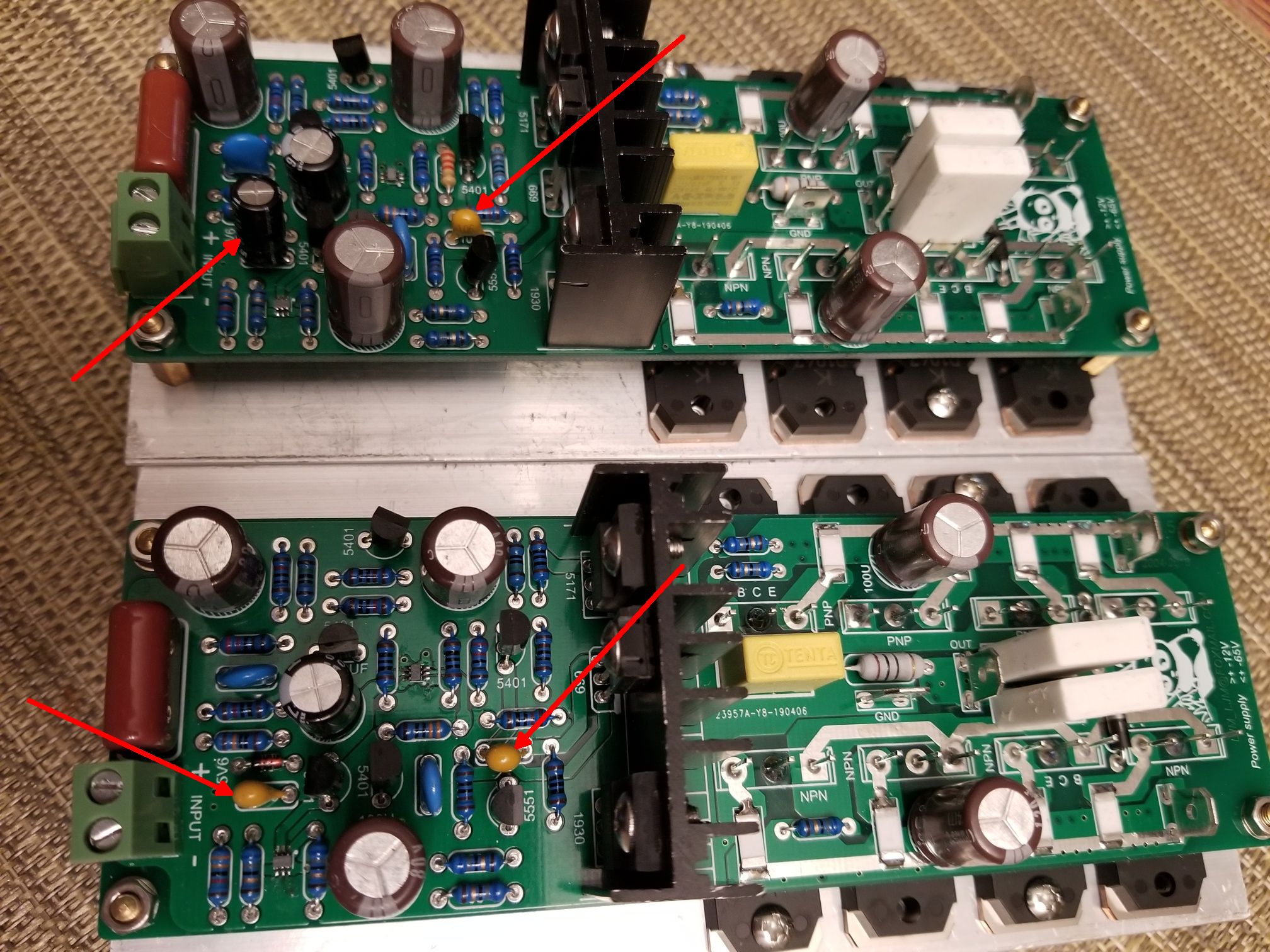

I think it is kind of funny that I ordered two boards directly from LJM_LJM2 on Taobao through Superbuy,
Direct link to LJM_LJM2 web store to buy L20.5
and I was sent two different boards,
upper left cap, reads 10uf, measures 11uf
upper right cap, reads 106 (10uf), measures 8.4uf
bottom right cap, reads 106 (10uf), measures 10.4uf
bottom left cap, reads 106 (10uf), measures 8.4uf
at least mine are not broken.
Maybe it would be a good idea to buy bare boards and populate them with better/higher tolerance components.
