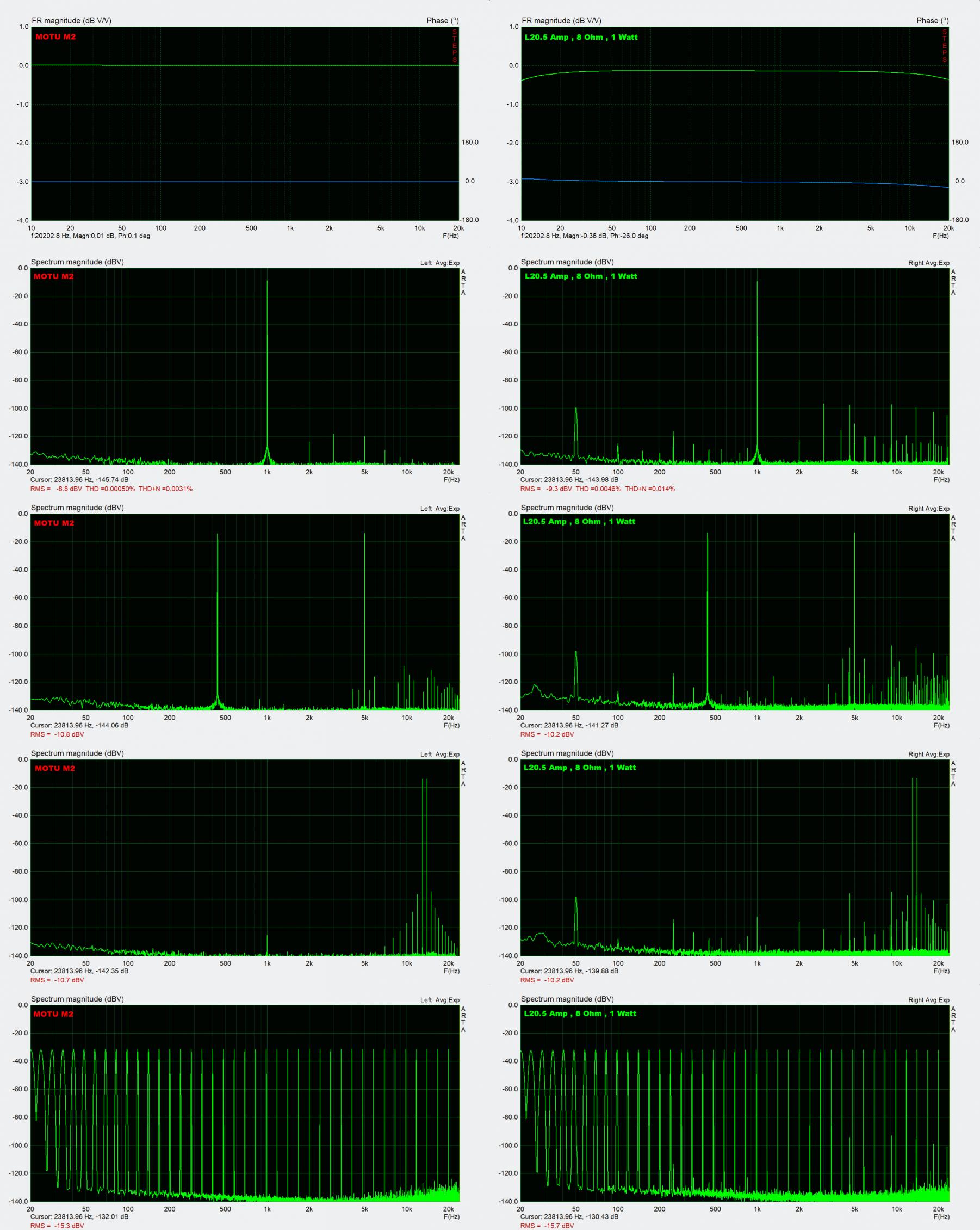

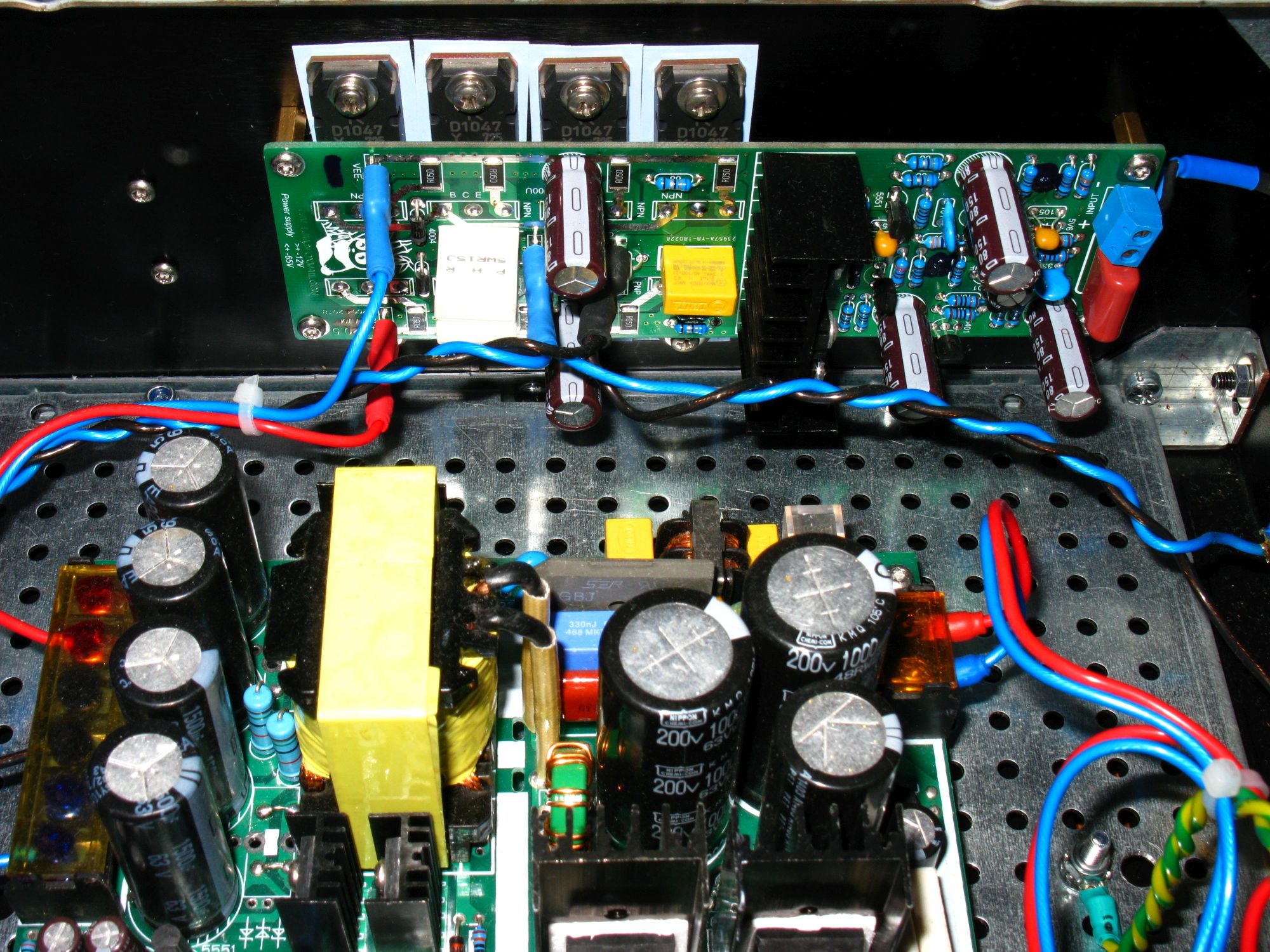

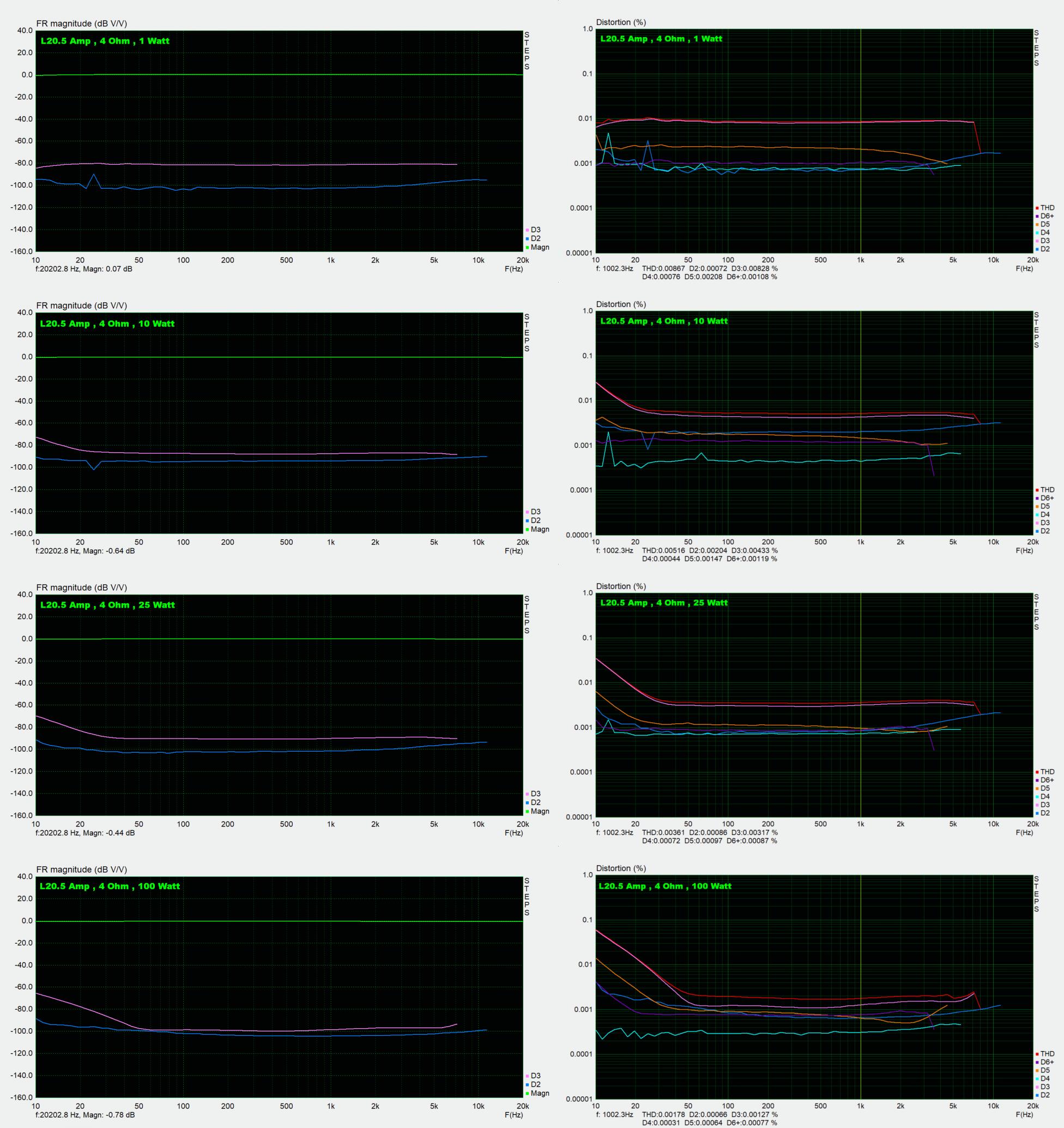

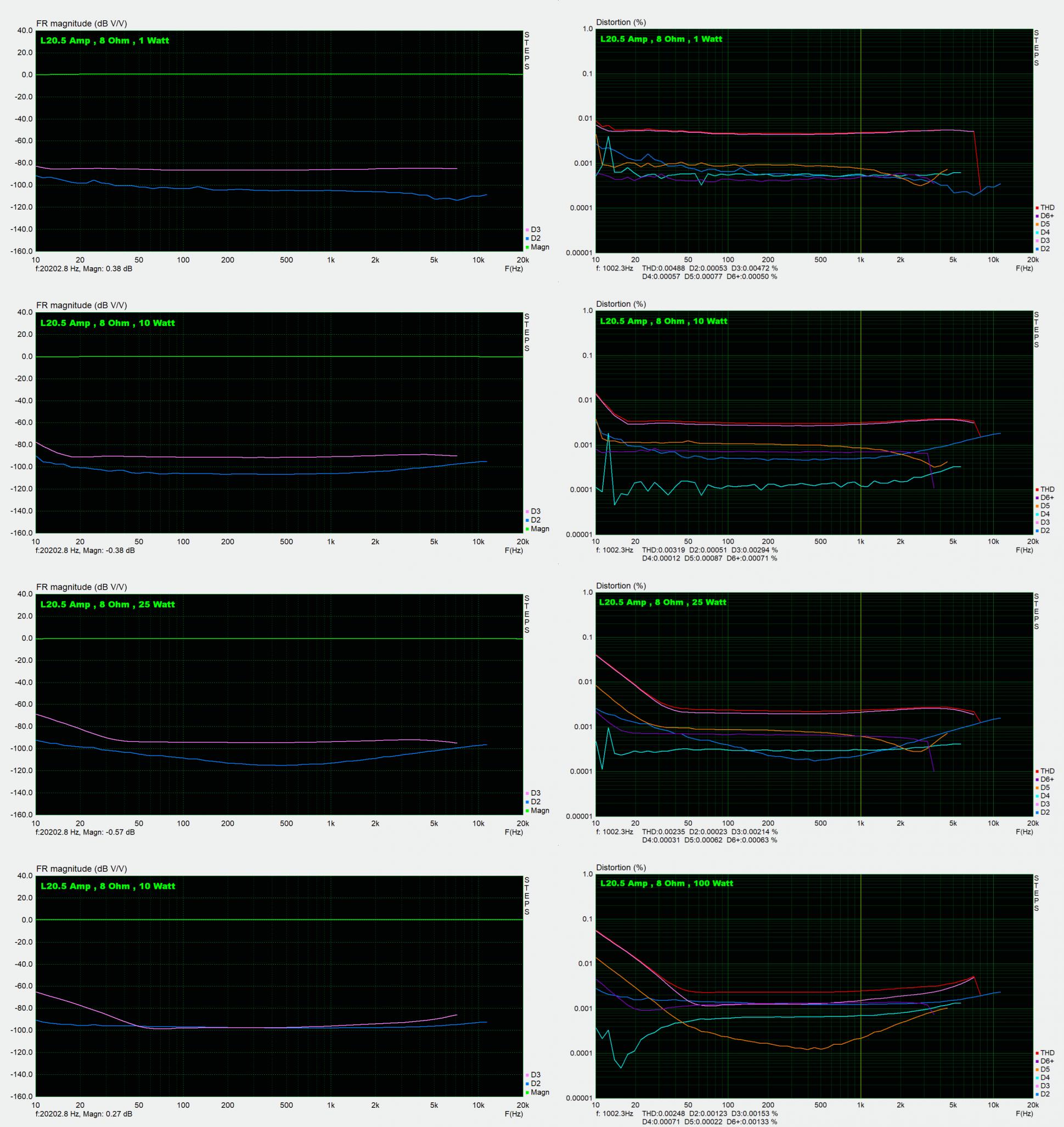

This is my LJM-Audio L20.5 Amplifier.
I let pictures speak first.
https://www.diyaudio.com/forums/att...aar/835638d1587311061-ljm-audio-l20-5-amp-jpg
https://www.diyaudio.com/forums/att...87311061-ljm-audio-l20-5-amp-innenansicht-jpg
https://www.diyaudio.com/forums/attachments/vendor-s-bazaar/835640d1587311061-ljm-audio-4-ohm-jpg
https://www.diyaudio.com/forums/attachments/vendor-s-bazaar/835641d1587311061-ljm-audio-8-ohm-jpg
https://www.diyaudio.com/forums/att...r/835642d1587311061-ljm-audio-vg-m2-l20-5-jpg
@LJM Congratulations, with this Amplifier board you didn't promise too much
This is by far the best Amplifier I've ever built.
Thank you very much for that
Michael

Any link to the casing? I have not found those perforated metal base online also.
Can the power supply be split to supply both I wonder if I don't driver 4 ohm load.
Seems to be the Disspante Case from modushop.bizAny link to the casing? I have not found those perforated metal base online also.
One power supply should be enough on 8 Ohm, since you have only the half output power.Can the power supply be split to supply both I wonder if I don't driver 4 ohm load.
Maybe by reducing the static current, as noted by LJM?
See LJM comment on that here: [wiki=http://www.diyaudio.com/forums/solid-state/199093-l20-amp-njw0302g-post3841646.html]%[/wiki]
Must copy + paste that link

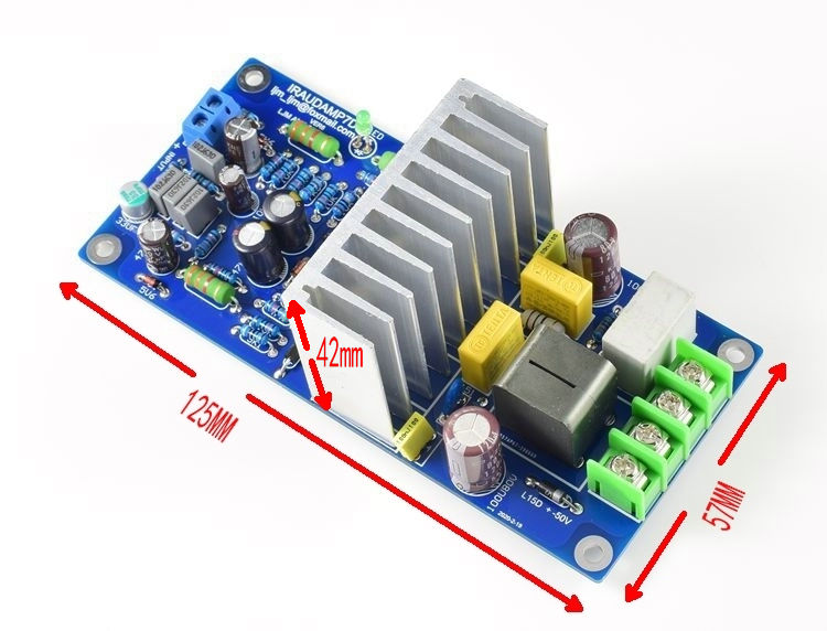

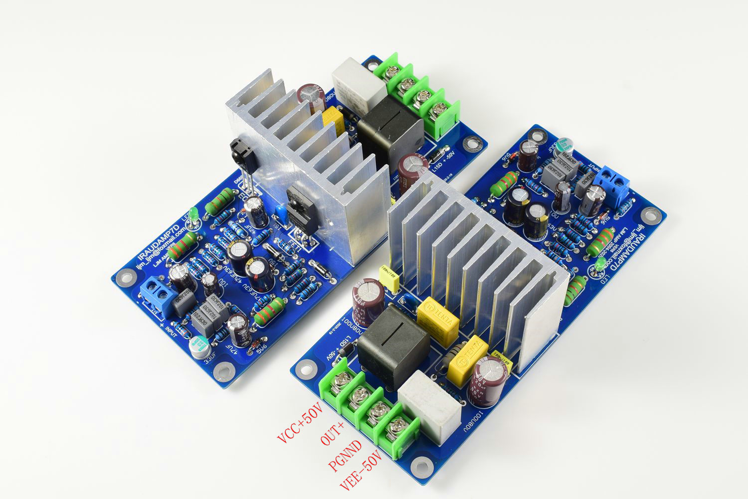

The latest version of the photo.
Because I found that the OSCON capacitor is in a relatively hot position. It may be damaged after working for a long time.
And it can't be seen from the outside.
So in some places. I replaced the electrolytic capacitor with a higher voltage. 50V-63V。
They are used for filtering capacitors. More capacity. Higher withstand voltage. So performance doesn't degrade. It will be improved.
The input signal capacitor has a very low working temperature. So the OSCON capacitor is still used.
PCB adopts two layers.
