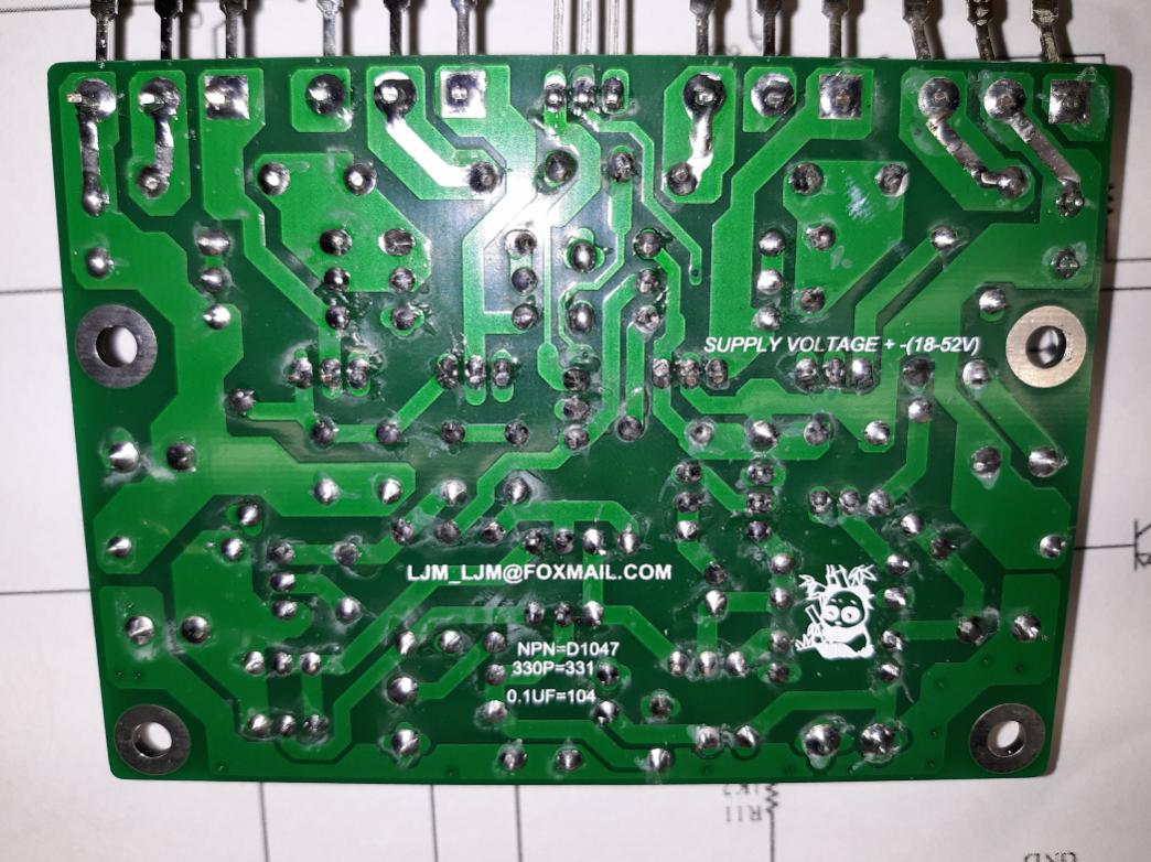

The MX50X2 which burned has your new panda logo and green PCB.
I have attached photos. Are those genuine? The soldering (back) looks rather messy. The blue board MX50SE that I bought was much cleaner.
Two boards from the same order were powered up the first time at +/-50V and one board was fine the other burned badly. Lost four drivers, four outputs, three of four 0.22 ohm, two 100 ohm and two 470 ohm. The board that burned was destroyed in seconds.
Both boards had worked fine at +/-25V (on my initial test setup, low volume).

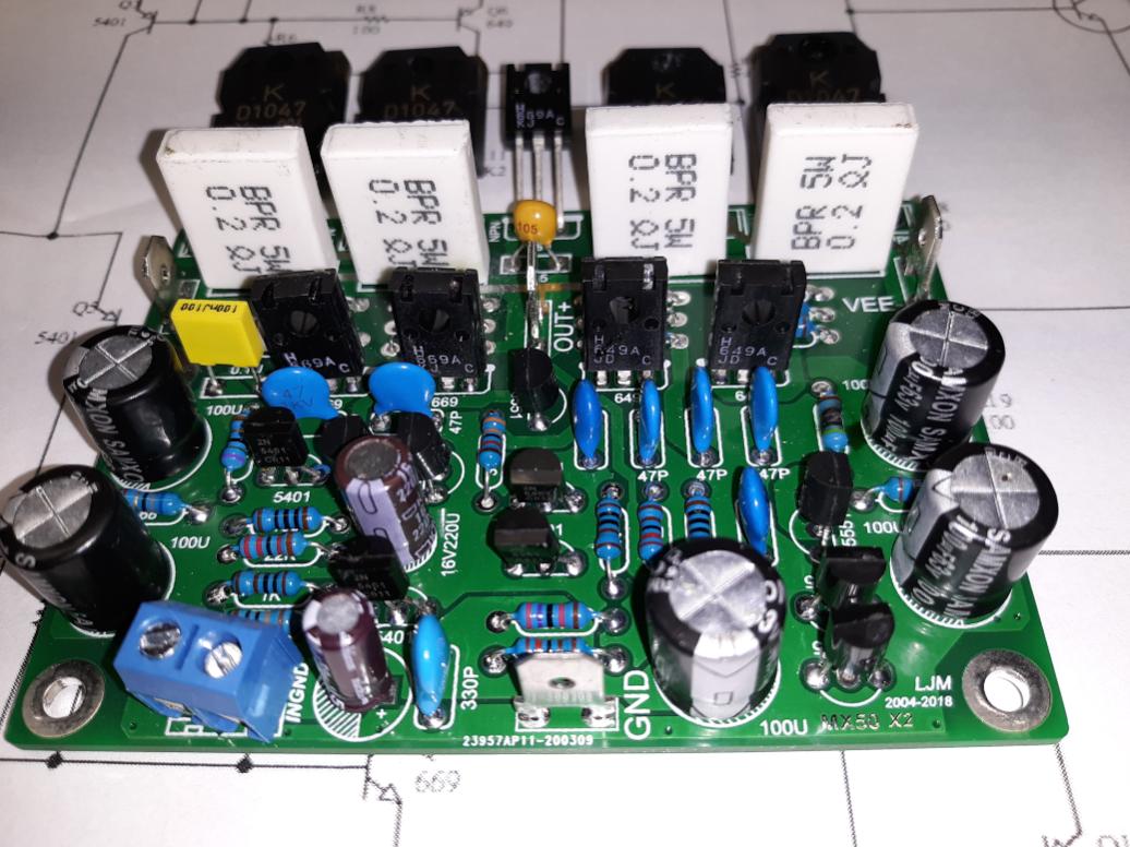

@ljm_ljm , please what is your recommendation about MX50X2 bias ?
I changed D1047 for genuine 2SC5200 i got a long time ago, also replaced the 2.2k fixed resistor with à 2.2k trimmer and set bias to 20mA (3mV through à 0.15R collector resistor).
It seems to works good but i can't measure anything and want to be sure.

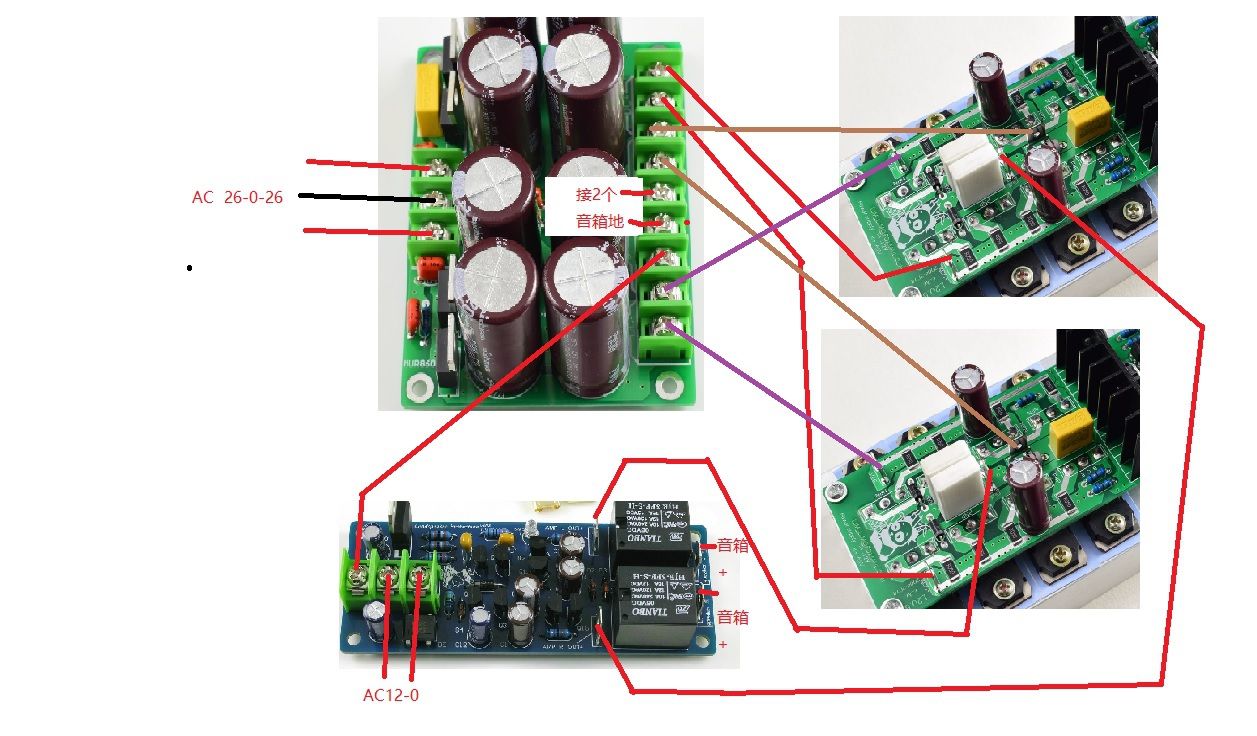

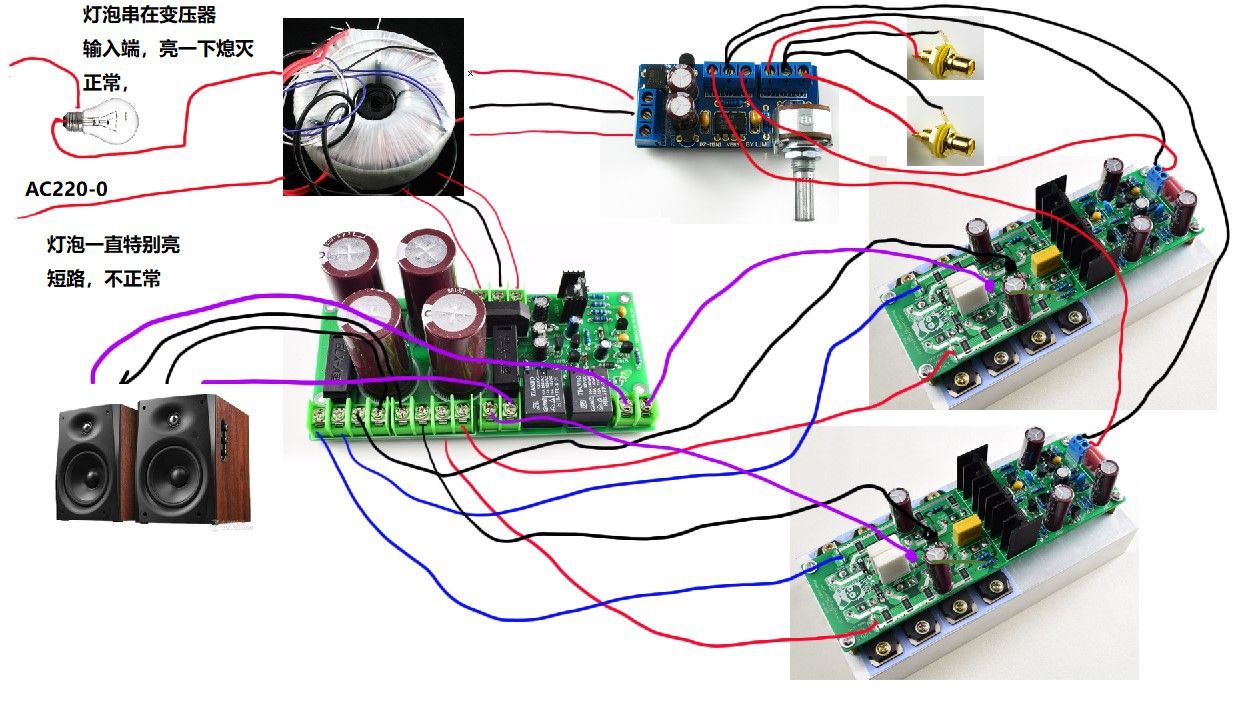

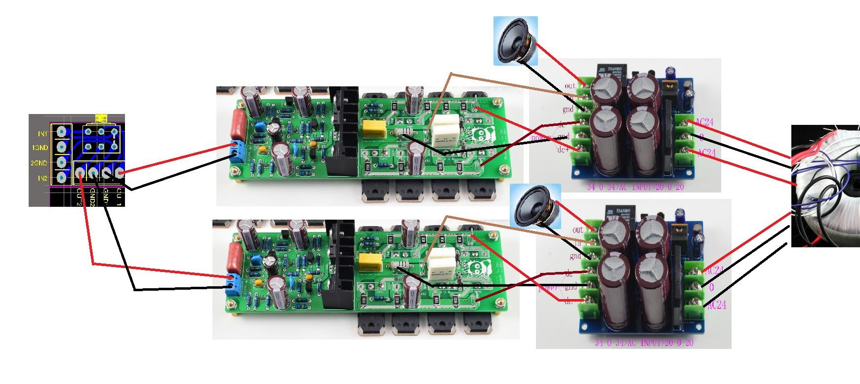

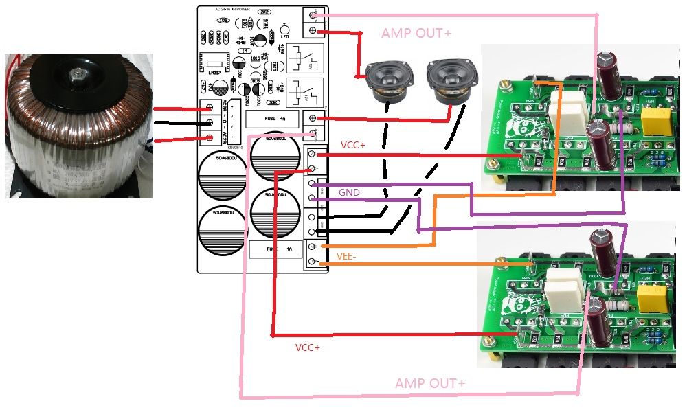

You show 5 different ways to build an amp with the 20.5 boards,
Which is the best way to build it?
Option 1,
Option 2,
Option 3,
Option 4,
Option 5,

I am wondering if I should take a +/-40 VDC approach with my MX50X2 (after one of the two incinerated the outputs/drivers/emitter resistors) during the first few seconds of the first power up at +/-50 VDC. It had worked fine earlier in an easy debug test setup powered at low voltage through LM317/337 at +/-20V.
I have not attached my L7 to high voltage yet so perhaps +/-40 VDC is best but that complicates things since the old defunct receivers I am using have higher voltage transformers.
Does anyone know the relationship for peak output voltage to supply voltage for the L7 and MX50x2? I ask since I am sure 24V and 3A across my speakers will plenty. Does that require supplies of +/- 30V?, or +/- 35V?, or +/- 40V?
I am not trying to measure this myself since one MX50X2 already incinerated and I have concerns about the second which is still working but is back to the low voltage test setup.
Regarding the NCC5551/5401 maybe I should just replace them on the L7 before trying then at higher voltages above the +/-20V of my simple/easy debugging setup? Could I perhaps use TTA004/TTC004? Those are readily available and less trouble than disassembling and repairing a blown amplifier.
Or should I use ON/Fairchild 5551/5401? Is the problem with the NCC devices due to low breakdown voltage or is it that the SOA is too low? (TO-92 too small?)
I am considering replacing the 649/669 drivers and 1047 outputs on the MX50x2 with hFE and Vbe matched TTA004/TTC004 and 2SC5200 because I don't like the bias stability I am observing on the one surviving MX50x2 even at only +/- 26V. One of the inner D1047 got very hot to my fingers last night while the others were much cooler. So something is not right. The heat sink and the angle iron were not very hot. So I wonder if something is wrong with the outputs or drivers.
Perhaps I should simply remove all the drivers and outputs and measure them in my transistor checker before the second board burns up. Could badly mismatched devices cause this? I have also noted that the inner pair of D1047 bias up at significantly higher bias currents than the outer pair.
