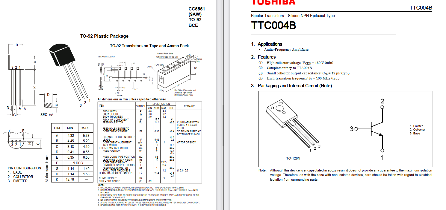

Be careful, NC5551 have different pinout arrangement than the 5551 available on western market.
Maybe you would like to check each one's datasheet.
Keeping under +-40VDC is a safety measure that gives peace of mind, good sound and stay away of troubles. The output power is still enough to drive any modern loudspeaker near 90 dB/1W/ 1m.
Needing more power, better watching at other projects or use bi-amplification IMHO.
While the pin numbering is reversed (1-2-3 left to right vs right to left) I think the actual pinout is the same for TTC004 and NC5551 (see attached).

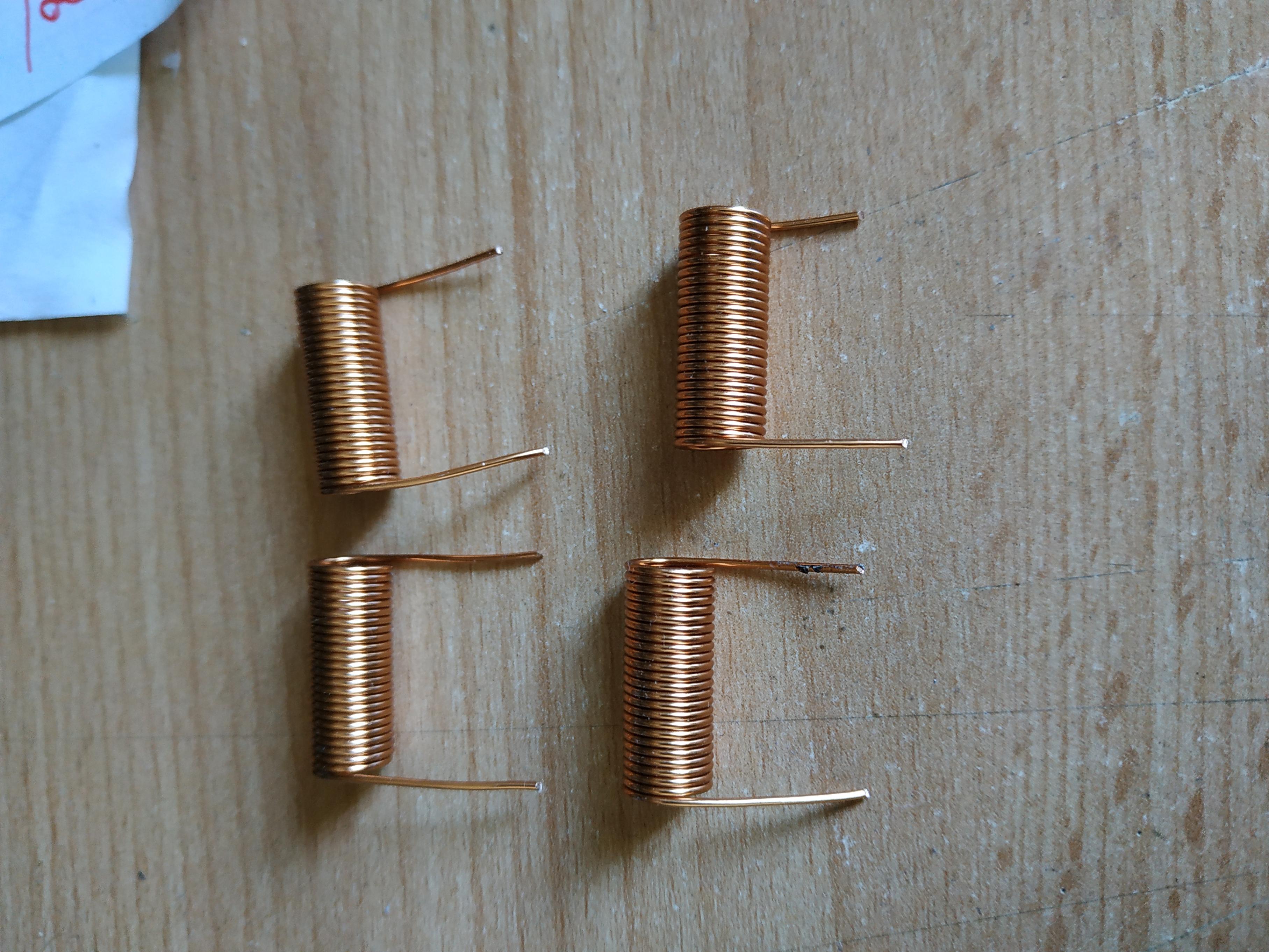

I don't think I am dealing with oscillations but these boards don't have the output Zobel network. Perhaps I should add them on the output protection relay board.
On the musical fidelity x-a50 (mx50x2 is a clone) there is a 6mm inner diameter 24 turns swg22 inductor parallel with 3r3 1w resistor (inside the inductor).
Mine are stable without but I'll ad it as soon as I receive some resistors.

True, I was wondering if the series inductor (paralleled with a resistor) was needed too.Zoblel network is present on mx50x2 10R + yellow film 100nf cap on your pictures.
I don't know it installed on l7.
Yes.Additional security is never a bad thing.
Your speakers could say thanks some days
I was wondering for safety sake if I should just wire a series inductor (with parallel resistor) in the leads for my test speakers. Maybe with the shunt RC too. My test speakers are pretty nice and with all of the switching and testing of new boards (with limited or no protection built into the boards as they arrive) maybe it would be wise.
I don't think the length of speaker wire between the amplifier and before the inductor (and parallel resistor) would be a problem. Right?

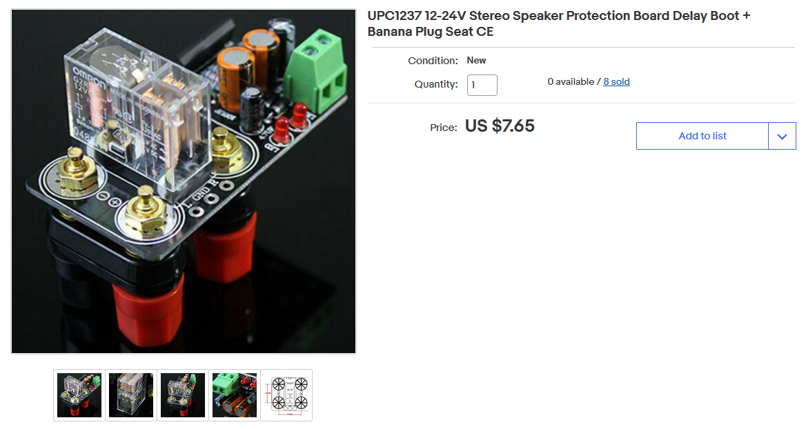

I bought one too (black) but I found that it protects for only positive offsets and not negative. I traced the schematic and found that pins one and two were mixed up in the layout of the board. The seller was no help and continues to sell the board.I use cheap Chinese upc1237 speaker protection boards supplied by a 12vac transformer in all my amplifier except for class d.

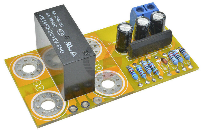

I later bought yellow ones which are pretty much identical but the pins are not mixed up. I have enclosed a picture of the yellow one that I use now. It fits the cut outs at the back of the used/defunct receiver chassis that I am using for the chassis/heat sink (and power supply when the kit can handle the voltage...)
The black one that does not work looks almost identical except the PCB is black. You would never know it does not work properly unless you tested it... ...or your speakers burned up.

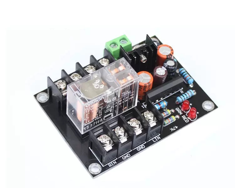

I have enclosed a picture of the black one that I bought that does not work. I found that this black PCB version protects for only positive offsets and not negative. I traced the schematic and found that pins one and two are mixed up in the layout of the board. The seller was no help and continues to sell the board.

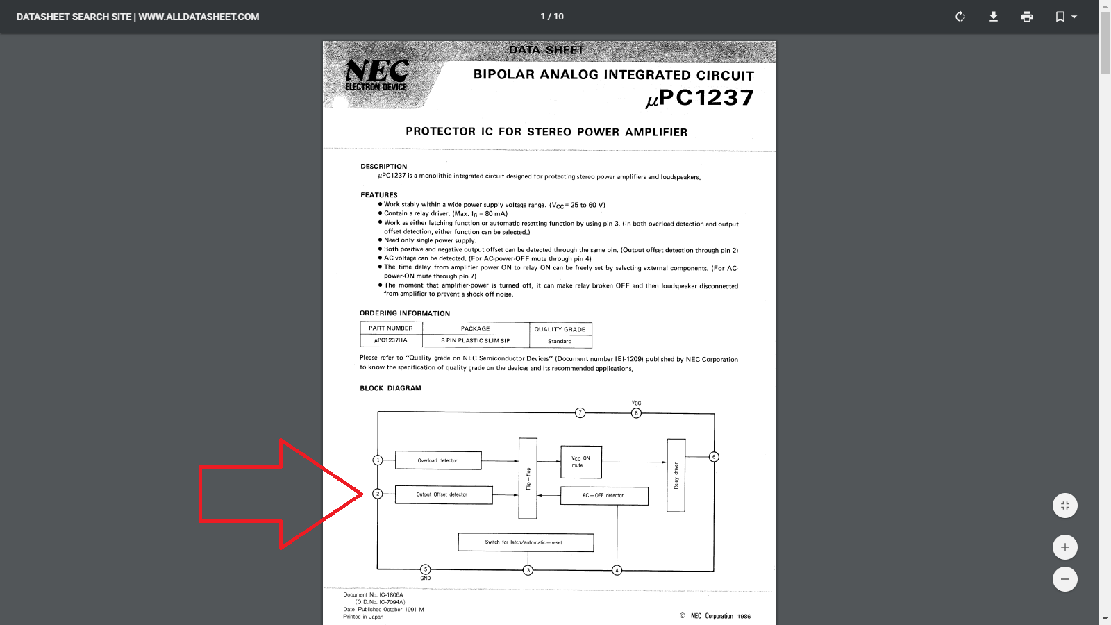

Due to the black solder mask it is a bit hard to see but what you can do is use a volt meter to see if your uPC1237 pin 2 is shorted to ground or not. The ones with the error have pin 2 shorted to ground in the layout and the offset detection network/input is connected to pin 1 instead. (Which is a mistake and will only trigger on positive offsets.)
It looks like lots of people have bought this from lots of different named seller accounts. I would suggest that owners of black PCB versions like this should test the negative offset (not just positive) to see if their PCB has the error or not.

That is a different black board, not the one I bought. I just posted a picture of the one with the problem.
EDIT // I hope we get a reply from ljm_ljm on biasing current for mx50x2...

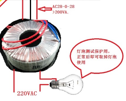

You can connect a light bulb in series with 220 v.
It's easy.
As long as the light bulb is not very bright. The DC voltage of out GND is less than 50mV DC.
Listen to the sound again.
no problem. Remove the bulb.
If there's a problem, the bulb stays on. And it can avoid damaging transistors.
