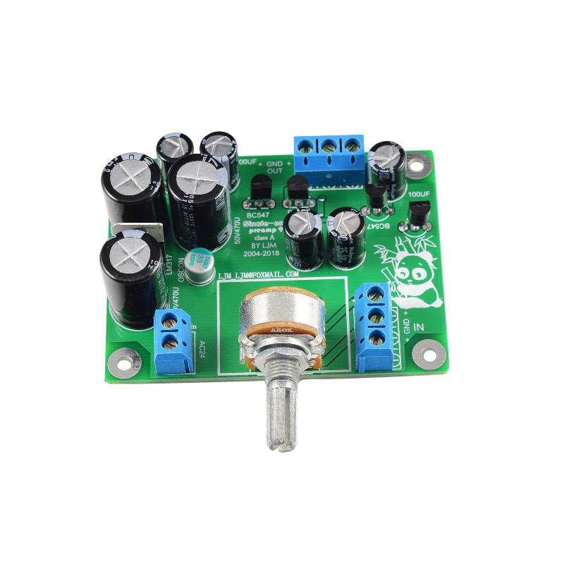

And yes, the PSU usually is a bottleneck in almost hard. Commercial or not. More diyers do not want to spend more money in the PSU. An even more resounding error in those who are class A amp/preamp.
LJM L20.5 + preamp with H2 predominance would be a very good idea I think.
You have this: CLASS A Single-ended Preamp 9
555918d1466493872-class-single-preamp-9-a-tb2sau2qxxxxxcjxpxxxxxxxxxx_-36508936-jpg
and the new design:
NEW Preamp Board Pure Class A Single Ended Transistor Preamplifier 20Hz-20KHz | eBay
By the way, you have new logo in the 2018 boards.
PD: the preamp with better potentiometer... And L20.5 amplifier board with heatsinks like L12.2

This is related to personal preferences. PREAMP9 is a relatively good amplifier.
But I suggest PREAMP9 installed in a separate case. And away from the interference of transformer.
Single-ended amplifier are easy to be interference.

B: yes. I have a new LOGO. Is the panda.
Because I live in chengdu, sichuan province. Here is the hometown of panda.
L20.5 has two versions, the earliest version of power tube after installation is wide. There are about 9 cm.
Then I reduced the width, only 7 cm. In addition to this point. Voice and no difference.
7 cm, is for the sake of easy to install in ordinary aluminum chassis.
