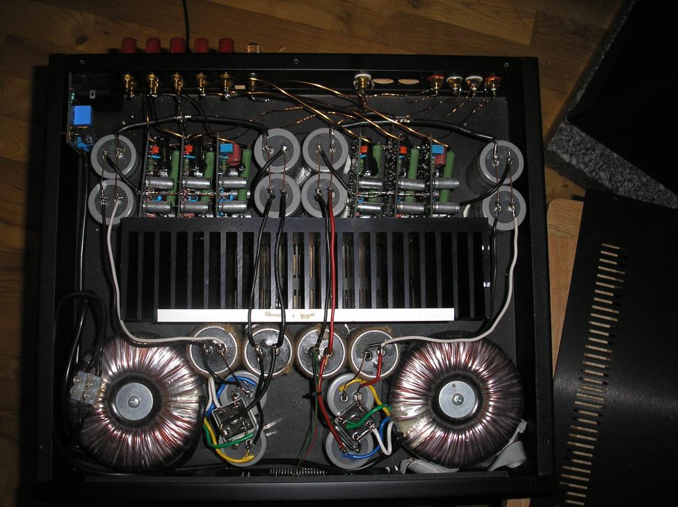

Your built is very beautiful, are the L7s parallelled or bridged?
Not bridged. Meant to triple amping with digital filters.Your built is very beautiful, are the L7s parallelled or bridged?
Is that for a 5.1 HT system?
What is the previous stage?

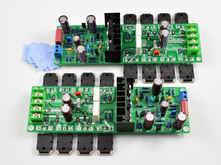

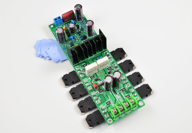

L20.5 by LJM Low THD Amp
L20.5 sound accurate, low distortion, it is suit HIEND representative products.
Whether level before use, all can be very good.
Designed by suit the L series 200 w power amplifier, the use of special CFP output, as well as COSCODE input stage.
Each channel 4 on imported from KEC KTB817 KTD1047 power tube.
Ultra-low distortion circuit, HIEND design standards.
8 r output power 200 w, 200 w + 4 r - 63 - v power supply.
8 r 125 w, 125 w 4 r + - 50 v power supply.
4 r 250 w, 250 w 2 r + - 50 v power supply
Maximum output current 15 a and maximum voltage sine wave output v. + - 63 (+ - 65 v power supply)
The static current 20 ma per channel
Static power * 0.02 = the power supply voltage (2 w + - 50 v)
Power Supply Voltage range Power Supply Voltage: 24 v to 65 v + - + -
Recommendation: the power supply voltage and the radiator
+ - 35 to + -50 v, radiator 0.5 KG per channel
+ 40-60 v, radiator per channel 1 kg
GAIN GAIN = 31 times

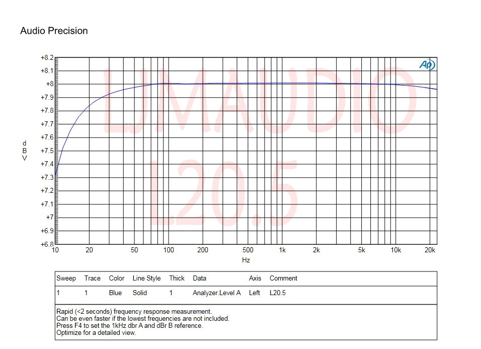

Frequency response = 20 to 25 k HZ to 0.15 DB. 10 HZ = 0.7 DB HZ 20 k = 0.05 DB

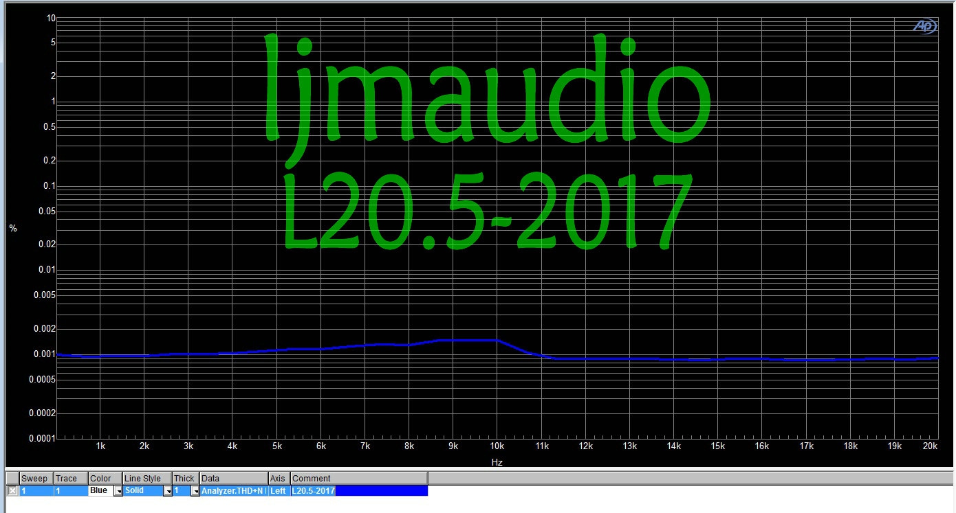

THD+N FREQUENCY(+ -35V DC POWER)
THD =0.0015%
IMD intermodulation distortion test = 0.002 (50 w output power 8 R)
THD+N 失真图
THD+N= 0.001-0.002% 20HZ-20KHZ The output power of 10 w 8 ohm load
THD+N=0.001% A weighting

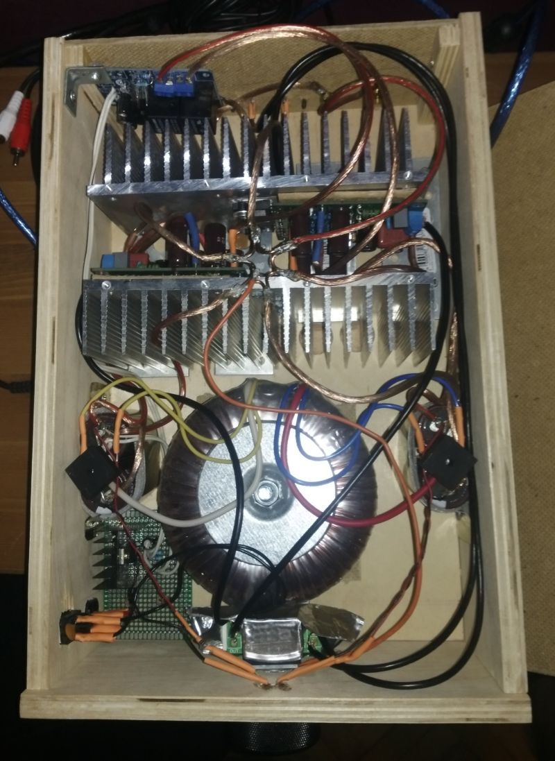

Hi
I have finished my amp based on this kit.
The parts I used:
- kit containing 2 pcbs and all parts soldered by myself
- 2 of large aluminium heatsinks
- 200W transformer 220/4*25V
- 4 of capacitors 10000u*50V
- 2 of rectifiers KBPC1010
- speaker protection board kit soldered by myself
- ALPS 27 potentiometer (not fake I hope)
- large 44mm knob
- input and speaker terminals
- some speaker wire
- some microphone wire
- power socket and switch
- 2 little leds with resistors
- plywood cabinet, handmade
Finally, it was worth it. The sound is so clear and so nice that I decided to send to retire my Sony reciever that served to me for 10 years. Goodbye, Sony )
PS: while writing it, I realized my error: I shoud use 2*50AC power. Although, then I should buy other filter capasitors for 80V or 100V (50V ones was on hand). Yet, I like the result. Maybe, one time I make another amp, using right transformer, right cabinet, and add some new features. Likely, it will be another L7.
