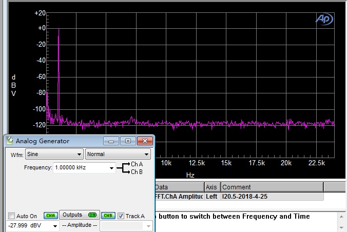

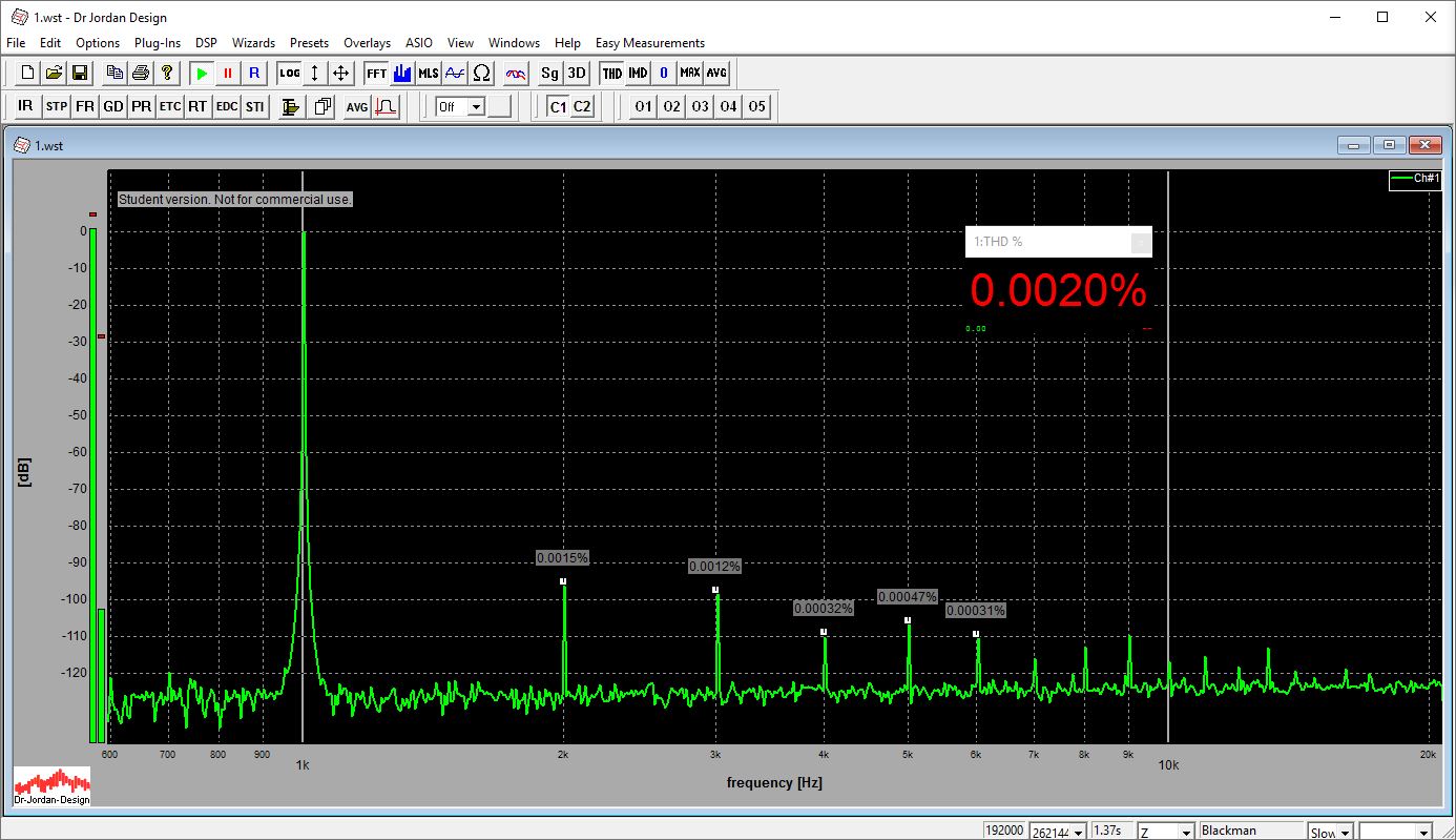

Do you want to see a FFT test figure is.
When I find time to test.

Your photos, not my test. Maybe is a test of other people do.
But I can take time measure FFT.
They was made by vzaichenko.
I think is more important to know the harmonic profile. Systems with H2 predominant sound different than H3 predominant. More "natural", "credible" vs detailed.
I had a time measurement.

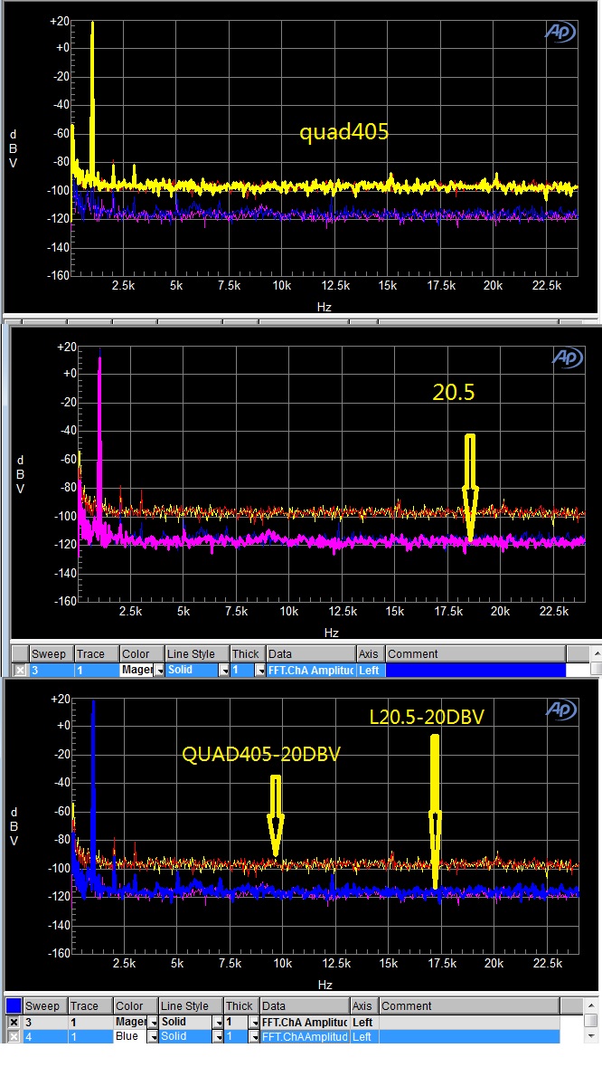

15 db is 0 db 18 db, respectively. Detail please look at the pictures. I didn't also too.
And I save the past QUAD405 FFT on the same tests were compared.
You can see the size of the distortion.
In addition. SNR main relationship and transformer, filter capacitor has much to do.
I am very, very poor capacitor tested. 80 v1000 UF * 4.
If you use a better filter capacitor, capacitor. There will be a better noise ratio.
So the numerical only used as a reference.
Very good graph in a class AB poweramp.

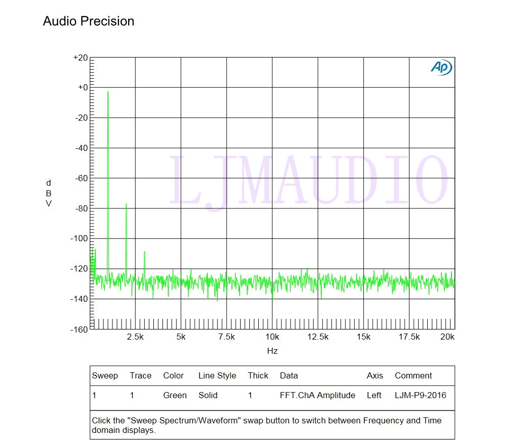

LJM L20.5 + preamp with H2 predominance would be a very good idea I think.
You have this: CLASS A Single-ended Preamp 9
and the new design:
NEW Preamp Board Pure Class A Single Ended Transistor Preamplifier 20Hz-20KHz | eBay

In fact L20.5 amplifier distortion can be reduced by 30%.
You should know. L20.5 GAIN is 31, it may not need a preamp, and get a sufficient volume, at least 30 square meters of space.
If reduce the GAIN of 18. The THD + N can reduce at least 30%.
Only need to put 330 ohm resistance, to 510 ohms. An increase in the number of feedback. Is to reduce the distortion and noise is proportional.
Is estimated to be about 0.0008%.
If you use the preamp, consider such operations.
