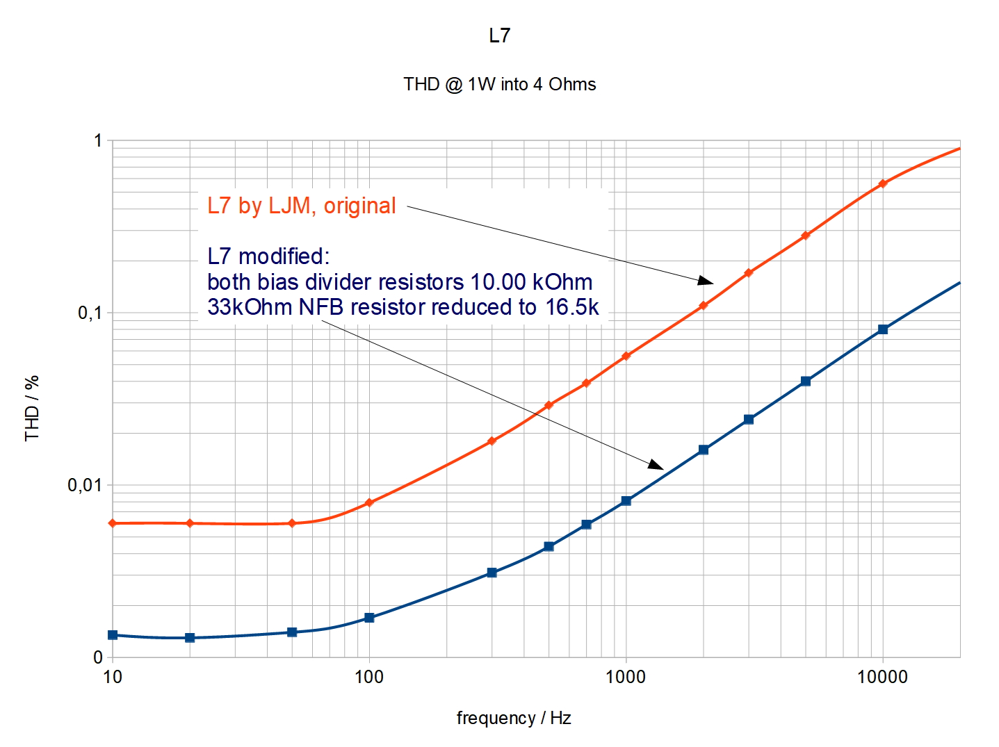

...I noticed what must be crossover distortion on one of the L7 boards. Sound is not clean when played on a really low volume.
I observed the same with all of my 4 boards of the L7 at low output signal (@ 1W into 4 Ohms or less). I am using +/- 42V supply voltage.
THD decreases with increasing output power and/or increasing idle current, indicating crossover distortion as the predominant cause.
Above 1kHz THD is rapidly increasing to relatively high 0.2-0.3% at 20 kHz if the amp output power is 1W or less. This is actually too much for a decent design. Also IM-distortion is high at low output power. When the output power is increased, both, THD and IM decrease. The distortion at low output level is particularly strong for the frequency range between1 kHz and 20kHz, barely detectible for frequencies of 1 kHz and less.
The bias divider resistors are 9.1k/10k. In the early series the divider pair was 10k/11k instead. Care must be taken not to swap them, because then idle current goes through the roof and the amp says good bye with fire and smoke (unless prevented by proper fuses in the rail voltage lines, strongly recommended). Small changes in the resistor values have huge effect on the bias current here, therefore I do not recommend a trim-pot for bias adjustment here. I guess, That's why also LJM put fixed resistors instead.
I figured out, that with the bias divider 9.1k/10k the heat sink remains pretty cool, LTSpice simulation indicates a very low idle current of few milliamps at best and shows crossover distortions in the >10kHz sinus output. THD for 10kHz at 1W into 4 Ohms was about 0.2-0.3% while for 1 kHz it was 0.1%.
I increased the 9.1k bias divider resistor to 10k (to exactly the same value as the 2nd bias divider resistor) carefully matching both to less than <1% difference. This resulted in about 30mA idle current through each of the power-MOSFETs and gentle warming of the heat sink (without load).
Additionally, I increased NFB by reducing the 33k NFB resistor to half (16.5 kOhms) - by adding a 2nd 33k in parallel. This cuts the amplifier gain in half, of course. For me, the resulting gain of 14-15 is still more than sufficient.
Both measures together cut THD in half. THD for 10kHz @ 1W into 4 Ohms load went down to <0.1% and at 10W/4 Ohms to about 0.06%. Crossover distortions at low output power are mostly gone. THD is now slightly increasing with increasing output power as one would expect.
At 10W/4Ohm and higher, THD in the 20Hz-1 kHz frequency range remains < 0,01%. For 8 Ohms load it's even better.
Another approach to reduce crossover distortion is matching the MOSFET power transistors. I noticed that for one of my four L7 amp modules, THD was considerably smaller (40% less) than for the other three. I didn't measure/match the IRFP240/IRFP9240 pairs (simply used what was in the DIY kits). I assume, that in this "better" module, the match of the MOSFET pair happened to be better by chance.

In the attachment you see the effect of the measures I described above. Actual THD measurements (for 1W into 4 ohm) match the LTSpice simulation results.
orange: L7 by LJM (original configuration with 33k NFB resistor and 9.1k/10k bias divider)
blue: L7 modified (2x33k NFB resistors in parallel and 10k/10k bias divider)

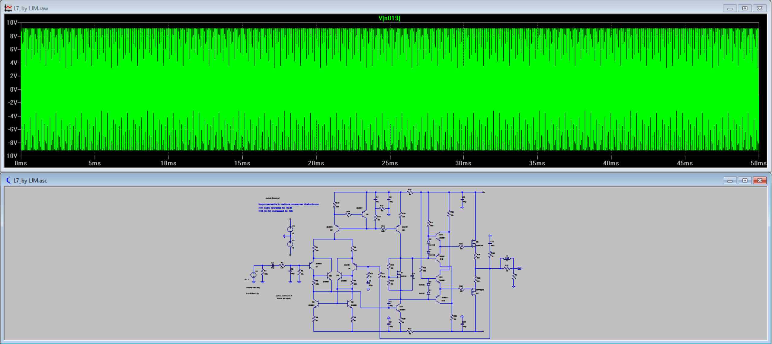

No, not that circuit. That's not how my L7 looks. A bunch of resistors and one capacitor are different and of course, IRF610 as bias transistor.
I got the latest version of L7 and I checked the values in my model against it.
I am attaching the asc file for my circuit and the MOSFET models I used with it (from Ian Hegglun, June 2019) as well as the BJT models I used for 2N5401 and 2N5551. The two 0.01 Ohm resistors were added in the asc. for simulation only in order to monitor idle current.
Regards

My comments were based on (real) THD measurements primarily. The LTSpice model (asc. attached) could reproduce the measured data.
Regards
Reinhard
Pls. replace the .asc by the updated one in my post above.
Are you familiar on how to get to THD in LTSpice?
1. You must first replace the (default) transistor models in your LTSpice library by the models I have attached.
2. Click on V(OUT) in the schematics to obtain the result in the time domain. If in your case node (019) is identical to V(out), that works also.
3. After the simulation in the time domain completed, right click on the window with the (green) sine curve result (it looks like the one you posted). Then a menu pops up. Go to "View..." in that menu and then to "Spice Error Log". Then the Spice Error Log window pops up.
4. In the Spice Error Log window scroll down to the table which lists the Fourier components of V(out). The last line reports the THD.
If you change frequency, you must do that in the .FOUR command as well as in the voltage generator parameter. The file as supplied by me has both at 20 kHz.
You may also want to change input voltage to obtain an output of 1W into 4 Ohm load. The file that I provided generates 9V peak into 4 Ohm, which corresponds to 6,3Vrms that makes 10W into 4 Ohm.

To start with, the asc file i'm using is yours, not mine. So that "green" image comes from your simulation. Forget my simulation.
What is the result I should get? Please run it on your LTSpice and capture the screen.
Second, I'm using your models.txt you enclosed, so the transistor models are yours.
The THD in the error log window is 0.0195%, which is good for 20K.
I didn't change anything. I'm running it as you sent it. The screen I get is from Vout.

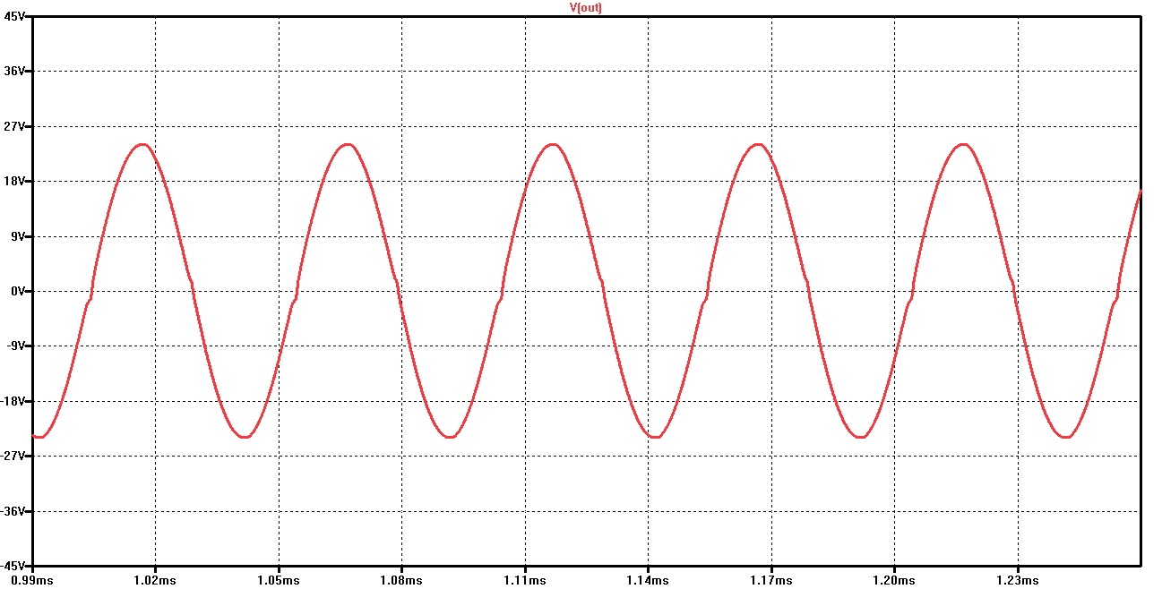

You can also detect the crossover distortion in the (Cordell based) "L7" file that you have (the one you posted). Although that's not exactly L7, it shows the same characteristic high crossover distortions.
Check sine output for 20 kHz and zoom in.
You can easily spot it, even for high output in your simulation file THD = 1.3% at 20 kHz for 35W into 8 Ohm load. I used your file and here is the result.
