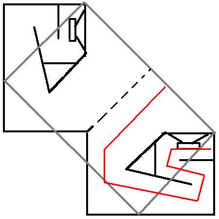

How quickly can you build a 2nd CTH? so you can 90 degree plate them together, and measure? The extra bit of length/mouth area should help your 40hz, as well as eek out another db or two across the board.
Worth a shot -- and it doesn't involve sleepless nights or loss of brain cells to try.... Sounds like the CTH is just about there in terms of doing what you need.
Here's my thinking... I measured 102.5 @40hz 1M 2.83v with a single cabinet. I measured 114@40hz 10M 20v. So, I gained either directivity, or mutual coupling, to account for my additional gains with 4 cabinets. Usually doubling direct radiator cabinets, never quite gets to the 6db expected... In my case, I was getting 2.5 db above and beyond 6db per doubling of cabinets. I'm thinking that when you build the 2nd - 6th.. you'll be happier than just the tests of a single cabinet show. (The attached pic is how I had the cabinets set, when I measured 114)
I never did measure the plate trick on my TH, so I can't give you any numbers, but I believe it'll help. I know when I was testing my T36 without the covers on, that a plate on top (so I was getting horn loading from the open chambers) helped ALOT. Actually it was that test, that led me to try TH....

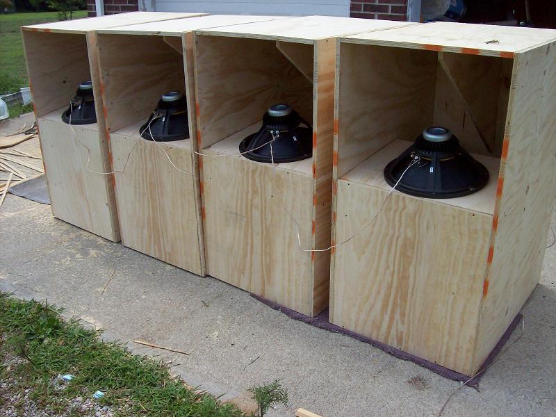

New Version prototype started today. Templates done.
It got a little bigger to 40x25.5x31.5. The horn path got 14 cm longer and the driver is repositioned. I revised the ramp scheme after looking at some duct dynamics info on the web. The tapers have been tweaked and are going back in for the first stages. Should have it tested in about two days. Third time's a charm I hope.
You have to be aware that TH115 has a horn length of around 270cm (9ft). You must have a horn of approximate length to achieve strong response down to 40Hz.
Looking at your scheme i can see that you are missing one more fold in the first part of the horn.
MarjanM said:You have to be aware that TH115 has a horn length of around 270cm (9ft). You must have a horn of approximate length to achieve strong response down to 40Hz.
Hmm. That's good to know. Thank you.
I'm trying to balance the upper end response as well to meet up with BFM OT12's (modified). I've tried adding another fold but the response above 95hz is not any better than a direct radiator.
The slightly shorter tapered box had very nice usable upper end vs the longer extra fold boxes...all 20 or so of them I tried. Getting a box to play to 40 from 80hz and below isn't that hard, but you need 15" 3way tops to go with them especially in arrays..
I cannot build 10 replacement tops for a while so these will have to serve for now. This would give me more time to learn Akbak and other knowledge to design a better one. Lots of people have Omnitops so the final box won't be a waste.
I'm going for a compromise to 42-45hz with a 260cm path with smooth tapers and no 180 degree bends, 103db average at 1w1m equal to a double 18 bin. That box is bigger than it looks. Without a sense of Master Tom's method of maintaining upper end response, I know I'll be very lucky if I can match the UCS1.

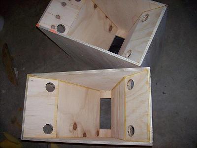

Two CTH1524s variations got built today. Both at 269cm but different internal arrangements. The first one failed, it went lower but lost high end and level. I don't have high hopes for the other either. I'll try it tomorrow and possibly put the original one back together adding 10 cm to it.
