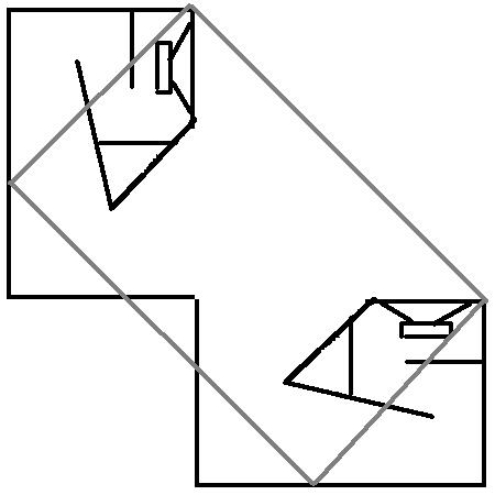

I think the CTH1524 box is done. I like the sound of it even though it's not as heavy sounding as I'd hoped.
Last thing is to try some different baffles on the driver to interface it to the horn mouth better in the cone facing into the mouth position. I'm hoping to get that db or so that's lost below 55hz in that position by incorporating some of the unity horn concepts.
I really don't want to lose the upper range articulation and clarity that sounds fantastic for blues/R&B bass guitar.

Any Improvements Please.
Well after probably 30 tries. I give up.
I've tried chambers, compression, bigger, smaller, tapered and simple. I can't seem to get a decent size fairly easy to build box to put out 103 from 45-125 or so at 1w 1m.
Here is the link to the CTH1524 in it's simplest form that I will reluctantly have to build unless some kind soul has any suggestions other than buy a Danley. If I could I would.
I need to carry six of them max but will probably use 4 most of the time.

Does it work for you, to design like Klipsch? (use existing boundaries to increase the size of your cabinet, like K-horn) Build tall scoop looking cabinet and plate a pair of cabinets at about 60-90 degrees? or when doing 6, having groups of 3 of them floor firing at 30 degrees? I'm assuming for most shows, set up space is not the limiting factor.
That would get you the length and mouth area for the spl you need, while still having something transportable.
I'll noodle around with construction ideas, and if I find something of interest, I'll post it. (something like the attached sketch, using 2" hook and loop to join the cabinets on setup) I realize that 90 degree's doesn't get you alot of extra length. But a 24x24x48 cabinet at 60 degrees has some interesting possibilities.
off hand question, are you testing with a C-weighted spl meter, and are you converting your measurements to flat?
