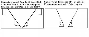

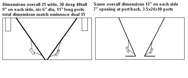

YOU ARE NOT GOING TO LIKE THIS
After more than 30 cabinets and months of every possible minute,
countless sleepless nights, 6 lbs lost, and a decimated pile of wood, I have reached the following conclusion:
A DIY low spl 20-80 or 40-100hz Tapped horn sub for home use is
fairly easy to come up with help from hornresp. They sound good too.
A DIY TH under 40x30x24, with an average output from 42hz to 120hz at 103 db +-2 db that is equal to two direct radiators, that is portable enough to fit 4 in a van with everything else for high spl pro sound use.....is not possible. Unless you are Tom Danley.
The closest I came was 102.5db average but poor response below 50hz equal to the direct radiator. That cabinet had a ton of angles and tapering parts pieced together by hand such that it would be next to impossible to turn out 6 properly built cabinets with decent hand tools. To make matters worse there was a lot of instinctual work in it making it impossible to re-model the built box in horn resp. The top end was really nice and it certainly sent my only titan to the scrap heap (along with every shred of BFM paperwork).
Sorry Folks.
Anyone got a really good double 15 box plan???
Maybe one of those angled jobs with the drivers facing each other.

My new box design has no ports.
Phase plug.... I have an old cone from a blown kappa. I'll make a mold from that and use a touchy feely approach do dial it in.
I already excluded the phase plug area from the throat when I did the cabinet in horn resp. It won't be too fancy.
It's primary purpose is to get around the compression driver in a nicer way and extend the upper end to above the crossover point.
I have a feeling there may be no point in building them without decent subs.

Besides the Mini clones
I built, I haven't come across a TH design that I want to build. The 2 minis go 50-200 Hz 127-130 db. They are paired with either a 12" or 15" inch 2 way. They sound like a HT sub.
I just posted to see if anyone can come up with
a TH design that is single cab. 135 plus db. 40/42 Hz -150/200. 2Pi
Should be interesting if anyone takes up the challenge.

As i have said. You have to put another fold in the first section of the horn and loose that unused space. In your design the area behind the driver is acting as a chamber and your horn starts almost a feet later. There is a reason why Tom placed the driver with the magnet facing to the out side.
Look at the picture here to understand better what i am saying.

Thanks MarJan
I sort of gathered that. I eliminated the wasted space and added another fold and wound up with a below 80 only sub
and the associated gain loss. These would sound awesome with my old Apogee SX3's but I can't lift em!
I did recalculate everything in Hornresp first. Above 80 it was useless i.e. absoultely zero gain over a direct radiator.
That's where the battle is. Getting gain above 80hz without losing bass. I managed to get pretty close once.
I also realized you need at least a pair per side.
