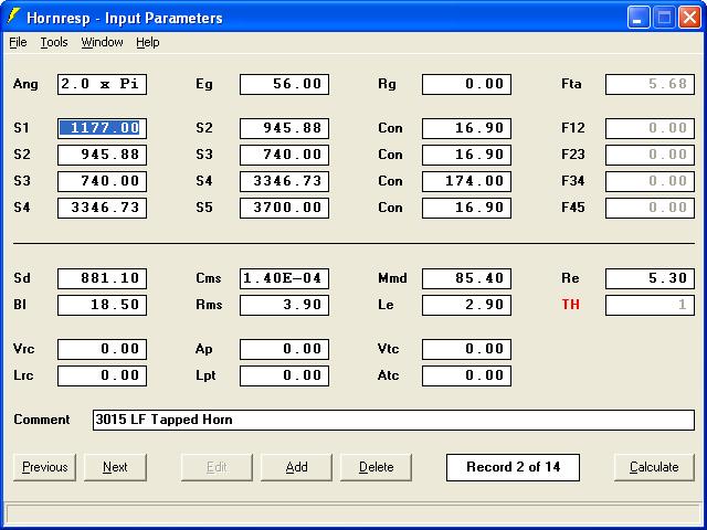

Screamer: Good to hear it's coming on well. I imagine it will work ever better with 4015's...
I have 4 x 4012 drivers, I was wondering if they would work also (and how well they would work)? They have less cone surface area (SD), but the rest of the specs are pretty similar to the 4015.
I couldn't find any Hornresp screenies in this thread, otherwise I would've tried simming it myself.

CTH1524 data to play with
Here is the CTH1524 to play with.
CTH1524 translates to, Convertable Tapped Horn, 15" driver, 24" interior width. Convertable because you can mount the driver either way altering the mid bass articulation, or simply to save 80 bucks or more on a fancy grille.
REMEMBER this is the best compromise PORTABLE cabinet I could come up with for LIVE MOBILE USE at this time. It's easy to make it go lower or louder but forget about moving and packing 4 of them. The sims show 102.5 db avg. The prototype tested higher.
If anyone can make it smaller and still keep about 102-3db that would be awesome. A pair of them rattled a large concrete building over 500 feet away, 90 degrees from the cabs and on the otherside of another building.
Here's Akback and then a manual horn response export
I added both the 3015 and 4015 drivers to the manual Hornresp export at the bottom. Have fun. I've already beat it to death.

HERE IS THE EASY VERSION
CTH1524 Manual export for horn resp
Cabinet 40x30x24
S1 619.00
S2 729.47
S3 2046.00
S4 2476.59
S5 3019.00
L12 con 20.9
L23 con 178.9
L34 con 21.0
L45 con 24.0
3015 driver
SD 881
BL 18.6
CMS 1.40E-04
RMS 3.90
MMD 85.4
LE 4.90 (with coil)
RE 5.30
4015 Driver
SD 872.9
BL 18.50
CMS 1.06E-04
RMS 6.73
MMD 120.65
LE 5.40
re 5.40
IF you want to make it sound more ballsy, lower the mid bass slightly on your eq 70-90 and it will seem to have stronger low end. It's nice to have the ability to tweak the mid bass instead of trying to crank 40hz on a normal cabinet or folded horn.
You will see that the 4015 already has a 2-3 db dip in that region over the coil equipped 3015 which looks flat as a pancake.
I compared it to another proven DIY STD Horn box. The other box was louder at 1w, but the CTH beat it hands down at combat levels. Especially on the bottom end. Don't ask whose box, out of respect I won't tell.
I really like the angry sound these things make similar to a large bank of double 18's screaming away....but smaller. Should make those local band shows more exciting and hopefully help me make enough cash to buy 6 danleys in a couple of years.

Actually if you could get a 3015lf to do 130db from 40-100hz in a 400liter cabinet.. that'd work.
I've tried for hours to sim a cabinet that can do that... it just comes up short every time. 102-103db from 40-100 2pi 1W/1M is easy... anything above that, seems next to impossible.
BTW, this is the best I've been able to come up with for that driver.
http://www.danleysoundlabs.com/pdf/TH 115 Spec Sheet.PDF

The CTH may hit your 130db mark. It was hitting 126 without enough power to really drive it. We'll see.
Actually 103 db from 38-120 was the goal.
The 3015 neo won't do it, more like 42-115 as you can see from the horn resp data I posted. I can get it to my goal but it's a 5 foot box! The CTH is quite acceptable for an uncompressed DIY box. The box has to be smaller than 42x30x26. The CTH is actually 39h x 25.5w x 30d outside dimensions.
